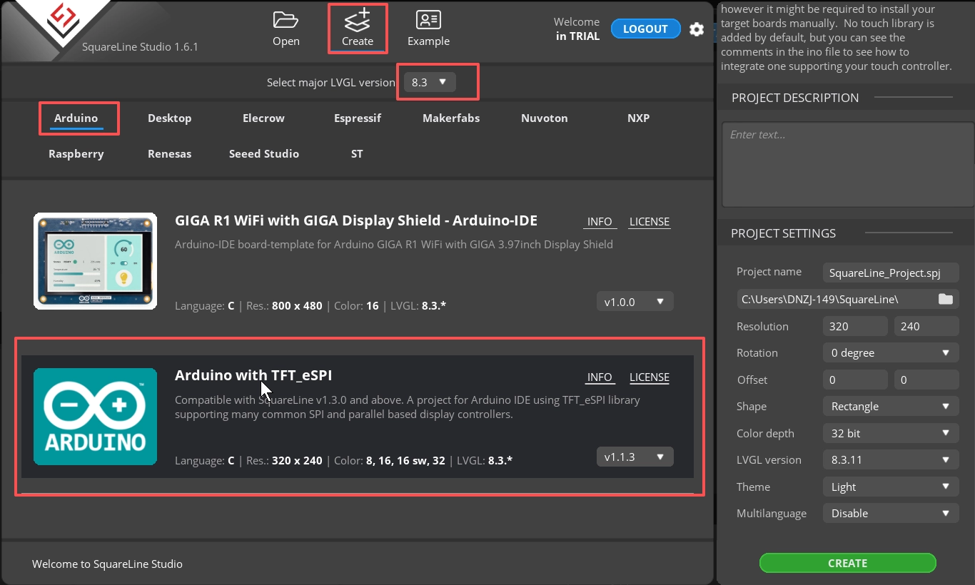

  1. Open the SquareLine Studio and create a project. Select "Arduino"->"Arduino with TFT_eSPI".
    3
    Note:
    When select the Arduino framwork, there's only one option "Arduino with TFT_eSPI". By choosing this, the squareline studio will generate a template code suitable for the TFT_eSPI library. However, squareline studio not only supports the TFT_eSPI library, it supports a variety of libraries to suit different hardware and application needs. For example, Adafruit_GFX library, LovyanGFX etc.

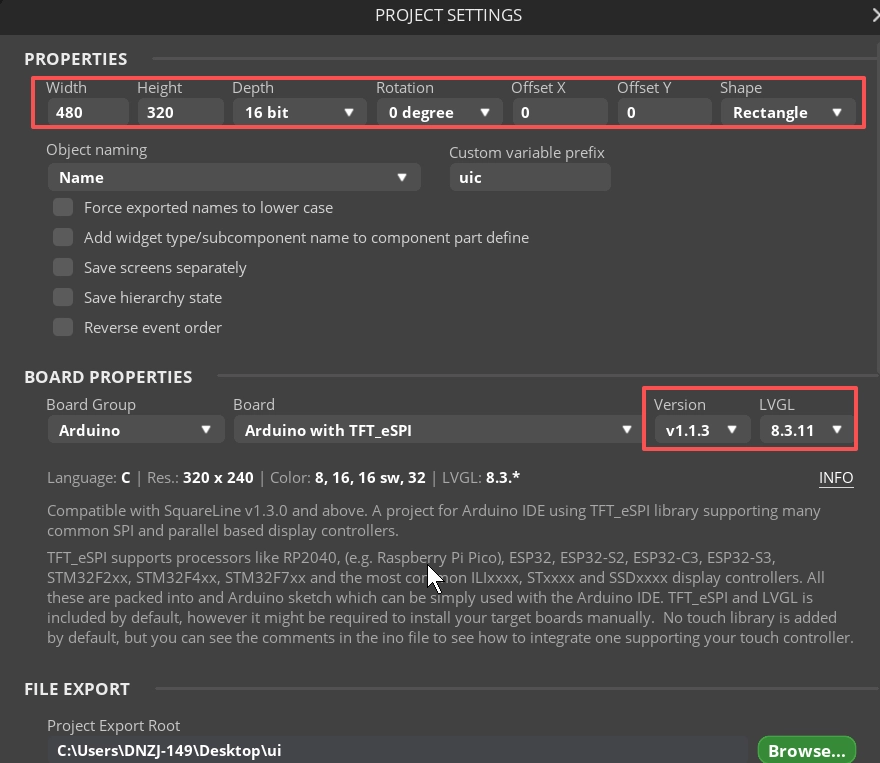

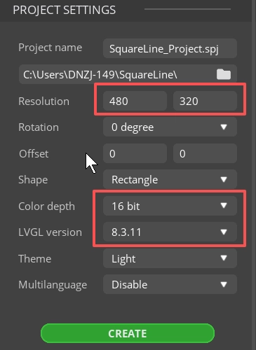

  2. Set the name of the project, set the screen resolution to 320*240, set the color depth to 16bit, and keep other default settings. After setting, click CREATE to create the project.
    4

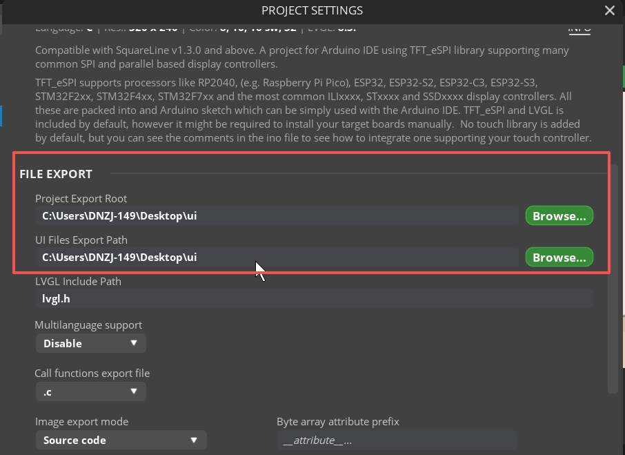

  9. Export UI files.
    SLS-UI-25
    5
    6
Then click "APPLY CHANGES".

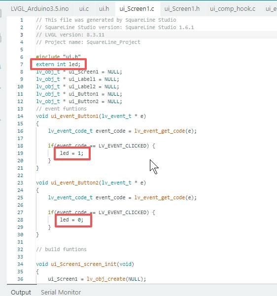

  1. Modify the button event code.
    SLS-UI-31
    First, define an extern variable in the ui_Screen1.c file to store the status of the LED. In the main program, the LED light is controlled to turn on and off by judging the status of this variable.Then replace the function calls inside the Button1 and Button2 functions with the functions for turning the LED on and turning the LED off.

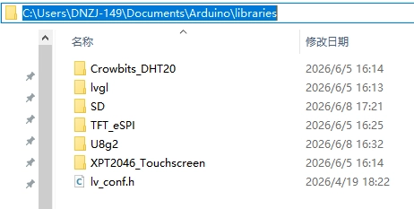

Please click download to download the libraries we modified.
SLS-UI-36
2
Copy the library you downloaded into this directory/path.

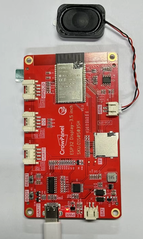

Example3: Speaker
Plug the speaker into SPK port. 8 Upload the following code to the board.

  dac_output_enable(DAC_CHANNEL_2);
// 256-point 8-bit sine wave lookup table (value range 0-255)
const uint8_t sineWave[256] = {
  128, 131, 134, 137, 140, 143, 146, 149, 152, 155, 158, 161, 164, 167, 170, 173,
  176, 179, 182, 185, 187, 190, 193, 195, 198, 201, 203, 206, 208, 210, 213, 215,
  217, 219, 222, 224, 226, 228, 230, 231, 233, 235, 236, 238, 240, 241, 242, 244,
  245, 246, 247, 248, 249, 250, 251, 251, 252, 253, 253, 254, 254, 254, 254, 254,
  255, 254, 254, 254, 254, 254, 253, 253, 252, 251, 251, 250, 249, 248, 247, 246,
  245, 244, 242, 241, 240, 238, 236, 235, 233, 231, 230, 228, 226, 224, 222, 219,
  217, 215, 213, 210, 208, 206, 203, 201, 198, 195, 193, 190, 187, 185, 182, 179,
  176, 173, 170, 167, 164, 161, 158, 155, 152, 149, 146, 143, 140, 137, 134, 131,
  128, 124, 121, 118, 115, 112, 109, 106, 103, 100,  97,  94,  91,  88,  85,  82,
   79,  76,  73,  70,  68,  65,  62,  60,  57,  54,  52,  49,  47,  45,  42,  40,
   38,  36,  33,  31,  29,  27,  25,  24,  22,  20,  19,  17,  15,  14,  13,  11,
   10,   9,   8,   7,   6,   5,   4,   4,   3,   2,   2,   1,   1,   1,   1,   1,
    1,   1,   1,   1,   1,   1,   2,   2,   3,   4,   4,   5,   6,   7,   8,   9,
   10,  11,  13,  14,  15,  17,  19,  20,  22,  24,  25,  27,  29,  31,  33,  36,
   38,  40,  42,  45,  47,  49,  52,  54,  57,  60,  62,  65,  68,  70,  73,  76,
   79,  82,  85,  88,  91,  94,  97, 100, 103, 106, 109, 112, 115, 118, 121, 124
void playSineWave(int frequency, int durationMs) {
  int sampleRate = frequency * 256;          // 256 samples per cycle
  int totalSamples = (sampleRate * durationMs) / 1000;
  int delayUs = 1000000 / sampleRate;        // Interval between samples (microseconds)
  for (int i = 0; i < totalSamples; i++) {
    dac_output_voltage(DAC_CHANNEL_2, sineWave[i % 256]);
    delayMicroseconds(delayUs);
  dac_output_voltage(DAC_CHANNEL_2, 128);    // Return to mid-level (silence)
void loop() {
  playSineWave(1000, 1000);  // Play 1kHz sine wave for 1 second
  delay(2000);

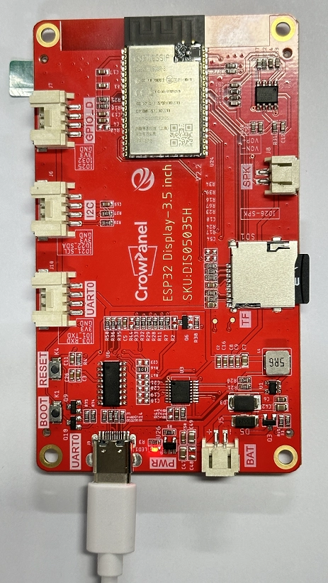

Example4: Initialize SD Card slot
Please insert an SD card formatted as FAT16 or FAT32. Other file system formats may fail to be read.
9
#include <Wire.h>
#include <SPI.h>
#include <SD.h>
#include <FS.h>
#define SD_MOSI 23
#define SD_MISO 19
#define SD_SCK 18
#define SD_CS 5
void setup() {
  Serial.begin( 9600 );
  SPI.begin(SD_SCK, SD_MISO, SD_MOSI);
  delay(100);
  if (SD_init() == 1)
    Serial.println("Card Mount Failed");
  else
    Serial.println("initialize SD Card successfully");
void loop() {
int SD_init()
  if (!SD.begin(SD_CS))
    return 1;
  uint8_t cardType = SD.cardType();
  if (cardType == CARD_NONE)
    Serial.println("No TF card attached");
    return 1;
  uint64_t cardSize = SD.cardSize() / (1024 * 1024);
  Serial.printf("TF Card Size: %lluMB\n", cardSize);
  listDir(SD, "/", 2);
  //  listDir(SD, "/", 0);
  //  createDir(SD, "/mydir");
  //  removeDir(SD, "/mydir");
  //  listDir(SD, "/", 2);
  //  writeFile(SD, "/hello.txt", "Hello ");
  //  appendFile(SD, "/hello.txt", "World!\n");
  //  readFile(SD, "/hello.txt");
  //  Serial.printf("Total space: %lluMB\n", SD.totalBytes() / (1024 * 1024));
  //  Serial.printf("Used space: %lluMB\n", SD.usedBytes() / (1024 * 1024));
  //  Serial.println("SD init over.");
  return 0;
//Traverse the SD card directory
void listDir(fs::FS & fs, const char *dirname, uint8_t levels)
  //  Serial.printf("Listing directory: %s\n", dirname);
  File root = fs.open(dirname);
  if (!root)
    //Serial.println("Failed to open directory");
    return;
  if (!root.isDirectory())
    Serial.println("Not a directory");
    return;
  File file = root.openNextFile();
//  i = 0;
  while (file)
    if (file.isDirectory())
      //      Serial.print("  DIR : ");
      //      Serial.println(file.name());
      if (levels)
        listDir(fs, file.name(), levels - 1);
    else
      Serial.print("FILE: ");
      Serial.print(file.name());
//      lcd.setCursor(0, 2 * i);
//      lcd.printf("FILE:%s", file.name());
      Serial.print("SIZE: ");
      Serial.println(file.size());
//      lcd.setCursor(180, 2 * i);
//      lcd.printf("SIZE:%d", file.size());
//      i += 16;

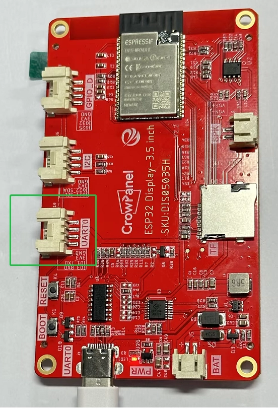

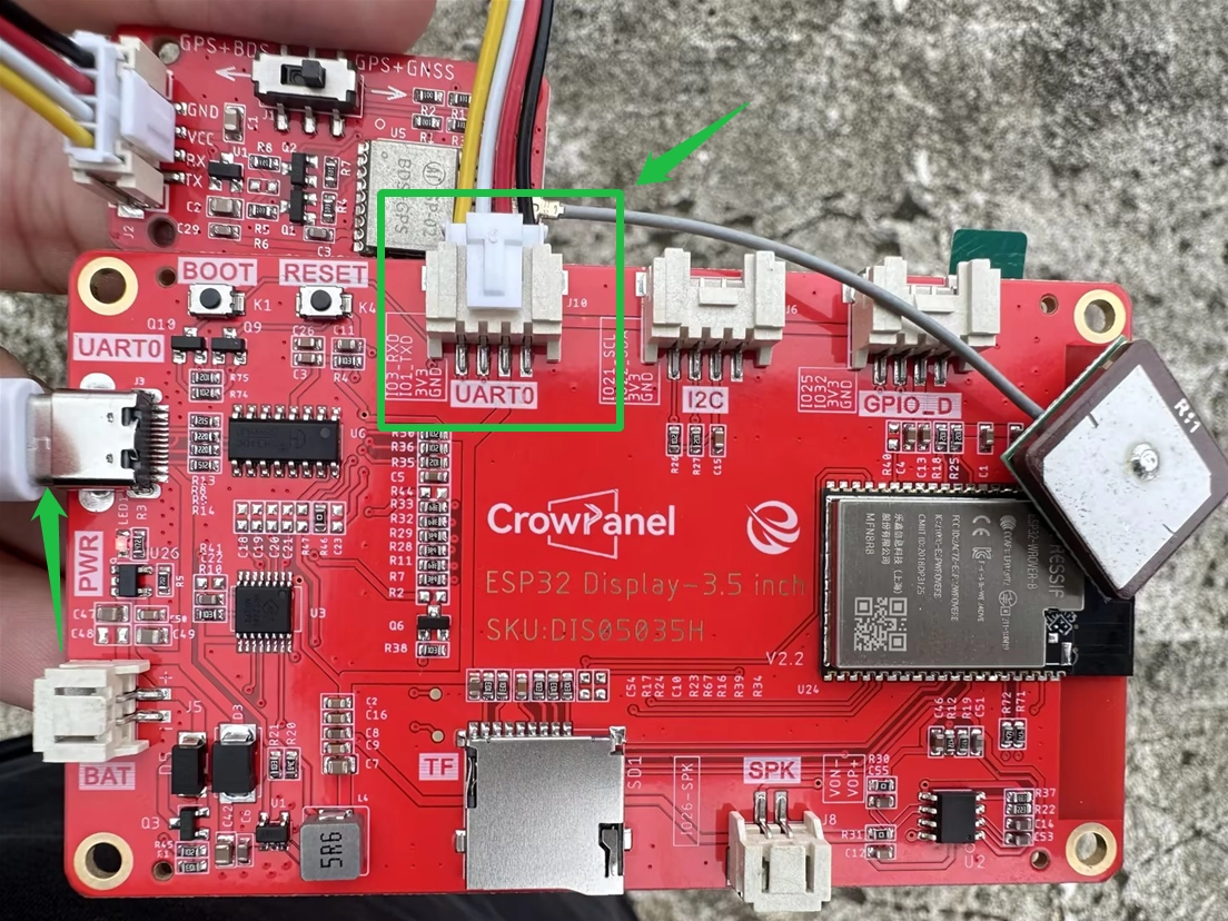

Example8: Connect Crowtail-GPS module via UART to Get Location
Because the USB-to-serial interface shares the same pins as the UART interface, the USB and UART functions cannot be used at the same time. Leave the UART interface disconnected when flashing/uploading the firmware.
10
Once the program has been successfully uploaded, connect the GPS module and reconnect power to the board via the USB port.
11
Note: For best results, choose a location with good weather and an open outdoor environment. This allows the GPS module to receive satellite signals properly, collect data, and display it on the screen.
12
GPS module purchase link:https://www.elecrow.com/crowtailgps-p-1515.html
