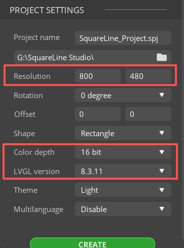

Open the SquareLine Studio and create a project.

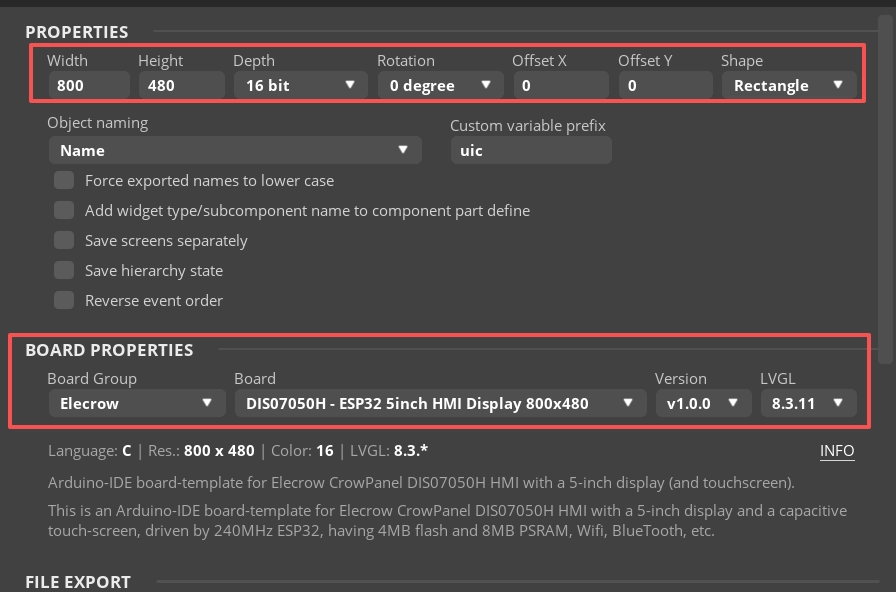

Select "Elecrow"->"DIS07050H...Arduino-IDE"
Set the name of the project, set the screen resolution to 800*480, set the color depth to 16bit, and keep other default settings. After setting, click CREATE to create the project.
Please click

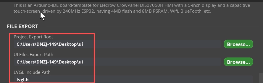

Export UI files.
Then click "APPLY CHANGES".
<font color="blue">Tips: After selecting the flat export, the output files will be in the same folder, so that the output code does not need to modify the path in the program. If not, the output files will be classified and placed in different folders. The compiler may not be able to recognize different paths, which will cause some trouble. In this case, the user needs to modify it manually, so it is recommended to select all files to be output to the same folder.</font>

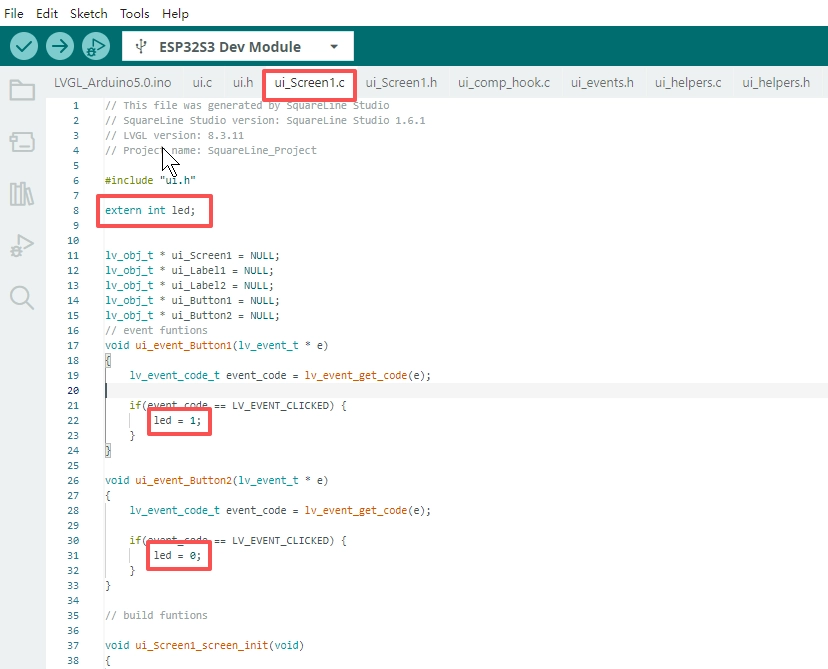

First, define a variable in the ui_Screen1.c file to store the status of the LED. In the main program, the LED light is controlled to turn on and off by judging the status of this variable.
Then replace the function calls inside the Button1 and Button2 functions with the functions for turning the LED on and turning the LED off

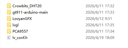

Please click
to download the libraries we modified.

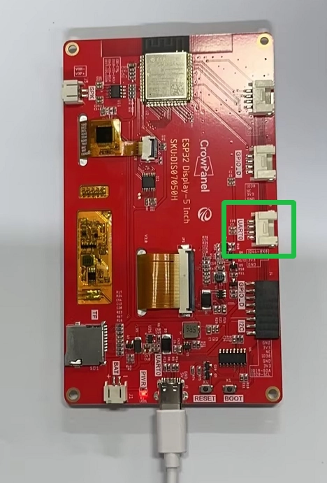

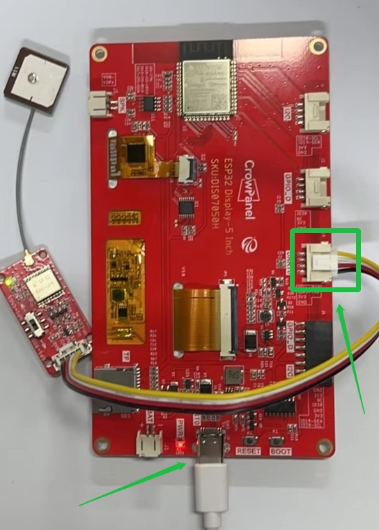

After the program is successfully uploaded, connect the DHT20 sensor to the IIC port and the LED to GPIO_D (IO38), the temperature and humidity values will be displayed on the screen. Click the ON button on the screen and the LED will turn on. Click the OFF button and the LED will turn off.

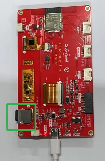

Example3: Initialize SD Card slot¶
Please insert an SD card formatted as FAT16 or FAT32. Other file system formats may fail to be read.

Example7: Connect Crowtail-GPS module via UART to Get Location¶
Because the USB-to-serial interface shares the same pins as the UART interface, the USB and UART functions cannot be used at the same time. Leave the UART interface disconnected when flashing/uploading the firmware.
Once the program has been successfully uploaded, connect the GPS module and reconnect power to the board via the USB port.
Note: For best results, choose a location with good weather and an open outdoor environment. This allows the GPS module to receive satellite signals properly, collect data, and display it on the screen.
GPS module purchase link:https://www.elecrow.com/crowtailgps-p-1515.html

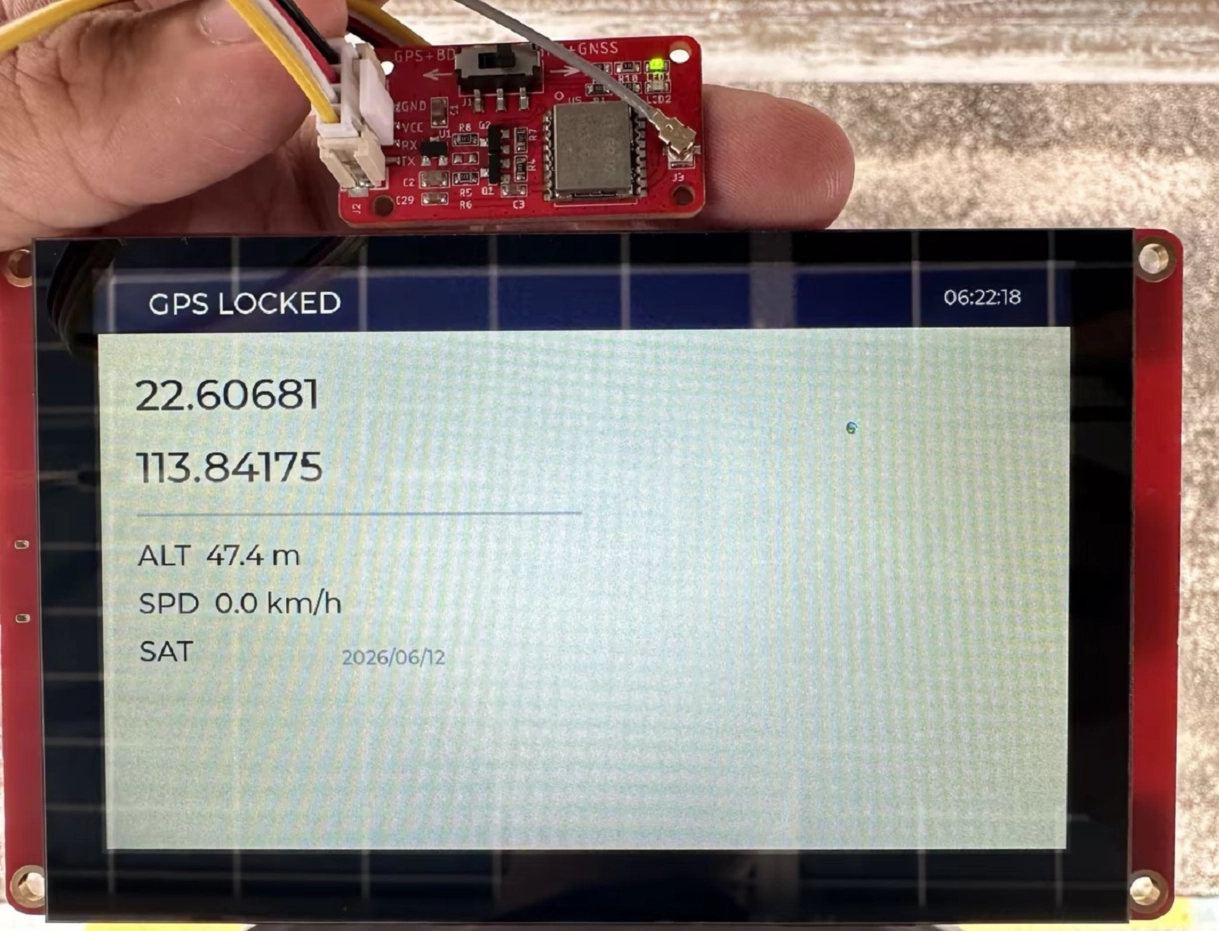

void createGpsUI()
// White background
lv_obj_set_style_bg_color(lv_scr_act(), lv_color_white(), LV_PART_MAIN);
// Status bar (top colored bar)
lv_obj_t* statusBar = lv_obj_create(lv_scr_act());
lv_obj_set_size(statusBar, 800, 50);
lv_obj_align(statusBar, LV_ALIGN_TOP_MID, 0, 0);
lv_obj_set_style_bg_color(statusBar, lv_color_hex(0x1B5E), 0); // Default green
lv_obj_set_style_radius(statusBar, 0, 0);
lv_obj_set_style_border_width(statusBar, 0, 0);
// Status text
labelStatus = lv_label_create(statusBar);
lv_label_set_text(labelStatus, " GPS LOCKED");
lv_obj_set_style_text_color(labelStatus, lv_color_white(), 0);
lv_obj_set_style_text_font(labelStatus, &lv_font_montserrat_24, 0);
lv_obj_align(labelStatus, LV_ALIGN_LEFT_MID, 10, 0);
// Time
labelTime = lv_label_create(statusBar);
lv_label_set_text(labelTime, "--:--:--");
lv_obj_set_style_text_color(labelTime, lv_color_white(), 0);
lv_obj_set_style_text_font(labelTime, &lv_font_montserrat_16, 0);
lv_obj_align(labelTime, LV_ALIGN_RIGHT_MID, -20, 0);
// === Not positioned: large text prompt ===
labelSat = lv_label_create(lv_scr_act());
lv_label_set_text(labelSat, "Acquiring...");
lv_obj_set_style_text_color(labelSat, lv_color_hex(0xC000), 0);
lv_obj_set_style_text_font(labelSat, &lv_font_montserrat_36, 0);
lv_obj_align(labelSat, LV_ALIGN_CENTER, 0, -60);
lv_obj_add_flag(labelSat, LV_OBJ_FLAG_HIDDEN); // Hidden by default
// === Positioned data display ===
// Latitude (large font)
labelLat = lv_label_create(lv_scr_act());
lv_label_set_text(labelLat, "0.00000");
lv_obj_set_style_text_color(labelLat, lv_color_black(), 0);
lv_obj_set_style_text_font(labelLat, &lv_font_montserrat_36, 0);
lv_obj_align(labelLat, LV_ALIGN_TOP_LEFT, 30, 80);
lv_obj_add_flag(labelLat, LV_OBJ_FLAG_HIDDEN);
// Longitude (large font)
labelLon = lv_label_create(lv_scr_act());
lv_label_set_text(labelLon, "0.00000");
lv_obj_set_style_text_color(labelLon, lv_color_black(), 0);
lv_obj_set_style_text_font(labelLon, &lv_font_montserrat_36, 0);
lv_obj_align(labelLon, LV_ALIGN_TOP_LEFT, 30, 140);
lv_obj_add_flag(labelLon, LV_OBJ_FLAG_HIDDEN);
// Divider line
lv_obj_t* line = lv_line_create(lv_scr_act());
static lv_point_t line_points[] = {{30, 200}, {400, 200}};
lv_line_set_points(line, line_points, 2);
lv_obj_set_style_line_color(line, lv_color_hex(0xCCCCCC), 0);
lv_obj_set_style_line_width(line, 2, 0);
// Altitude
labelAlt = lv_label_create(lv_scr_act());
lv_label_set_text(labelAlt, "ALT 0.0 m");
lv_obj_set_style_text_color(labelAlt, lv_color_black(), 0);
lv_obj_set_style_text_font(labelAlt, &lv_font_montserrat_24, 0);
lv_obj_align(labelAlt, LV_ALIGN_TOP_LEFT, 30, 220);
lv_obj_add_flag(labelAlt, LV_OBJ_FLAG_HIDDEN);
// Speed
labelSpeed = lv_label_create(lv_scr_act());
lv_label_set_text(labelSpeed, "SPD 0.0 km/h");
lv_obj_set_style_text_color(labelSpeed, lv_color_black(), 0);
lv_obj_set_style_text_font(labelSpeed, &lv_font_montserrat_24, 0);
lv_obj_align(labelSpeed, LV_ALIGN_TOP_LEFT, 30, 260);
lv_obj_add_flag(labelSpeed, LV_OBJ_FLAG_HIDDEN);
// Satellites label
lv_obj_t* satLabel = lv_label_create(lv_scr_act());
lv_label_set_text(satLabel, "SAT");
lv_obj_set_style_text_color(satLabel, lv_color_black(), 0);
lv_obj_set_style_text_font(satLabel, &lv_font_montserrat_24, 0);
lv_obj_align(satLabel, LV_ALIGN_TOP_LEFT, 30, 300);
// Date
labelDate = lv_label_create(lv_scr_act());
lv_label_set_text(labelDate, "----/--/--");
lv_obj_set_style_text_color(labelDate, lv_color_hex(0x888888), 0);
lv_obj_set_style_text_font(labelDate, &lv_font_montserrat_16, 0);
lv_obj_align(labelDate, LV_ALIGN_TOP_LEFT, 200, 310);
lv_obj_add_flag(labelDate, LV_OBJ_FLAG_HIDDEN);
void updateGpsDisplay()
static bool lastValid = false;
char buf[48];
// Switch display mode when status changes
if (gps.valid != lastValid)
if (gps.valid)
// Positioned: show data, hide waiting prompt
lv_obj_clear_flag(labelLat, LV_OBJ_FLAG_HIDDEN);
lv_obj_clear_flag(labelLon, LV_OBJ_FLAG_HIDDEN);
lv_obj_clear_flag(labelAlt, LV_OBJ_FLAG_HIDDEN);
lv_obj_clear_flag(labelSpeed, LV_OBJ_FLAG_HIDDEN);
lv_obj_clear_flag(labelDate, LV_OBJ_FLAG_HIDDEN);
else
// Not positioned: show waiting, hide data
lv_obj_clear_flag(labelSat, LV_OBJ_FLAG_HIDDEN);
lastValid = gps.valid;
// Update status bar color
lv_obj_t* statusBar = lv_obj_get_parent(labelStatus);
if (gps.valid) {
lv_obj_set_style_bg_color(statusBar, lv_color_hex(0x1B5E), 0); // Green
} else {
lv_obj_set_style_bg_color(statusBar, lv_color_hex(0xC000), 0); // Red
lv_label_set_text(labelStatus, " NO SIGNAL");
// Update time
lv_label_set_text(labelTime, gps.timeStr);
if (!gps.valid)
// Not positioned: only show satellite count
snprintf(buf, sizeof(buf), "Satellites: %d", gps.sats);
lv_label_set_text(labelSat, buf);
return;
// Positioned: update data
snprintf(buf, sizeof(buf), "%.5f", gps.lat);
lv_label_set_text(labelLat, buf);
snprintf(buf, sizeof(buf), "%.5f", gps.lon);
lv_label_set_text(labelLon, buf);
snprintf(buf, sizeof(buf), "ALT %.1f m", gps.alt);
lv_label_set_text(labelAlt, buf);
snprintf(buf, sizeof(buf), "SPD %.1f km/h", gps.speed);
lv_label_set_text(labelSpeed, buf);
lv_label_set_text(labelDate, gps.dateStr);

lcd.begin();
lcd.fillScreen(TFT_BLACK);
delay(200);
// LVGL init
lv_init();
delay(100);
touch_init();
screenWidth = lcd.width();
screenHeight = lcd.height();
lv_disp_draw_buf_init(&draw_buf, disp_draw_buf, NULL, screenWidth * screenHeight / 10);
lv_disp_drv_init(&disp_drv);
#ifdef TFT_BL
pinMode(TFT_BL, OUTPUT);
digitalWrite(TFT_BL, HIGH);
#endif
// Create simple GPS UI
createGpsUI();
// Startup screen
lv_obj_t* startup = lv_label_create(lv_scr_act());
lv_label_set_text(startup, "GPS Display\nWaiting for satellites...");
lv_obj_set_style_text_color(startup, lv_color_black(), 0);
lv_obj_set_style_text_font(startup, &lv_font_montserrat_24, 0);
lv_obj_set_style_text_align(startup, LV_TEXT_ALIGN_CENTER, 0);
lv_obj_align(startup, LV_ALIGN_CENTER, 0, 0);
lv_timer_handler();
delay(1000);
lv_obj_del(startup); // Delete startup screen
Serial.println("GPS Display ready");
void loop()
// Read GPS data
while (gpsSerial.available()) {
char c = gpsSerial.read();
if (c == '\n' || c == '\r') {
if (nmeaIndex > 0) {
handleNMEA();
nmeaIndex = 0;
} else if (nmeaIndex < sizeof(nmeaLine) - 1) {
nmeaLine[nmeaIndex++] = c;
// Refresh screen every 800ms
static uint32_t lastDraw = 0;
if (millis() - lastDraw > 800) {
updateGpsDisplay();
lastDraw = millis();
lv_timer_handler();
delay(5);
