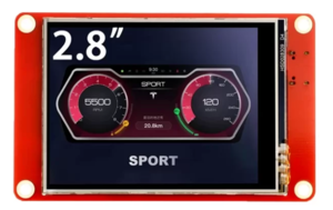

ESP32 Display 2.8-inch HMI MicroPython Tutorial
This tutorial will demonstrate how to program the ESP Terminal SPI via MicroPython.
The project of this tutorial is a smart light. When the ambient light intensity is lower than 60%, the LED will light up, otherwise, the LED will go out.
Hardware Preparation¶
| ESP32 Display 2.8-inch | Crowtail-Light Sensor | Crowtail-LED | USB-A(or USB-C) to USB-C cable | 2* 4-Pin HY2.0 Cables |
