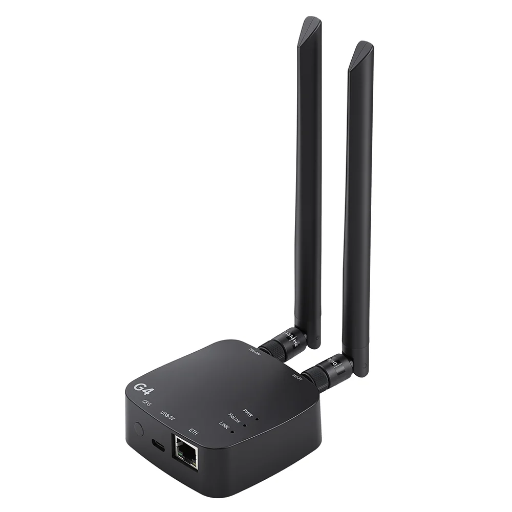

LED Indicators:
  • PWR LED (Red): Power status. Steady on when powered.
  • HaLow LED (Blue): Wi-Fi HaLow connection status. Steady on when connected to other HaLow devices.
  • Link LED (Green): Configuration status. Blinks during setup; remains steady on after the gateway is set to AP or Mesh Gate mode and obtains an IP address.

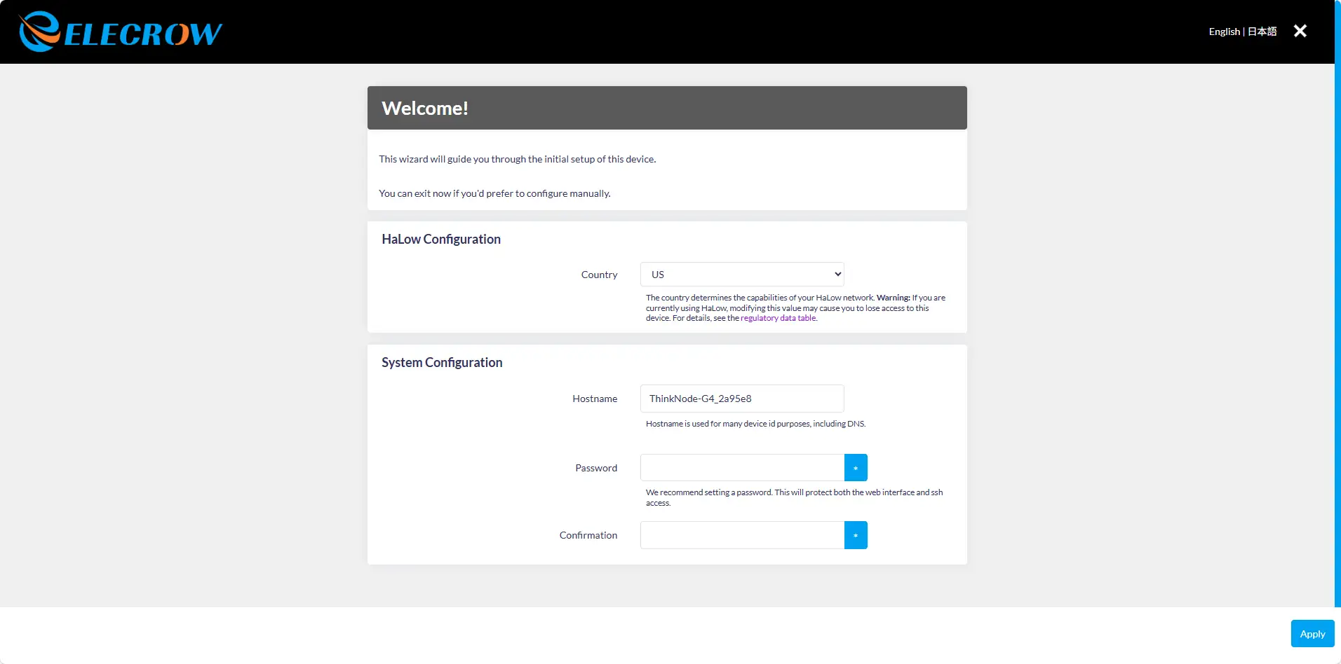

5,Set the Country and Hostname, then enter the password again (or click "Apply" directly if no password is desired).
g4_wi-fi_halow_mode_2
Note: If you lose connection to ThinkNode-G4_XXXX during setup, please reconnect to the Wi-Fi network (automatic connection is recommended).

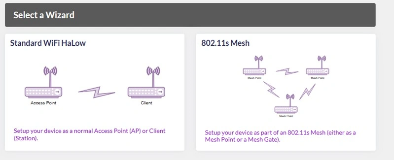

  1. Ensure "Configuration Preparations" are completed.
  2. Select "Standard Wi‑Fi HaLow".

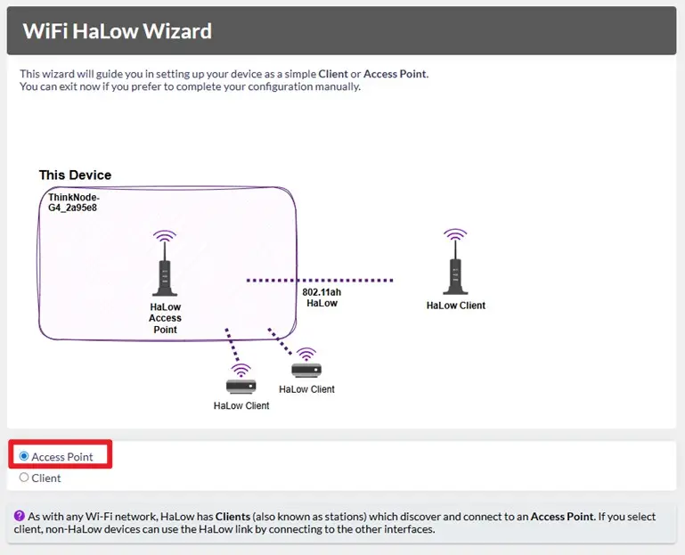

  1. Select "Access Point", then click "Next".

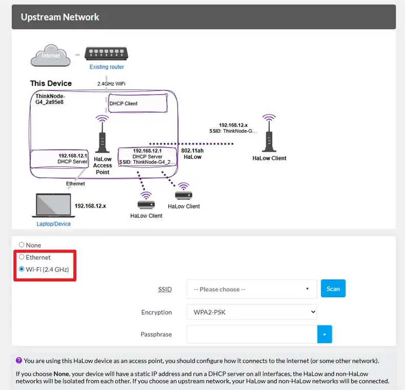

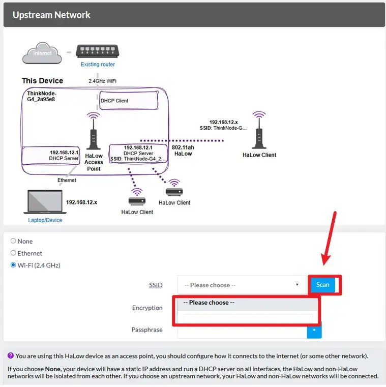

  1. Select the Upstream Network connection type. This determines how the AP connects to the network:
  2. None: The device has a static IP and runs a DHCP server on all interfaces. HaLow and non-HaLow networks are isolated.
  3. Ethernet Bridge: The device and connected HaLow clients obtain IP addresses from the upstream network.
  4. Ethernet Router: Connected HaLow clients get IP addresses from this device's DHCP server; traffic is forwarded via NAT.
  5. Wi-Fi (2.4 GHz): Connected HaLow clients get IP addresses from this device's DHCP server; traffic is forwarded via NAT.
g4_wi-fi_halow_mode_6
Note: If selecting "Wi-Fi (2.4 GHz)", you can click "Scan" or manually enter the Wi-Fi name and password.If you're using an Ethernet cable, no configuration is required.

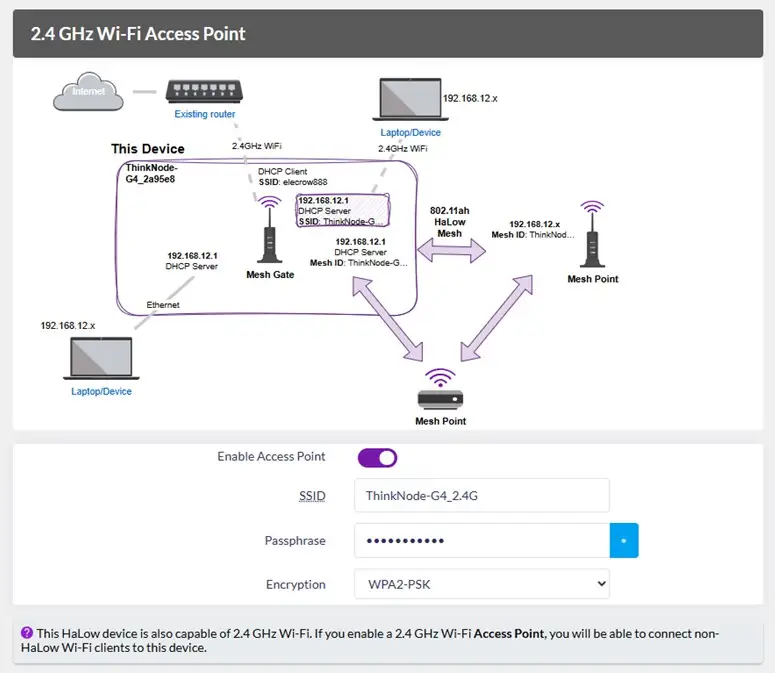

  1. Enable the "Enable Access Point" function. This provides a standard 2.4 GHz Wi-Fi hotspot in addition to the HaLow hotspot. Set the 2.4 GHz SSID and password (ensure they differ from the HaLow settings in Step 4).

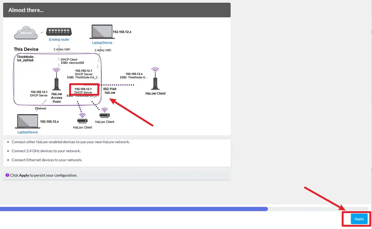

  1. Note the AP Gateway's IP Address(eg.192.168.12.1), then click "Apply" to finish. g4_wi-fi_halow_mode_9

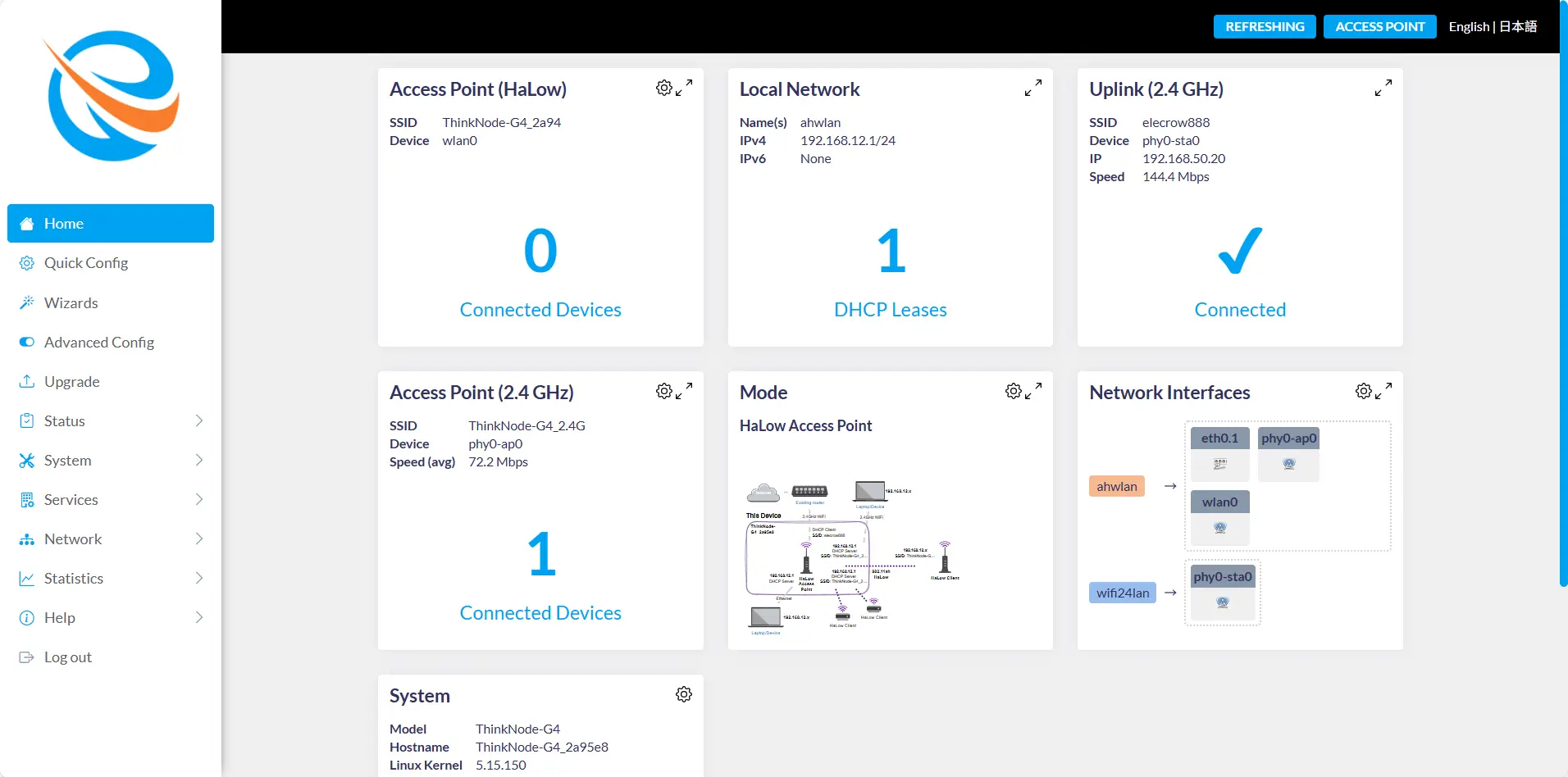

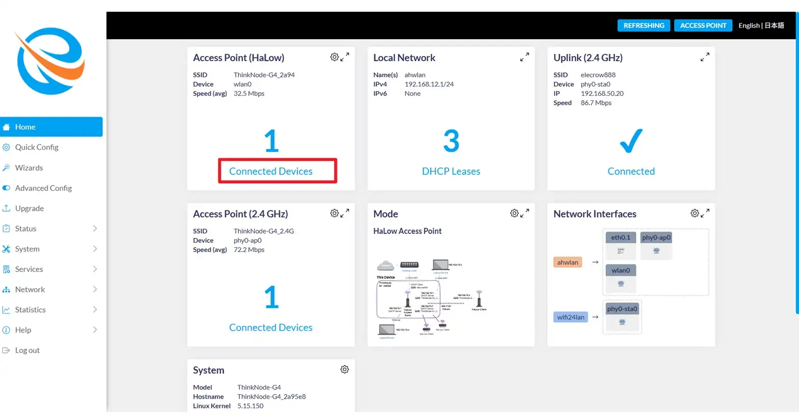

  1. Enter the IP Address (from Step 7) in a browser to access the management UI.
g4_wi-fi_halow_mode_1
  1. You can view various parameter information in the AP Gateway's admin interface
g4_wi-fi_halow_mode_13

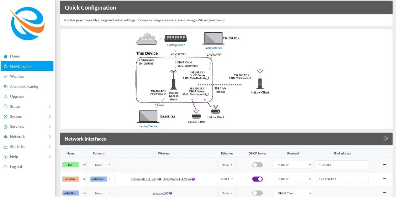

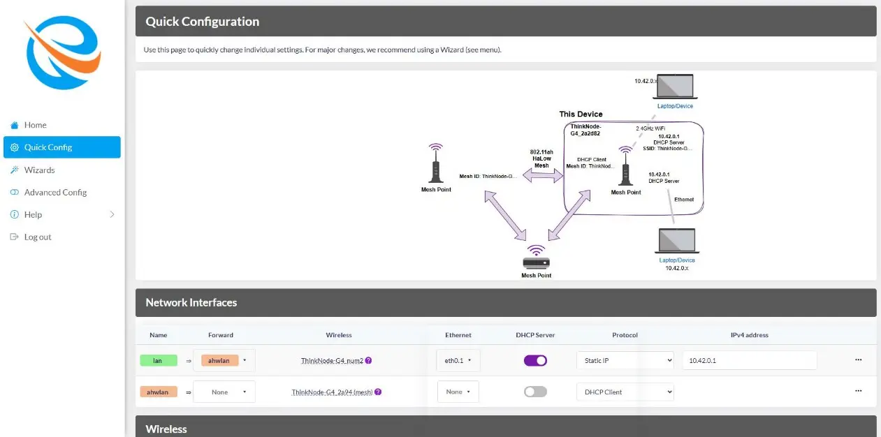

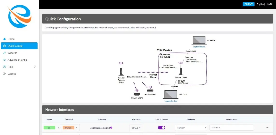

  1. Click “Quick Config” to quickly modify the configuration you just made;
    g4_wi-fi_halow_mode_14
  2. Click "Wizards" **to reconfigure the **"Access Point" or "Client” in Standard Wi‑Fi HaLow mod.

  1. Complete the**"Gateway configuration pre-preparation"**;

  1. Select "Client", then click "Next".

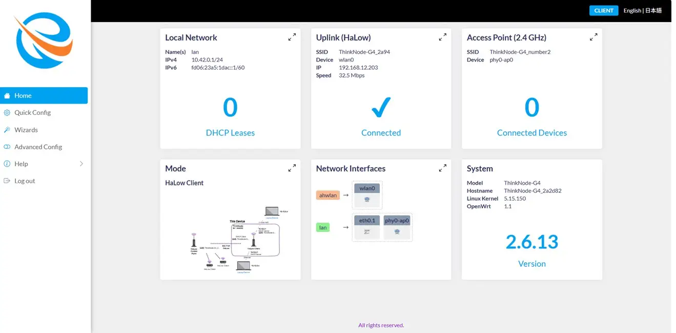

  1. Turn on**"Enable Access Point"**.This device also provides a standard 2.4 GHz WiFi hotspot. Set your 2.4 GHz WiFi hotspot name and password,and it is not the same as the AP gateway's 2.4 GHz WiFi hotspot name;
g4_wi-fi_halow_mode_20

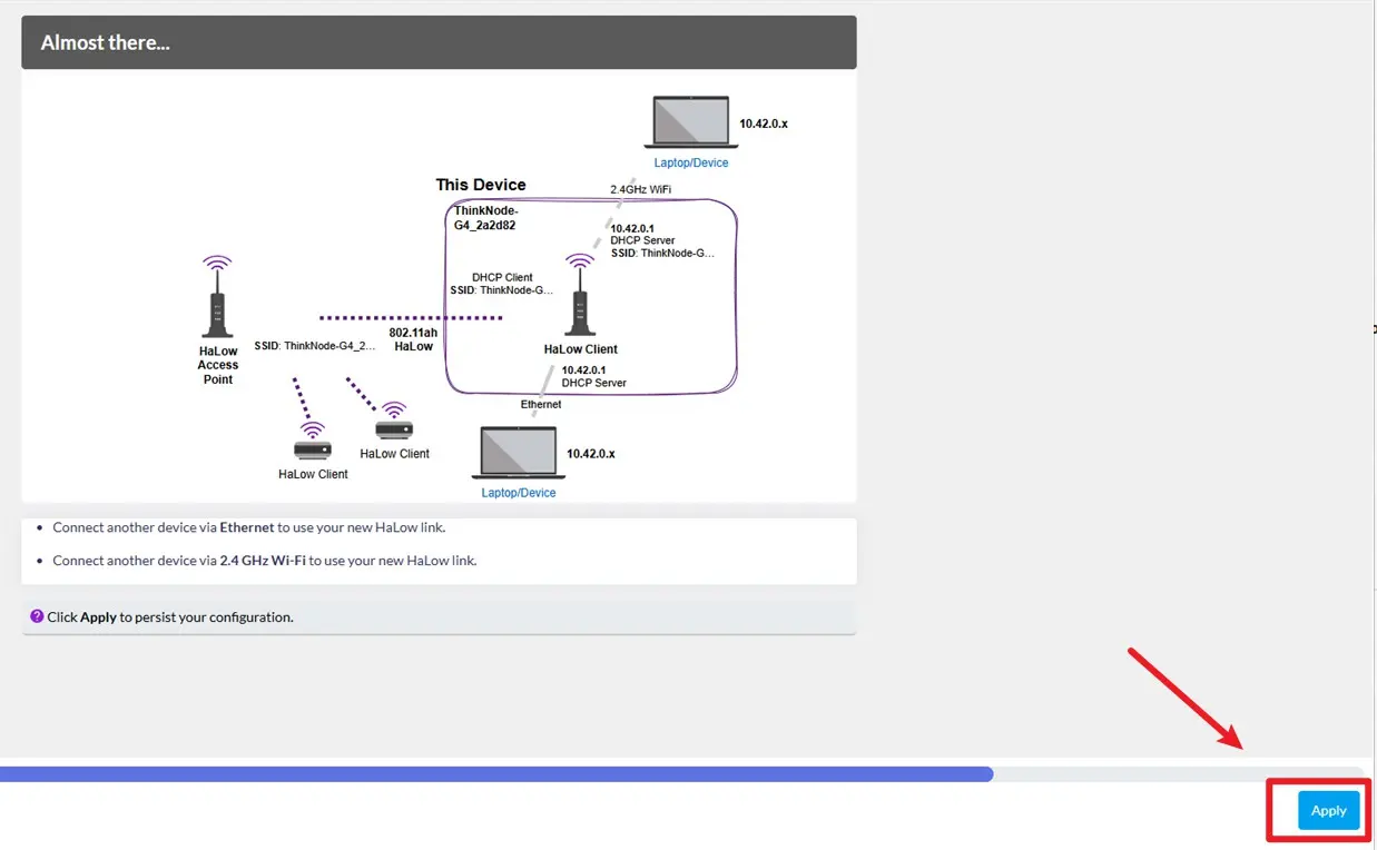

  1. Click "Apply" to complete the STA gateway configuration;
g4_wi-fi_halow_mode_21

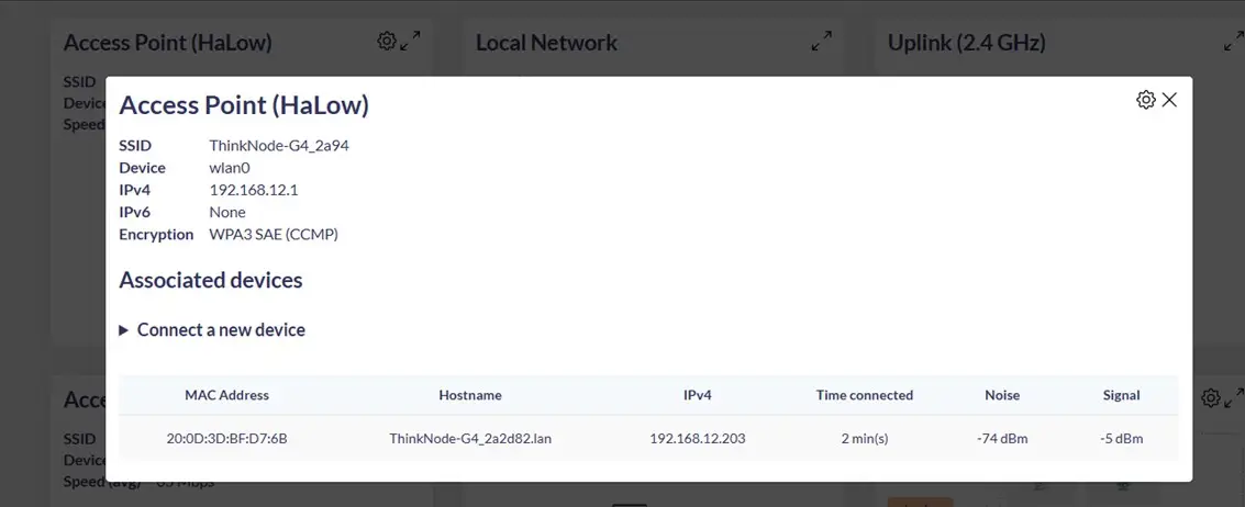

  1. Open the AP gateway's admin interface and click "Connected Devices" **to see the STA gateway's **“IP address”
g4_wi-fi_halow_mode_22

  1. Enter the STA Gateway's IP Address in a browser.
g4_wi-fi_halow_mode_24
  1. Click "QuickConfig" to quickly modify the configuration you just made;
g4_wi-fi_halow_mode_25
  1. Click "Wizards" to reconfigure the “AccessPoint” or “Client” in "Standard Wi‑Fi HaLow mode".

  1. Complete the "Gateway configuration pre-preparation";
  2. Select "802.11s Mesh".

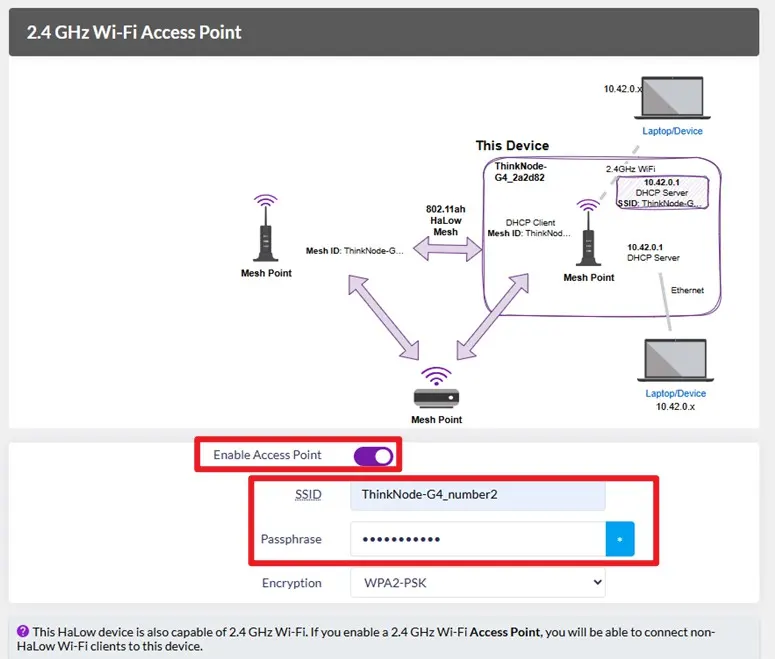

  1. Turn on "Enable Access Point". This device also provides a standard 2.4 GHz Wi-Fi hotspot. Set your 2.4 GHz Wi-Fi hotspot name and password,and make sure it is not the same as the Mesh gateway name from step4;
g4_wi-fi_halow_mode_30

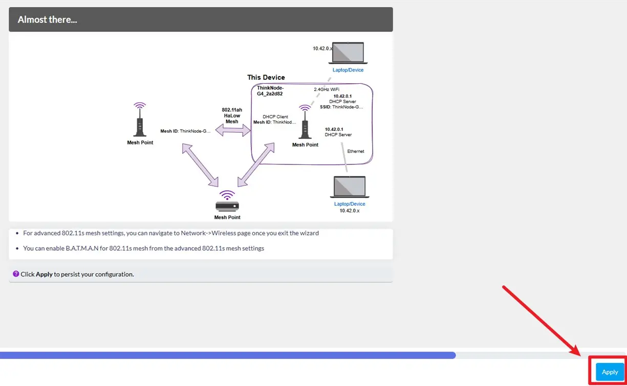

  1. Remember your Mesh Gateway “IP address”, then click "Apply" to complete the configuration;
g4_wi-fi_halow_mode_31

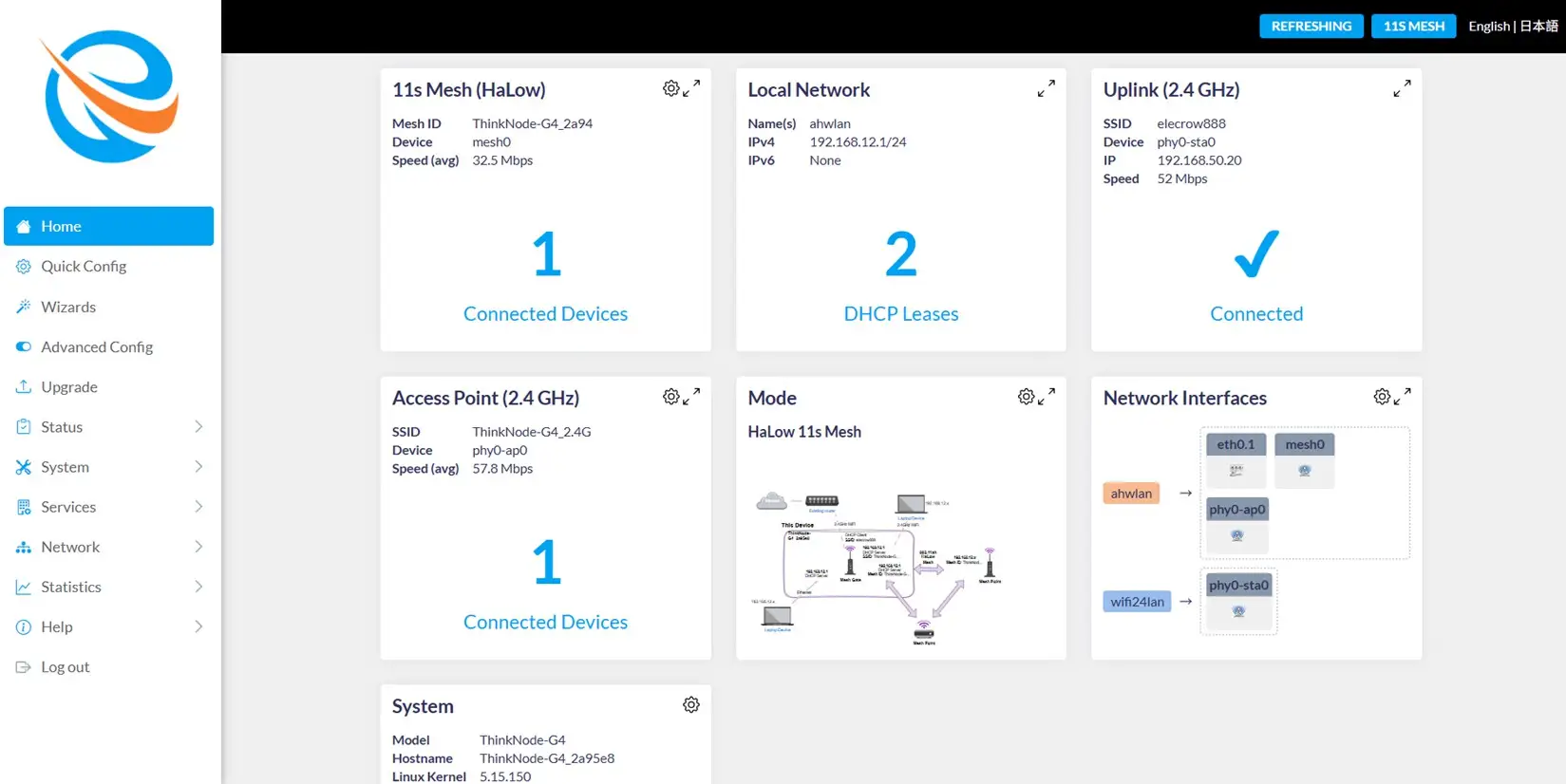

  1. Enter the IP Address in a browser to access the management UI.
  1. You can view various parameter information in the MeshGate’s admin interface;

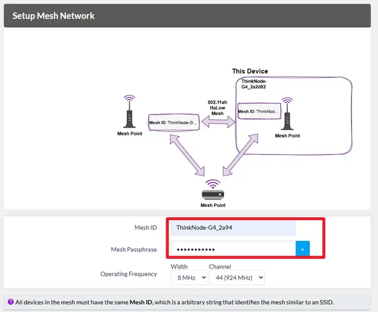

  1. Select "Mesh Point", then click "Next". g4_wi-fi_halow_mode_34
  2. Enter the Mesh Gate name and password you wish to connect to. g4_wi-fi_halow_mode_35

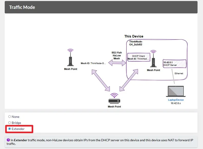

  3. Select Traffic Mode .Parameter descriptions are as follows:
None: This device will have a static IP address and run a DHCP server on non-HaLow interface,the HaLow and non-HaLow network are isolated.
Bridge: non-halow devices obtain IP from your halow link.
Extender: non-halow devices obtain IP from the DHCP server on this device and this device uses NAT to forward IP traffic.
g4_wi-fi_halow_mode_36
  1. Turn on "Enable Access Point".This device also provides a standard2.4 GHz Wi-Fi hotspot. Set your 2.4 GHz Wi-Fi hotspot name and password,and make sure it is not the same as the Mesh Gate’s 2.4 GHz hotspot name;
g4_wi-fi_halow_mode_37

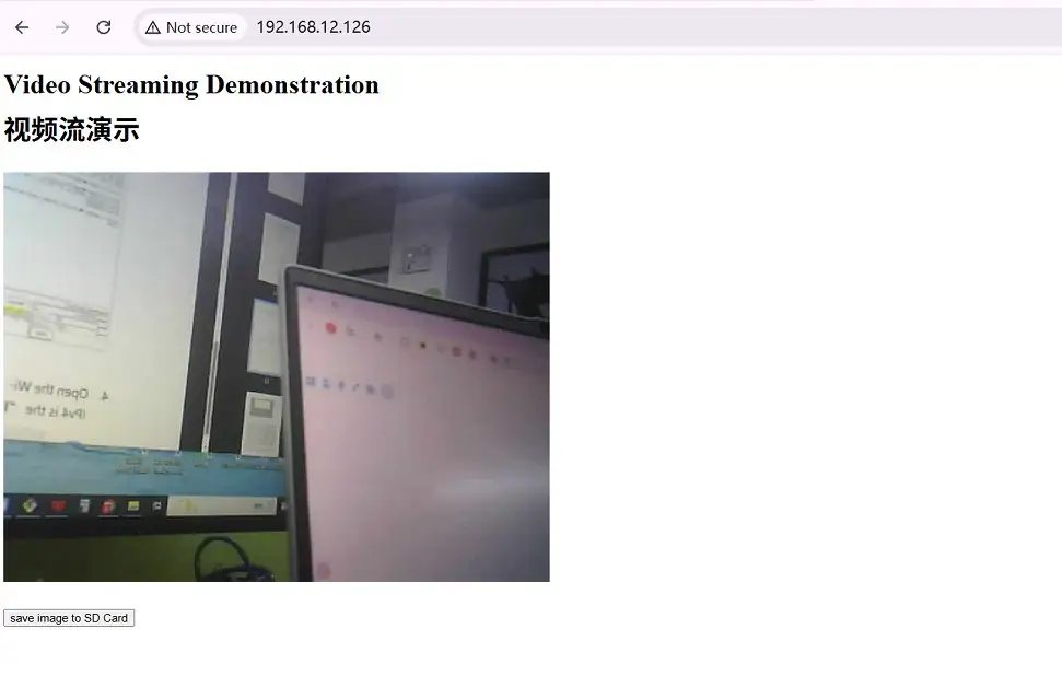

Use Cases for the Wi-Fi HaLow Module with 2MP Camera:
First, configure the ThinkNode G4 to AP mode. Note: For the Wi-Fi HaLow mode, you must connect to HaLow Network - AP, not a standard 2.4 GHz Wi-Fi network.

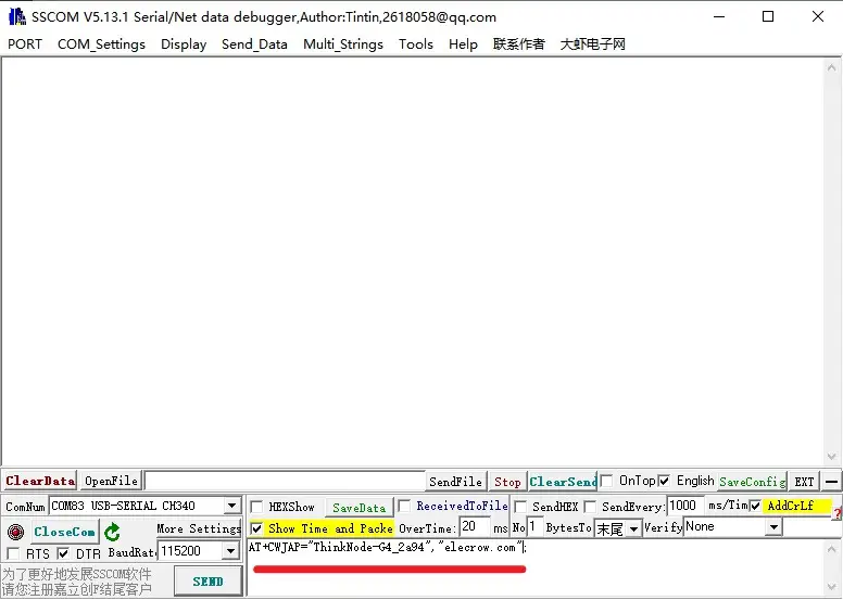

ESP32 Wi‑Fi HaLow module configuration
  1. Open a serial terminal tool (any serial tool works), select the corresponding port, and set the baud rate to 115200.
  2. Send: AT+CWJAP=“AP-SSID”, ‘Passphrase’; — where AP-SSID and Passphrase are the username and password for the Wi-Fi HaLow gateway, respectively. Please refer to the AP mode settings in the ThinkNode G4 Gateway Configuration manual. For example: AT+CWJAP=“ThinkNode-G4_2a94”, “elecrow.com”;
g4_wi-fi_halow_mode_43
  1. After sending, you will see the ESP32 Wi‑Fi HaLow Module attempt to connect to the Wi‑Fi HaLow gateway. When the connection is successful, you will receive the reply: “WLAN STA connected”.Then there is an IP address (for example: 192.168.12.126). Make a note of this IP address.
g4_wi-fi_halow_mode_44
  1. Open a browser (The computer or mobile phone used here must be on the same local area network as the G4.)and enter the ESP32 Wi‑Fi HaLow Module “IP address“to use the ESP32 Wi‑Fi HaLow Module.
g4_wi-fi_halow_mode_45
