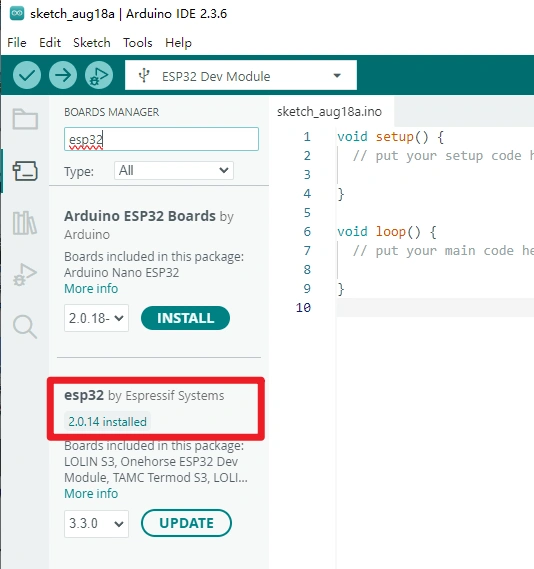

CrowPanel 2.1inch HMI ESP32 Rotary Display 480 IPS Round Touch Knob Screen Arduino lesson1
Use the configuration guide:
Get Started with Arduino IDE
Please note that the version of esp32 supported by the sample code provided with this product is 2.0.14.

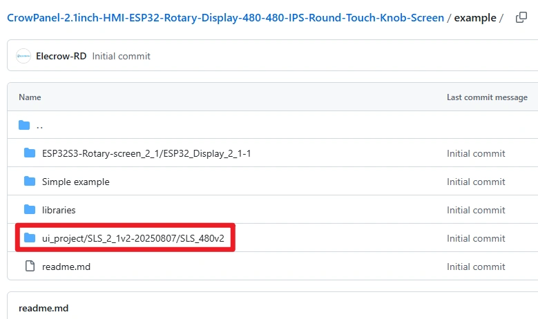

UI engineering files and code resources currently available on GitHub:
CrowPanel-2.1inch-HMI-ESP32-Rotary-Display-480-480-IPS-Round-Touch-Knob-Screen
CrowPanel2.1inchRotary-5

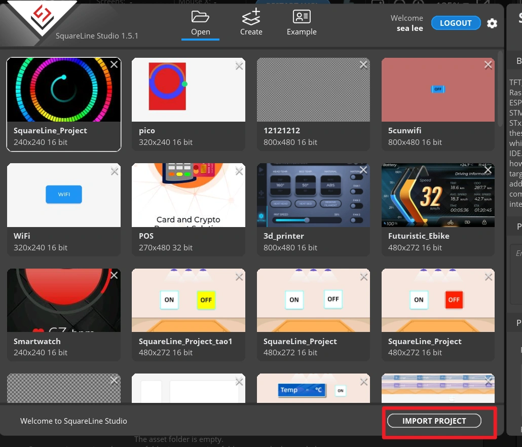

Importing UI projects using SquareLine Studio:
Click “Import Project” in the lower right corner to import the UI project we provided.
CrowPanel2.1inchRotary-6

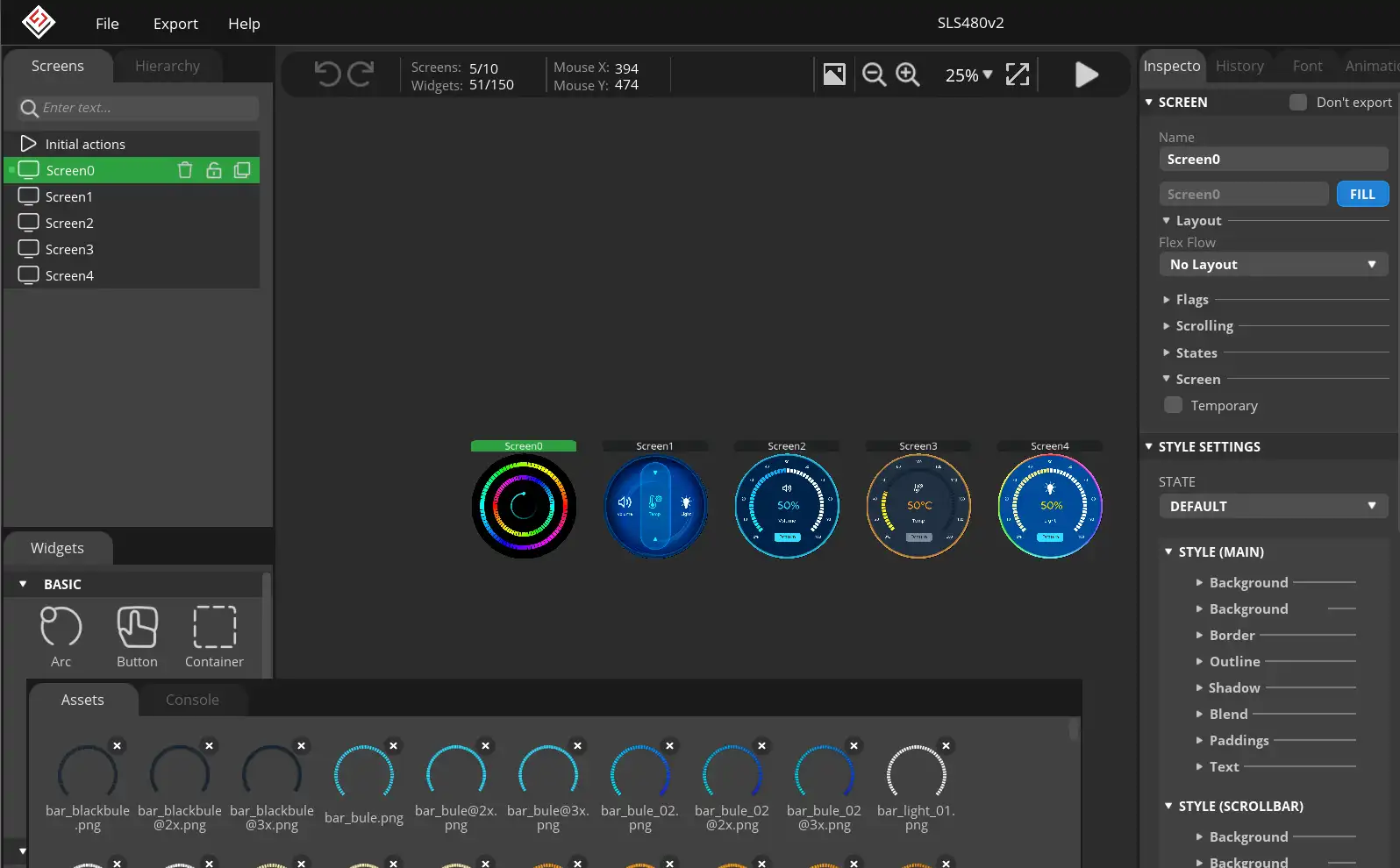

After importing, the project will appear in the list. Double-click to open the factory.
CrowPanel2.1inchRotary-7
CrowPanel2.1inchRotary-8

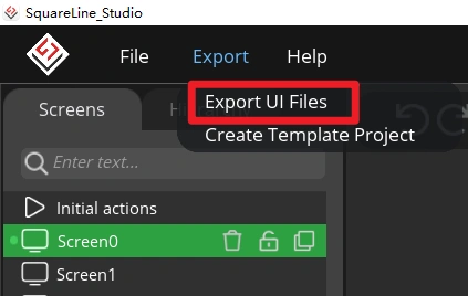

You can directly export UI files, use the UI files we provide, or modify the UI project yourself to customize your settings.
CrowPanel2.1inchRotary-9
CrowPanel2.1inchRotary-10

Click on the GitHub link download to download the code, and use Arduino to open.
CrowPanel2.1inchRotary-11
Click on the GitHub link download to download the library and UI files we provide, and place these files in the libraries folder..

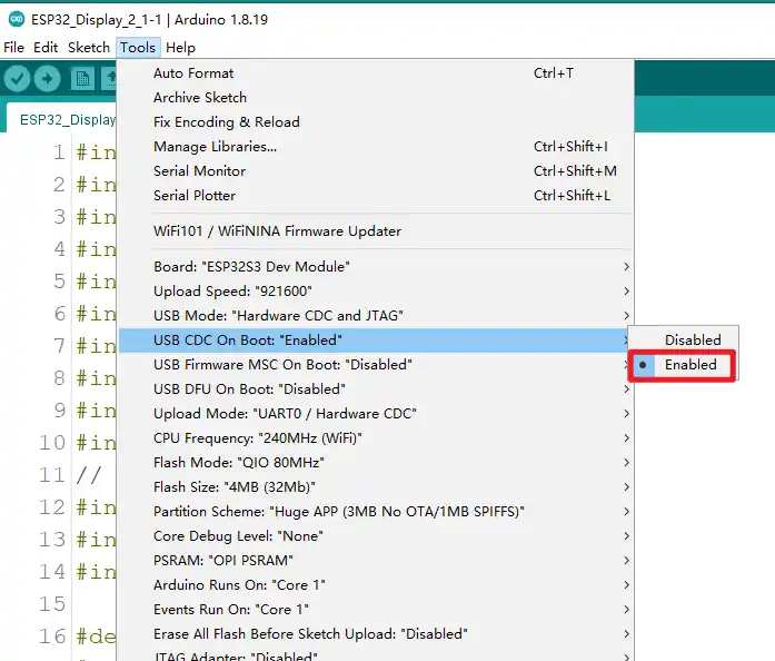

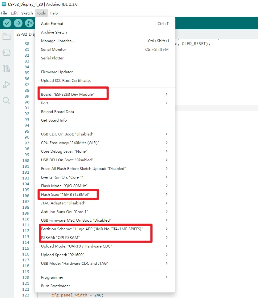

1.After completing the installation of the ESP32 board according to "Get Started with Arduino IDE" and the installation of the library according to "Install Libraries", open the program and connect the CrowPanel 1.28inch-HMI ESP32 Rotary Display to the computer via a USB-C cable.
2.Select Board: click "Tools" -> "Board" -> "esp32" and select "ESP32S3 Dev Module",Under the "Tools" menu, see "Flash Size" select 16MB(128Mb); "Partition scheme" and select "Huge APP(3MB No OTA/1MB SPIFFS)"; "PSRAM" select "OPI PSRAM"
CrowPanel1.28inchRotary-10
Note: The factory program here contains a lot of content, and the app0 partition is too small. It needs to be repartitioned. Refer to this document for partitioning instructions.
modify sizes of app0 and spiffs.(1).pdf

Note that if you use USB-5V-IN to view serial port data, you need to enable USB cdc on boot in the download settings here.
