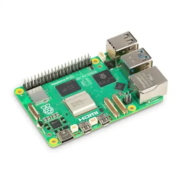

  • a Raspberry Pi 5;
  • a 64GB SD card;
  • a CrowPanel 2.1inch-HMI ESP32 Rotary Display

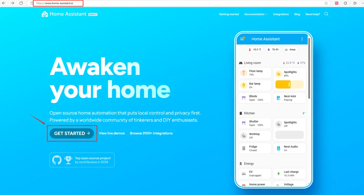

Download Home Assistant
Open the official website of Home Assistant: https://www.home-assistant.io/

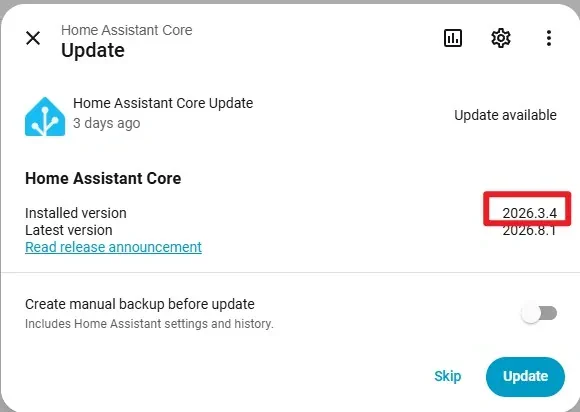

The version we are using here is 2026/¾.
Please use the same version as ours; otherwise, the code we provide may produce errors under a newer version.

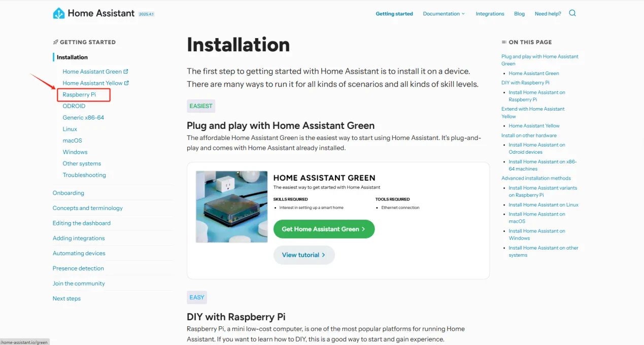

Select a Raspberry Pi and install the Home Assistant system according to this installation guide. (Install according to the official installation guide.)

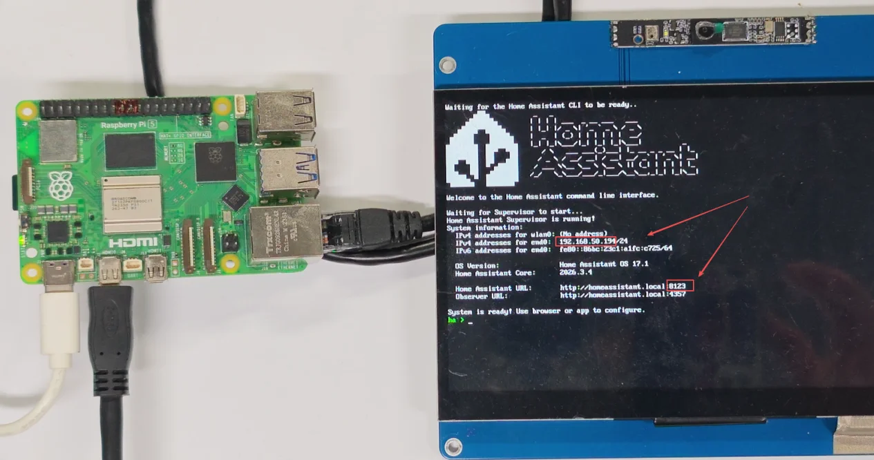

Note: The Raspberry Pi must be connected to a screen to view information. Once everything is ready, power on the Raspberry Pi and wait for it to load. The screen will display the following image.
(You need to connect a display screen to the Raspberry Pi in order to see these information.)
image-20260811174933286
Remember the IP address and the Home Assistant URL.

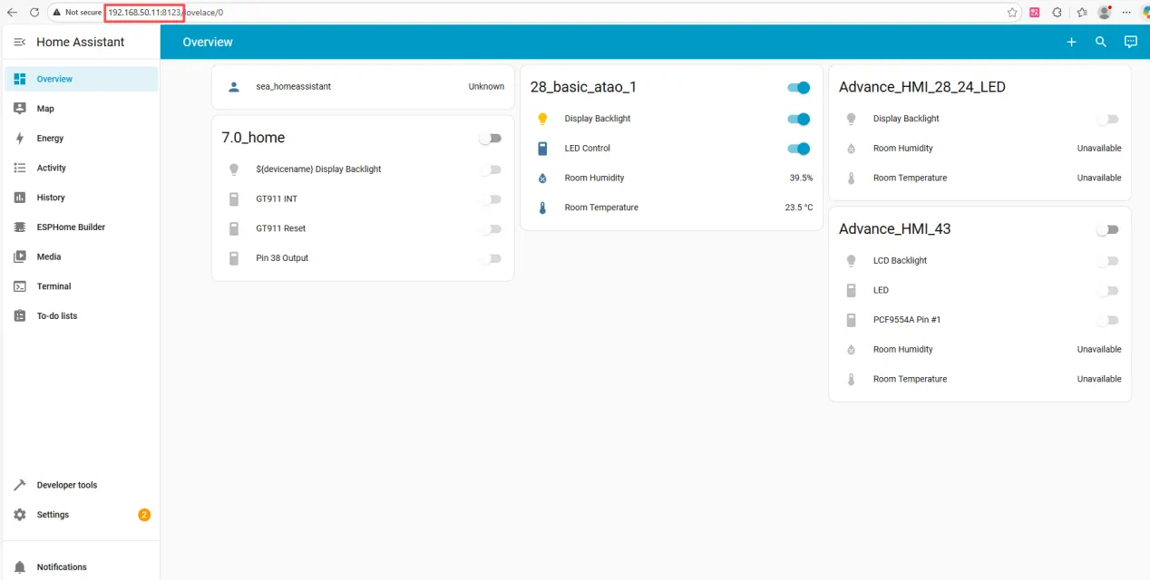

In my case, the IP address is: 192.168.50.11
So I enter 192.168.50.11:8123 in the browser.

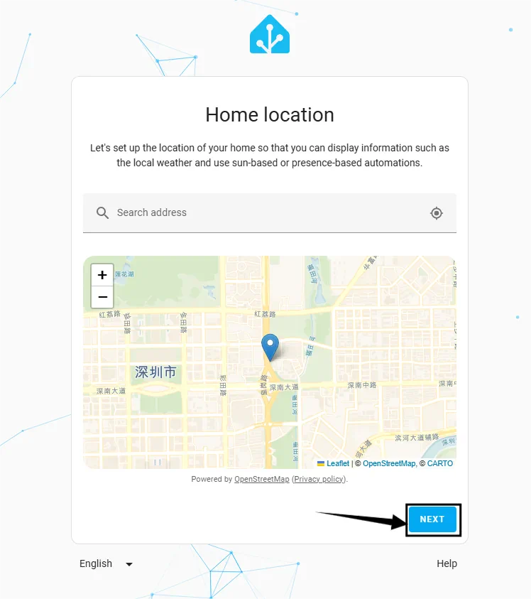

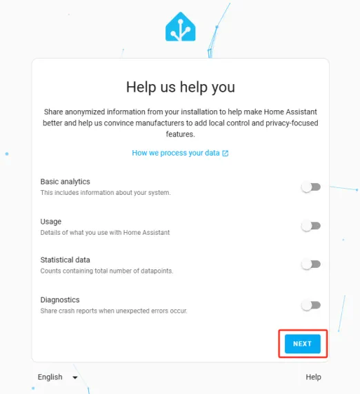

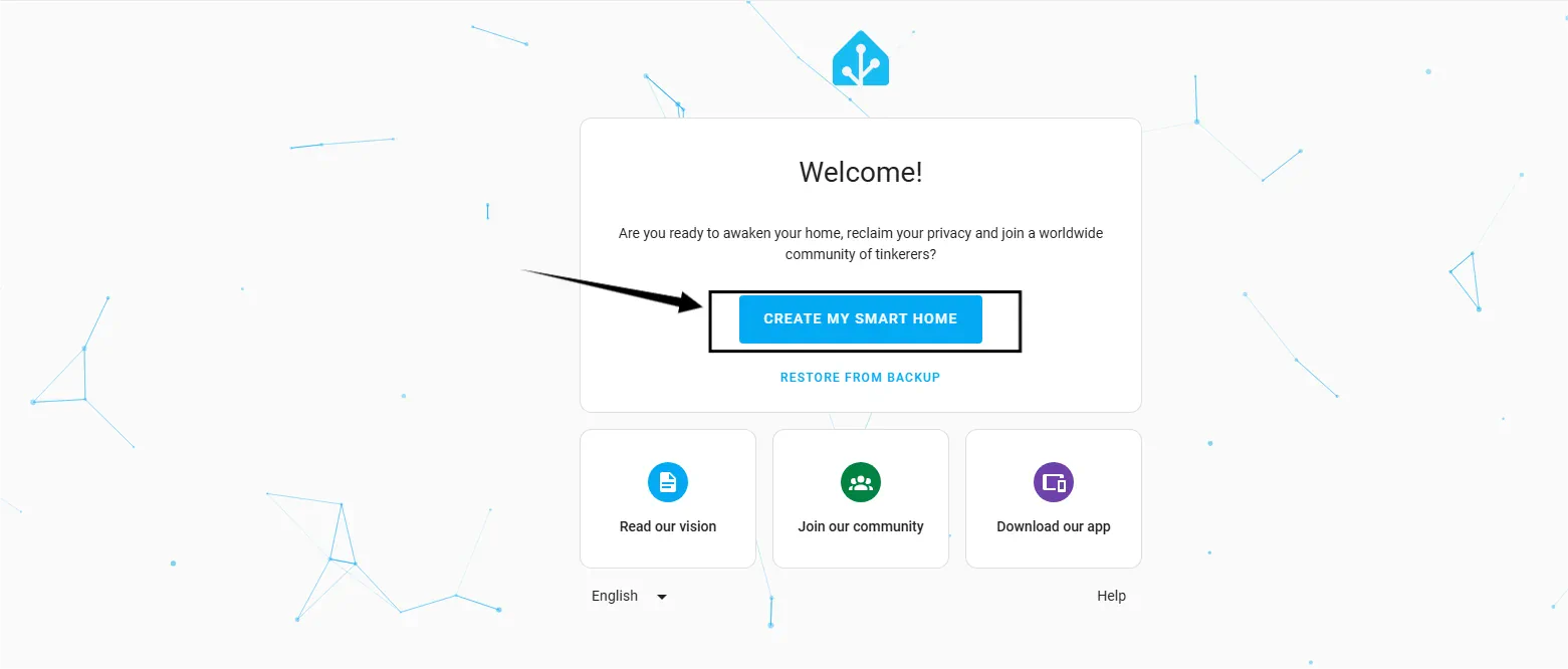

Next, start configuring the Home Assistant system.
You can either manually set your location or allow it to be detected automatically.
By default, click 'Next'.

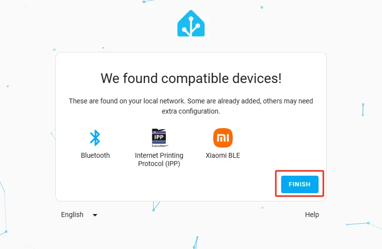

You can either add smart devices now or click Finish to add them later.
Here, we will add the devices later.

This will bring you to the main interface of Home Assistant.

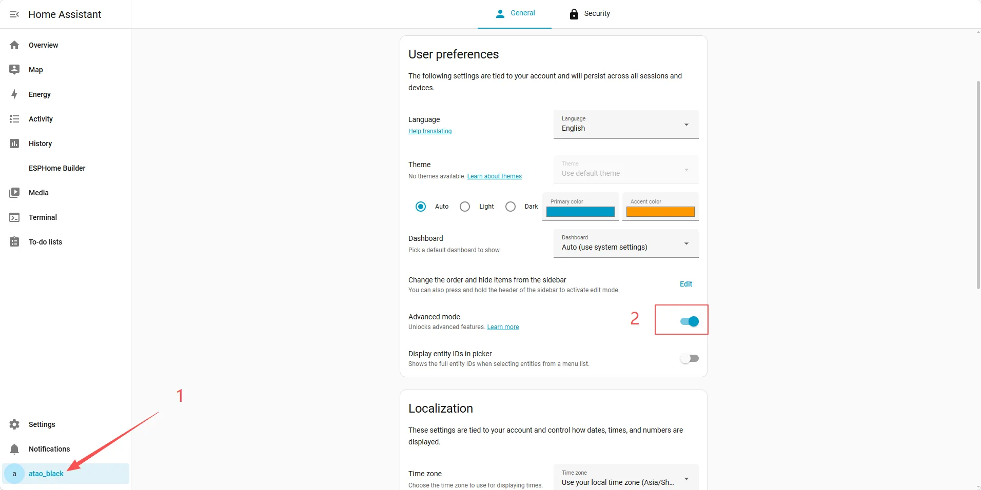

Click on the username and enable "Advanced Mode."

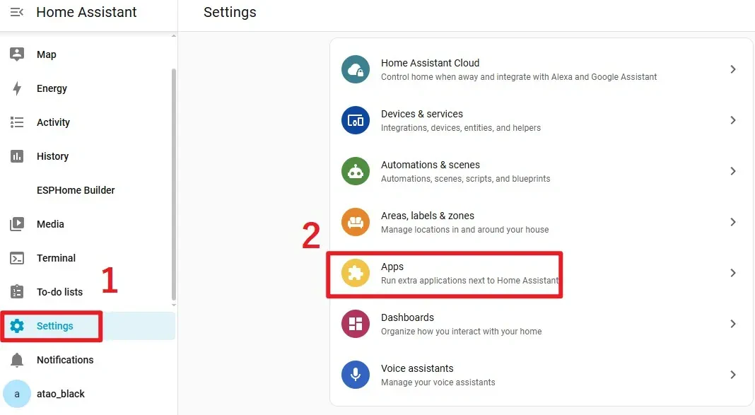

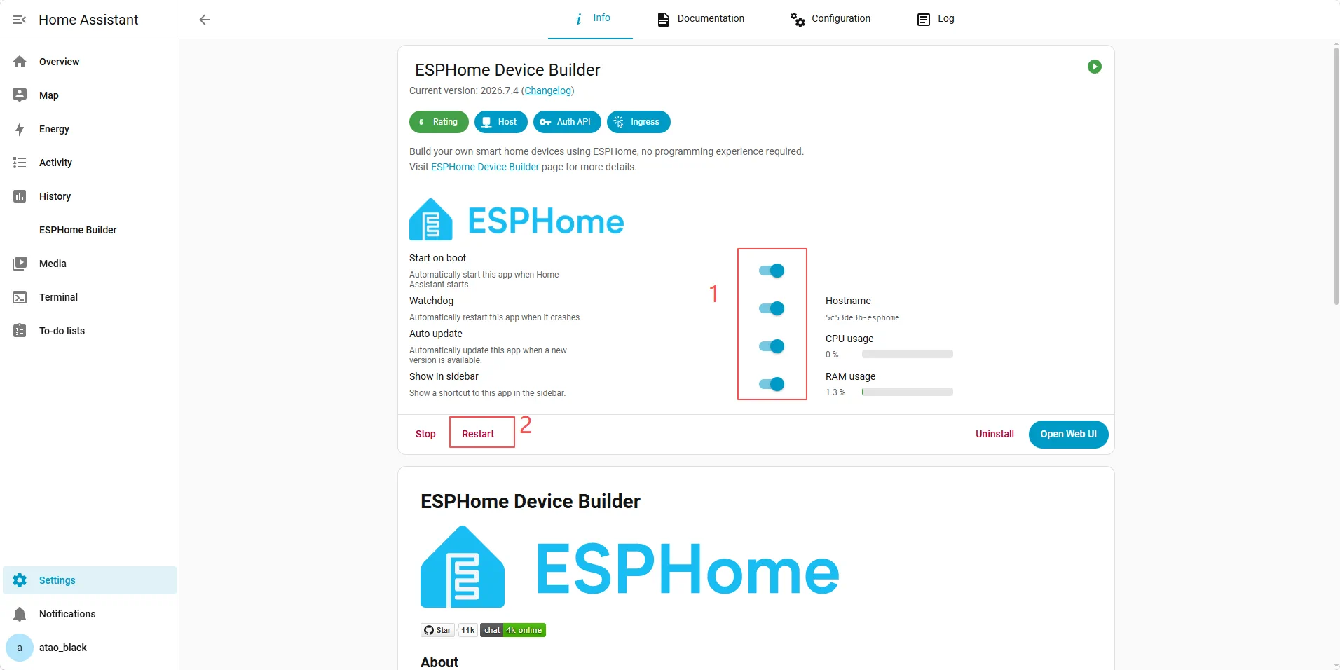

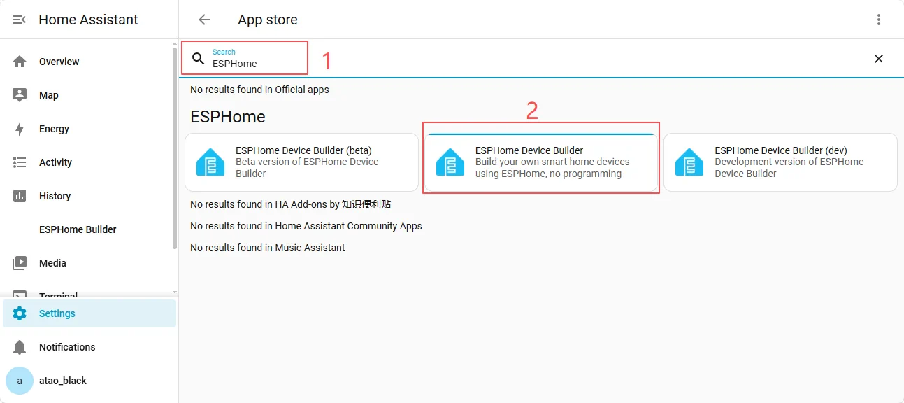

Click on "Settings" and then "Apps."

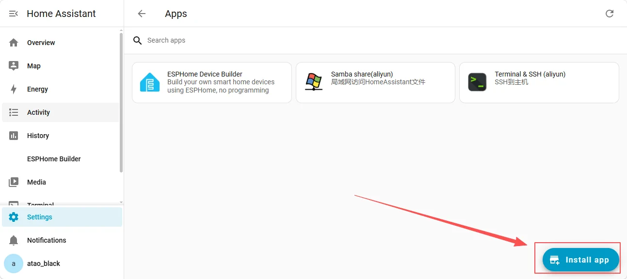

Click on "Install app" and type ESPHome to install it.
image-20260811174446277
image-20260811174534746
The installation is in progress, as shown in the image.
image-20260811174635376
This completes the ESPHome installation. Going forward, you will be able to use ESPHome to edit code and implement the features you want.
