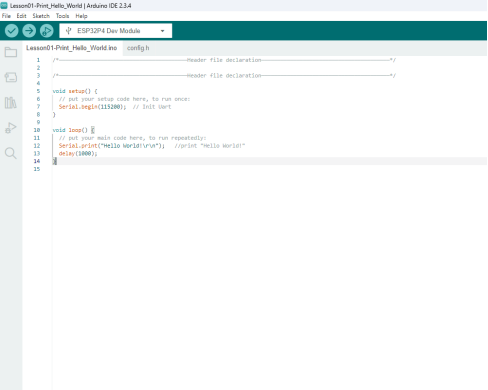

After the installation is completed, open the Arduino IDE.
First, randomly open a project.

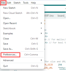

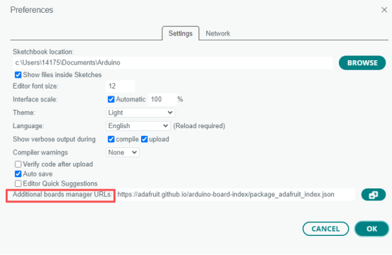

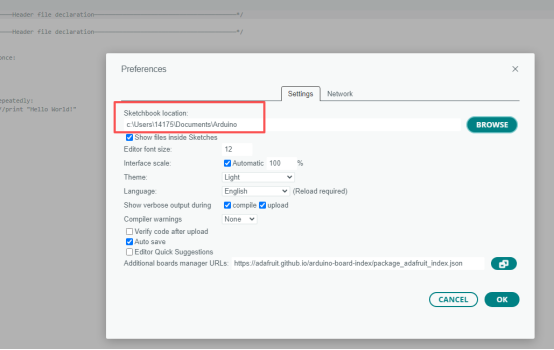

Go to "Preferences".
image-20260604153313789

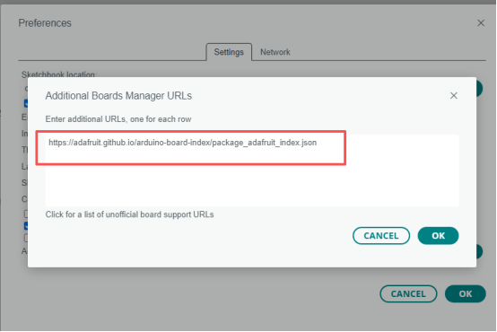

Configure "Additional Boards Manager URLs"
image-20260604153341385
Add this in.
https://adafruit.github.io/arduino-board-index/package_adafruit_index.json
image-20260604153417638

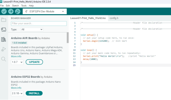

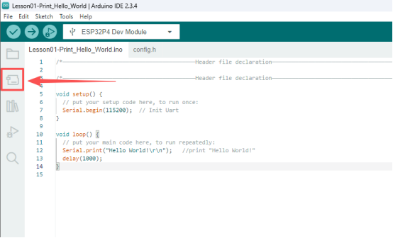

First, click on "board manage" on the left side.
image-20260604153431647
After opening
image-20260604153440567
Search for ESP32 and download it (the version we were using for development at the time was 3.0.2)

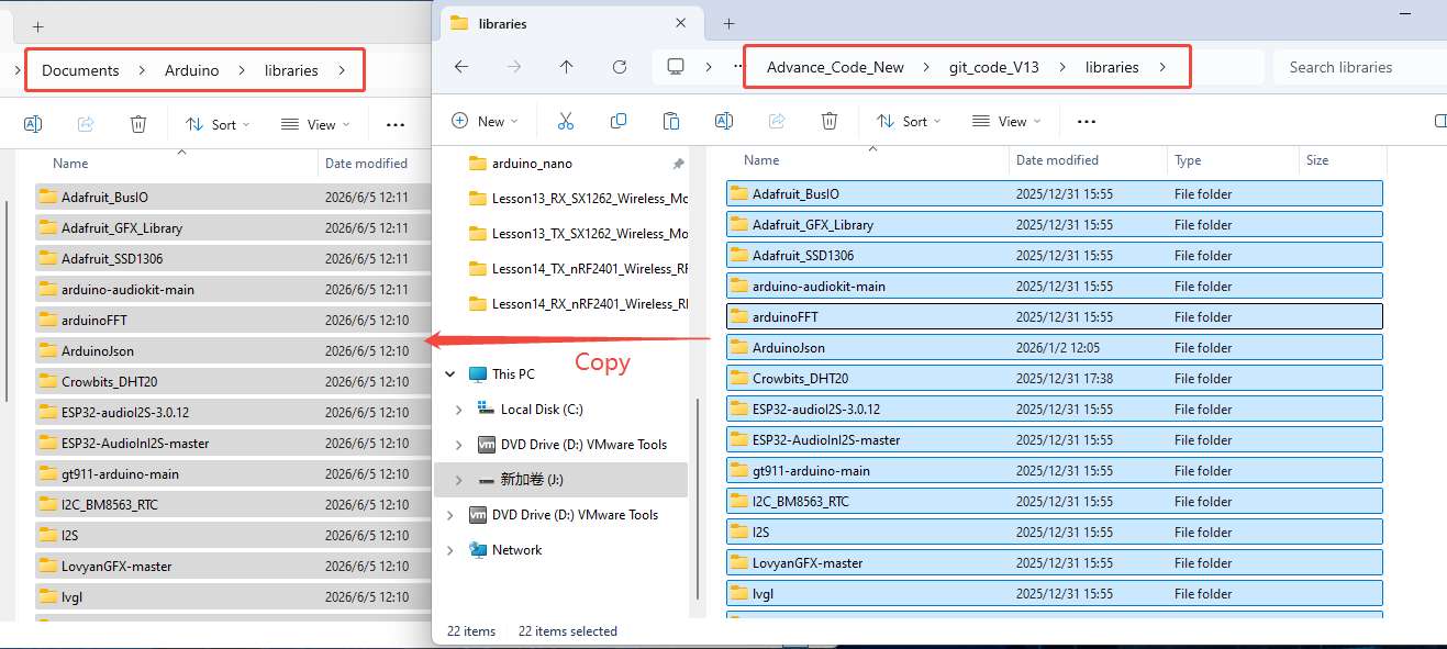

Before getting started, we first need to download the library files required by the development board and place them in the corresponding C/Users/your-username/Documents/Arduino/libraries directory on your computer. You can find the location of your Arduino workspace by navigating to File → Preferences in Arduino IDE, as shown below.
Download link:
CrowPanel-Advance-2.4-HMI-ESP32-S3-AI-Powered-IPS-Touch-Screen-320x240/example/V1.1_and_V1.2/Arduino_Code/libraries at master · Elecrow-RD/CrowPanel-Advance-2.4-HMI-ESP32-S3-AI-Powered-IPS-Touch-Screen-320x240
Enter this path and check the location where the library files are stored.
image-20260604153913734
image-20260604153919934
After determining the location where the library files are stored
Copy all the library files contained in the downloaded "libraries" file to the "C:\Users\Username\Documents\Arduino\libraries" folder on your local computer.
For example, the operation shown in the figure:
image-20260604154041213

3.4 Enter the following code
This case code only requires the use of Advance HMI series board and serial port cable.
It is possible to print Hello World every second through a serial port tool.
int counter = 0;                    // Define a counter variable
void setup() {
 Serial.begin(9600);                // Initialize serial communication
void loop() {
 // Print "Hello, World!" and the value of the counter
 Serial.print("Hello, World! ");    // Print "Hello, World!"
 Serial.print("--- ");              // Add space between "Hello, World!" and the number
 Serial.println(counter);           // Print the value of the counter
 counter++;                         // Increment the counter
 delay(1000);                       // Output every 1 second
