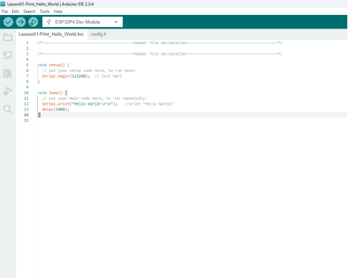

3 Install ESP32 development board version 3.0.2
After the installation is completed, open the Arduino IDE.
First, randomly open a project.

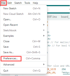

Go to "Preferences".
35_image_02

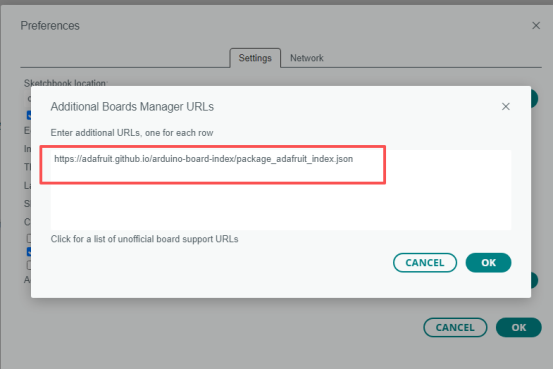

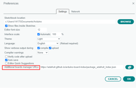

Configure "Additional Boards Manager URLs"
35_image_03
Add this in.
https://adafruit.github.io/arduino-board-index/package_adafruit_index.json
35_image_04

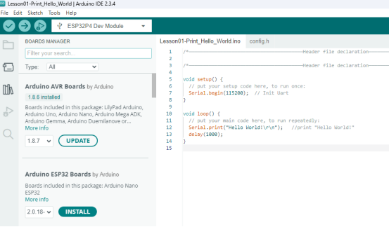

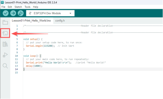

First, click on "board manage" on the left side.
35_image_05
After opening
35_image_06
Search for ESP32 and download it (the version we were using for development at the time was 3.0.2)

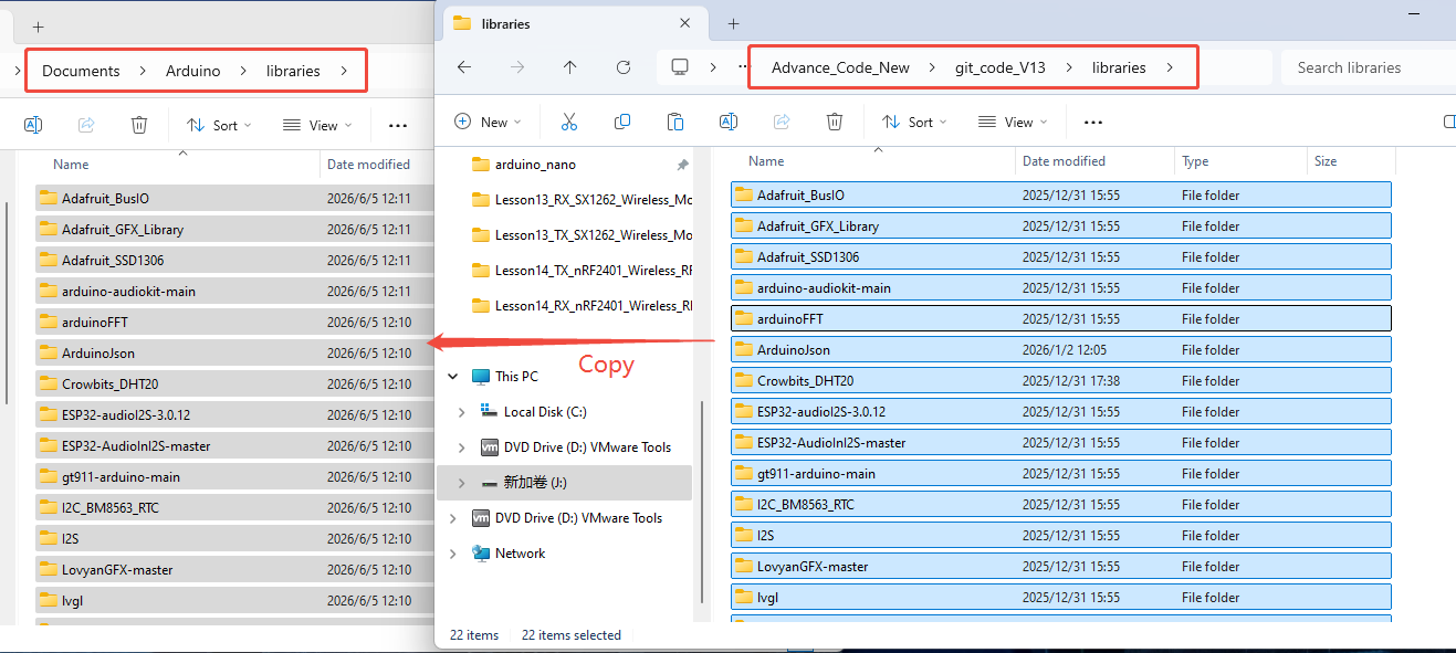

Before getting started, we first need to download the library files required by the development board and place them in the corresponding C/Users/your-username/Documents/Arduino/libraries directory on your computer. You can find the location of your Arduino workspace by navigating to File → Preferences in Arduino IDE, as shown below.
Download link:
CrowPanel-Advance-3.5-HMI-ESP32-S3-AI-Powered-IPS-Touch-Screen-480x320/example/V1.2_and_V1.3_and_V1.4/Arduino_Code/libraries at master · Elecrow-RD/CrowPanel-Advance-3.5-HMI-ESP32-S3-AI-Powered-IPS-Touch-Screen-480x320
Enter this path and check the location where the library files are stored.
35_image_07
35_image_08
After determining the location where the library files are stored
Copy all the library files contained in the downloaded "libraries" file to the "C:\Users\Username\Documents\Arduino\libraries" folder on your local computer.
For example, the operation shown in the figure:
35_image_09
Note: If there is no "libraries" folder in your path, please create one yourself.

3.4 Enter the following code
This case code only requires the use of Advance HMI series board and serial port cable.
It is possible to print Hello World every second through a serial port tool.
int counter = 0;                    // Define a counter variable
void setup() {
 Serial.begin(9600);                // Initialize serial communication
void loop() {
 // Print "Hello, World!" and the value of the counter
 Serial.print("Hello, World! ");    // Print "Hello, World!"
 Serial.print("--- ");              // Add space between "Hello, World!" and the number
 Serial.println(counter);           // Print the value of the counter
 counter++;                         // Increment the counter
 delay(1000);                       // Output every 1 second
