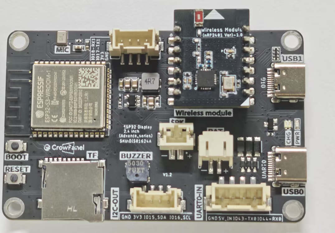

One of the nRF2401 wireless modules is inserted into the W-M wireless module slot to perform the sending task;
35_image_6_1

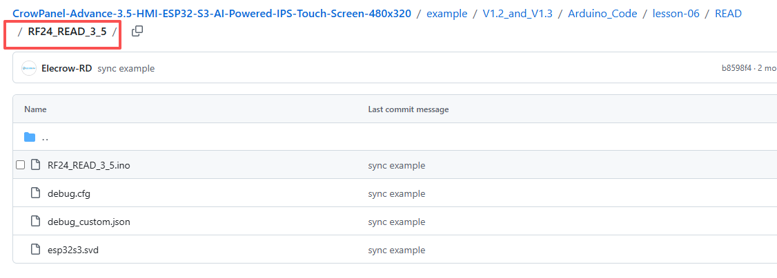

Open the READ folder.
Select the corresponding size code to open.

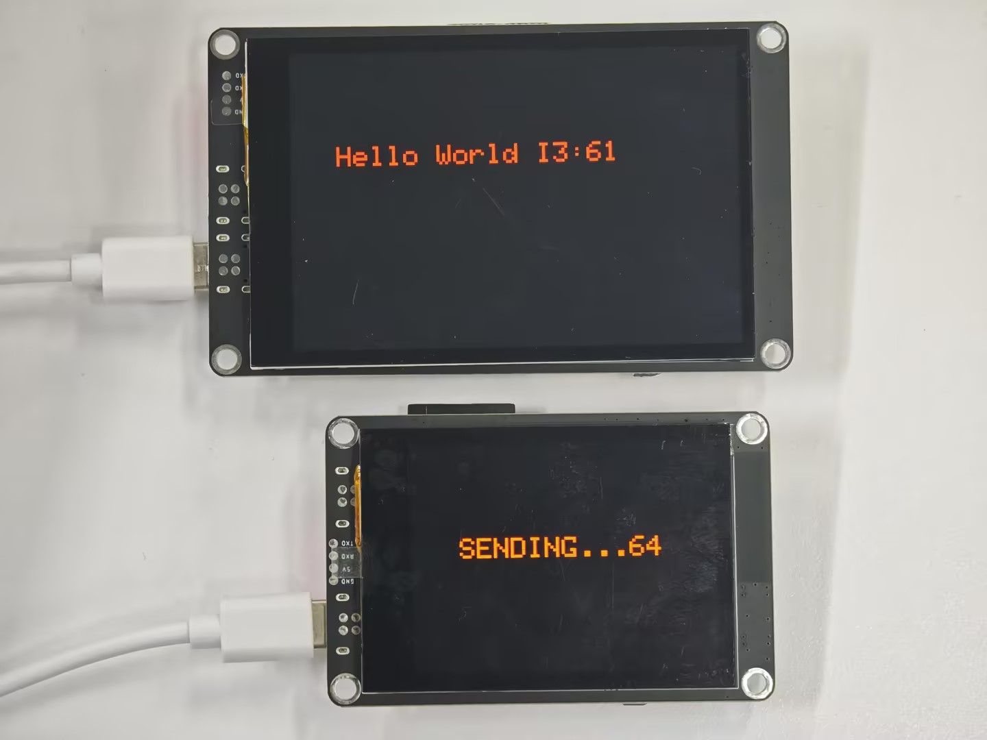

You can see that Hello World has received it.

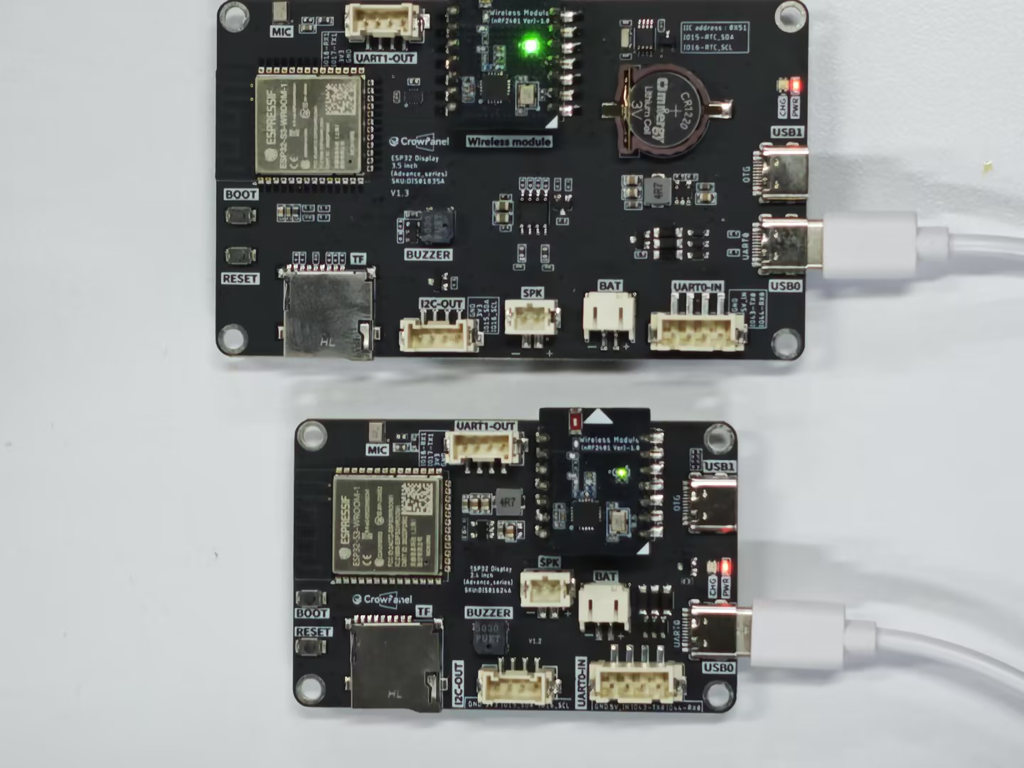

After waiting for the code upload to complete, insert the nRF2401 wireless module into the W-M slot.
35_image_6_3
Send messages using the 2.4-inch device and receive messages using the 3.5-inch device.
35_image_6_4
