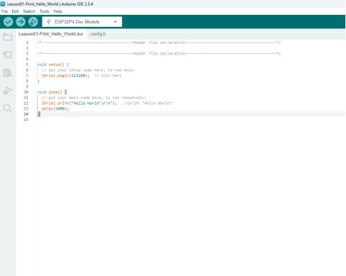

After the installation is completed, open the Arduino IDE.
First, randomly open a project.
70_image_01

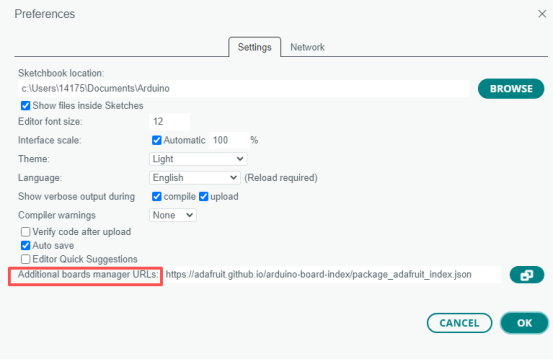

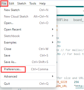

Go to "Preferences".
70_image_02

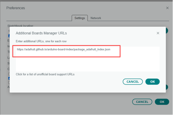

Configure "Additional Boards Manager URLs"
70_image_03
Add this in.
https://adafruit.github.io/arduino-board-index/package_adafruit_index.json
70_image_04

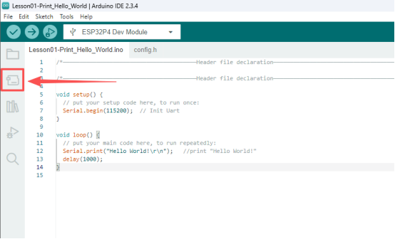

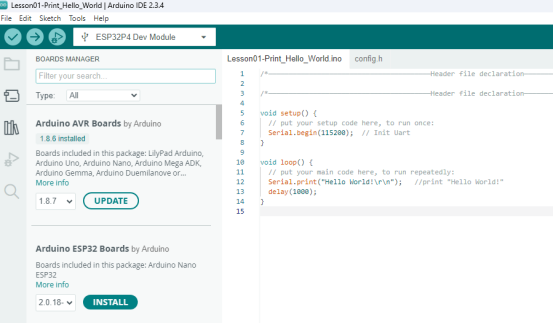

First, click on "board manage" on the left side.
70_image_05
After opening
70_image_06
Search for ESP32 and download it (the version we were using for development at the time was 3.0.2)

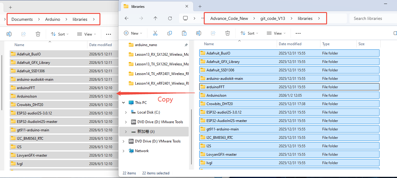

Before getting started, we first need to download the library files required by the development board and place them in the corresponding C/Users/your-username/Documents/Arduino/libraries directory on your computer. You can find the location of your Arduino workspace by navigating to File → Preferences in Arduino IDE, as shown below.
Download link:
CrowPanel-Advance-7-HMI-ESP32-S3-AI-Powered-IPS-Touch-Screen-800x480/example/V1.3_and_V1.4_and_V1.5/arduino/libraries at master · Elecrow-RD/CrowPanel-Advance-7-HMI-ESP32-S3-AI-Powered-IPS-Touch-Screen-800x480
Enter this path and check the location where the library files are stored.
70_image_07
70_image_08
After determining the location where the library files are stored
Copy all the library files contained in the downloaded "libraries" file to the "C:\Users\Username\Documents\Arduino\libraries" folder on your local computer.
For example, the operation shown in the figure:
70_image_09
Note: If there is no "libraries" folder in your path, please create one yourself.

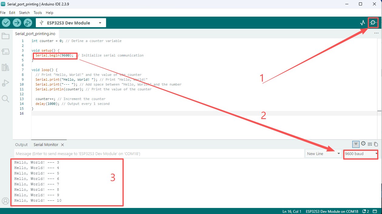

3.4 Enter the following code
This case code only requires the use of Advance HMI series board and serial port cable.
It is possible to print Hello World every second through a serial port tool.
int counter = 0;                    // Define a counter variable
void setup() {
 Serial.begin(9600);                // Initialize serial communication
void loop() {
 // Print "Hello, World!" and the value of the counter
 Serial.print("Hello, World! ");    // Print "Hello, World!"
 Serial.print("--- ");              // Add space between "Hello, World!" and the number
 Serial.println(counter);           // Print the value of the counter
 counter++;                         // Increment the counter
 delay(1000);                       // Output every 1 second
3.5 Configure the burning environment
3.5.1 Select development board
Path:Tools->Board->esp32->ESP32S3 Dev Module
3.5.2 Select Flash Size
Path:Tools->Flash Size->16MB(128Mb)
3.5.3 Select Partition Scheme
Path:Tools->Partition Scheme->Huge APP (3MB No OTA/1MB SPIFFS)
3.5.4 Select PSRAM
Path:Tools->PSRAM->OPI PSRAM
3.5.5 Finally, choose the serial port number you are using
Path:Tools->Port->(The port number you are using yourself)
3.6 Burn code
3.7 Wait for the burning to complete, open the serial port tool, and observe that Hello World is printed every second
