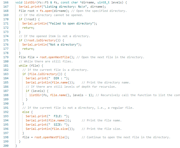

The function listDir() is designed to traverse all files and subdirectories within a specified directory and print the results to the serial monitor. The function first opens the specified directory, then checks whether the path exists and whether it is of directory type. If the directory is opened successfully, it uses the function openNextFile() to read the files in the directory one by one.
When encountering a regular file, the file name and file size are output; when encountering a folder, the folder name is output, and whether to recursively enter the next layer of the directory for further scanning is determined according to the levels parameter.
Through this recursive traversal method, the file structure on the SD card can be quickly viewed, and whether the image files exist and the storage path are correct can be confirmed. Therefore, this function essentially functions as a simple version of a file manager or directory browser.

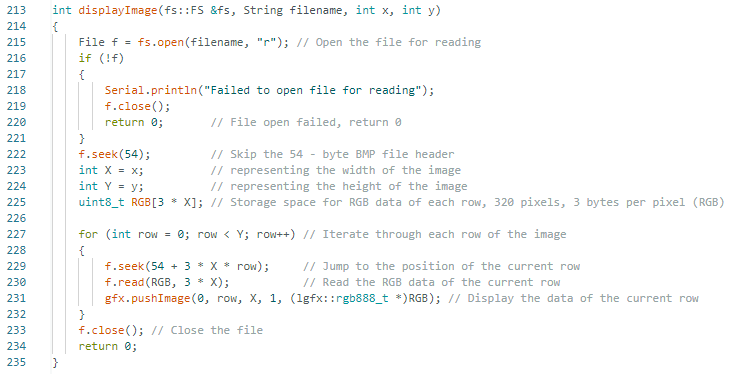

The function displayImage() reads BMP format images from the SD card and displays the image content on the LCD screen. The function first opens the specified BMP file, then skips the fixed 54-byte file header of the BMP file and directly locates to the pixel data area. Since BMP images are stored in the RGB888 format, each pixel occupies 3 bytes, so the program creates a buffer that can store the pixel data of a whole row.
Then, through a loop, it reads the image content row by row, reads one row of RGB data from the SD card each time, and calls LovyanGFX's gfx.pushImage() to draw this row of pixels at the corresponding position on the screen. This process is repeated continuously until all rows are displayed, ultimately forming a complete image.
This function adopts the "read row by row, display row by row" approach instead of loading the entire image into memory at once. Therefore, it can display high-resolution BMP images with a resolution higher than that of the ESP32's limited RAM. It is a typical streaming image display scheme.

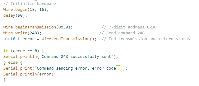

You can also control the following functions by sending other instructions to the microcontroller:
- It means sending the 248 command to the microcontroller (0x30) to instruct the speaker to turn on.

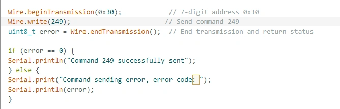

- It means sending the 249 command to the microcontroller (0x30) to instruct the speaker to turn off.

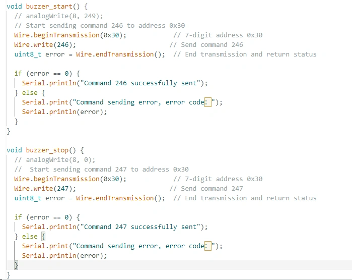

- You can also send command 246 to control the buzzer to turn on, and send command 247 to control the buzzer to turn off.
