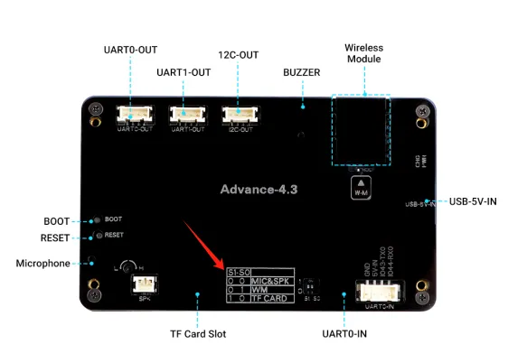

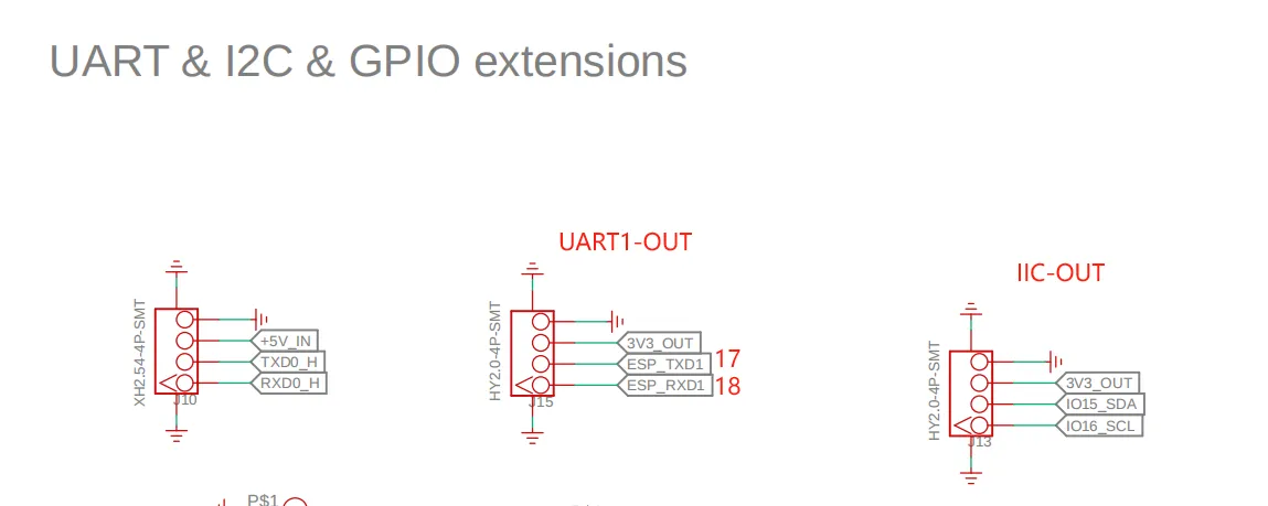

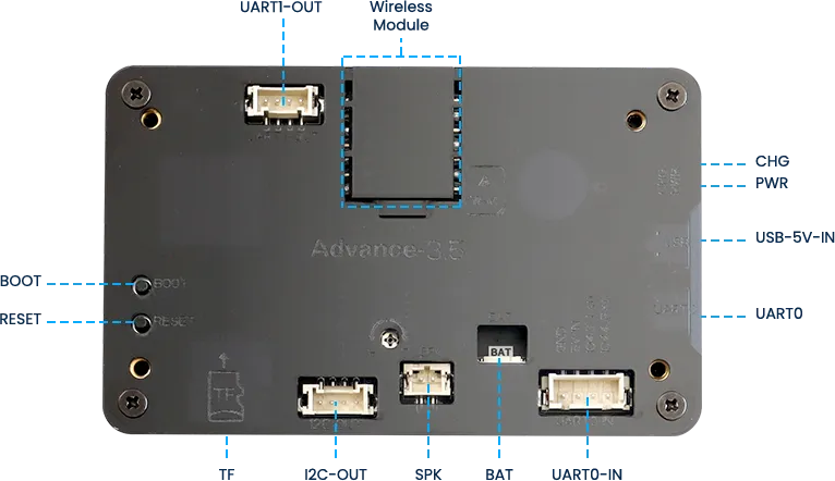

USB interface: used for power supply, serial communication, and automatic programming.
UART0-IN interface: supports power supply, serial communication, and entering manual burning mode by pressing BOOT+RESET; Other functions are consistent with the USB interface.
UART0-OUT interface: used for external power supply and serial communication.
UART1-OUT interface: uses soft serial port and supports configuring IO function.
I2C-OUT interface: connects RTC chip, extended IO chip (for screen backlight, touch screen reset, power amplifier pin control) and wireless module, only supports I2C communication.
1_2
When using the UART1-OUT interface, please set the switch dial to 0 1 mode, as the wireless module and the UART1-OUT line are controlled together. (For 4.3 size, 5.0 size, 7.0 size)
1_2_1

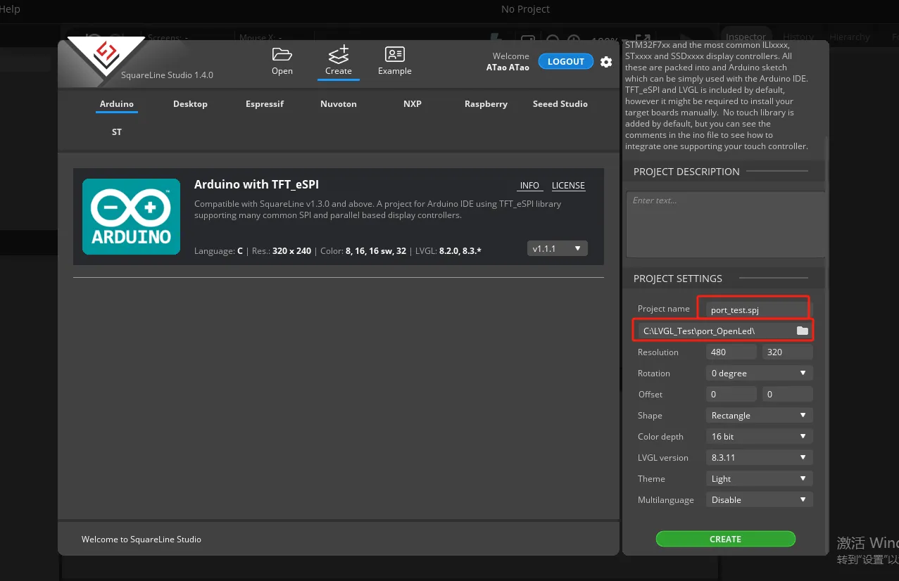

Open SquareLine Studio. If you haven't installed it, you can review the introduction of LVGL in Lesson 3.
1_4

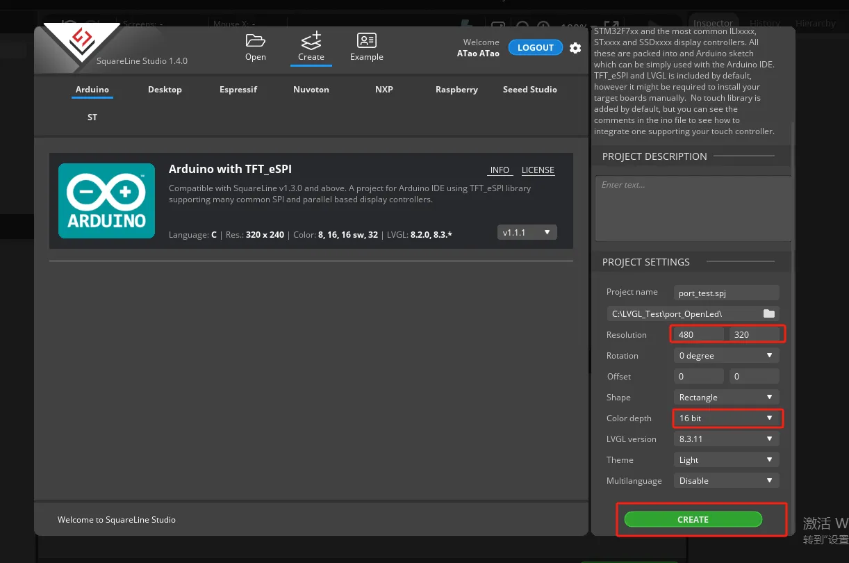

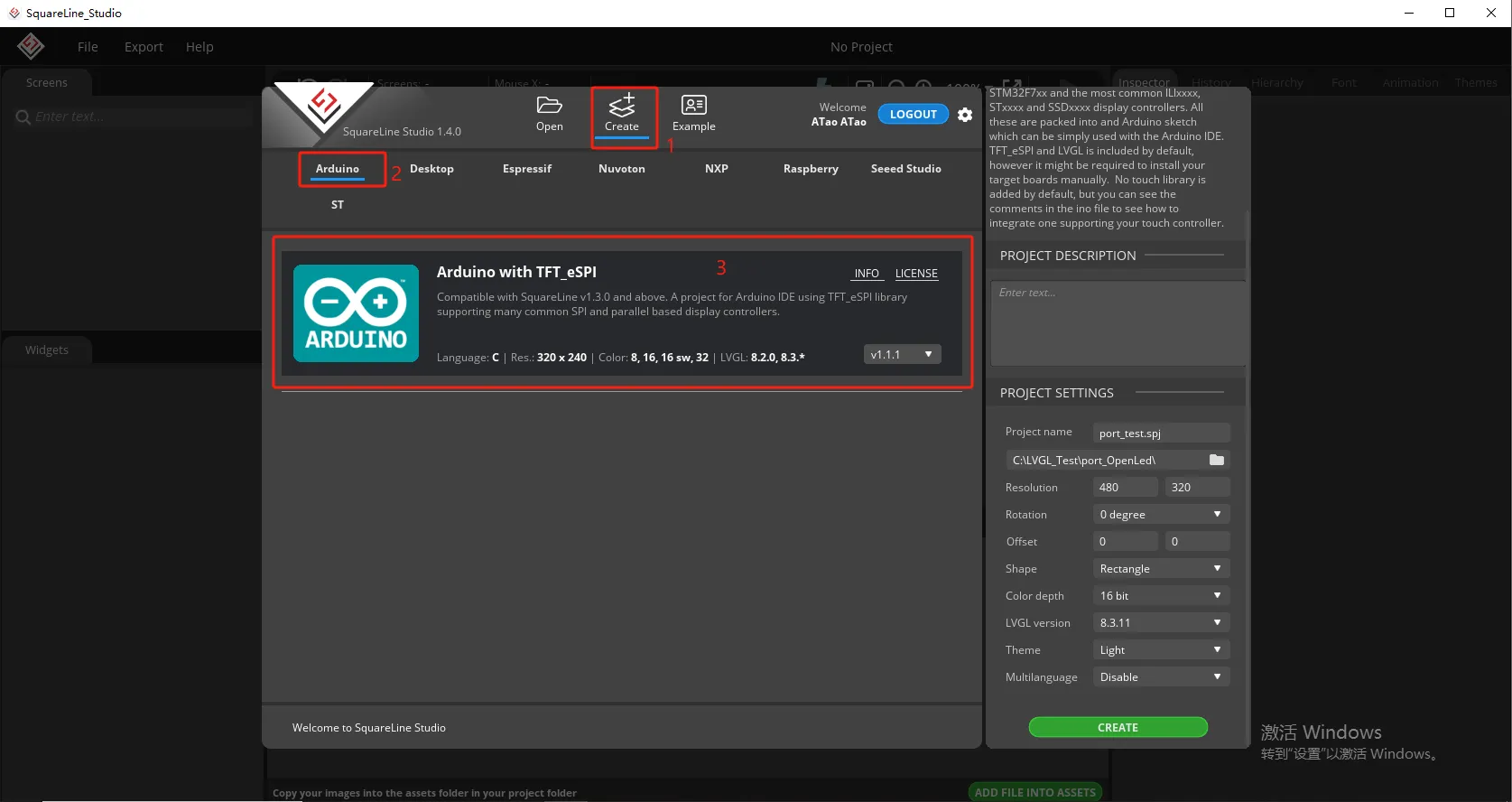

Create Arduino project
1_5
Modify the file name and file storage path according to your needs (customization is sufficient)
1_3
Modify the appropriate resolution based on the different sizes you are using.
Finally, click on 'Create' to proceed.

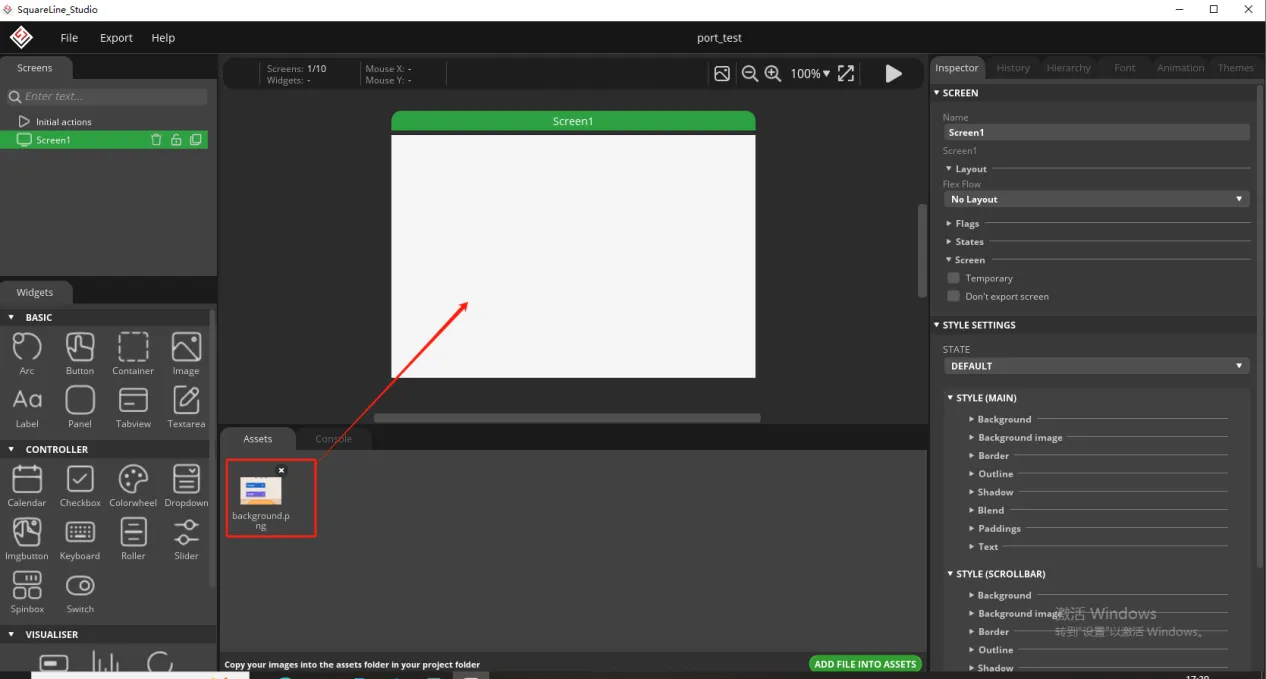

1_7

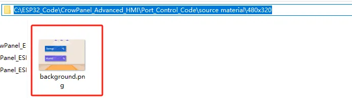

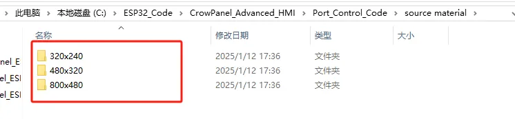

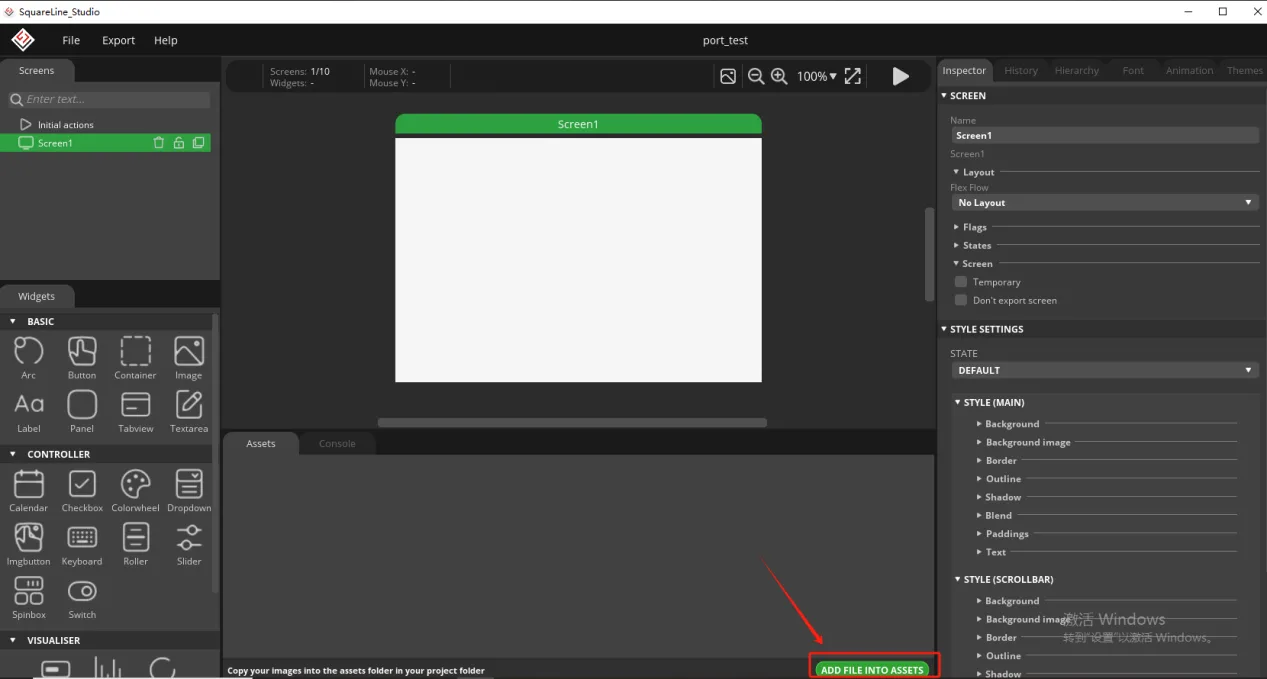

Add the background image we provide based on the resolution required for the size you are using (choose different resolutions for different sizes, refer to the resolution size used for different sizes in Lesson 3)
Click the link below to download the supporting images for this lesson. Resource link:
CrowPanel-Advance-5-HMI-ESP32-S3-AI-Powered-IPS-Touch-Screen-800x480/example/V1.1/arduino_example_code_1.1/V1.1/lesson-05/source material at master · Elecrow-RD/CrowPanel-Advance-5-HMI-ESP32-S3-AI-Powered-IPS-Touch-Screen-800x480
1_7_1

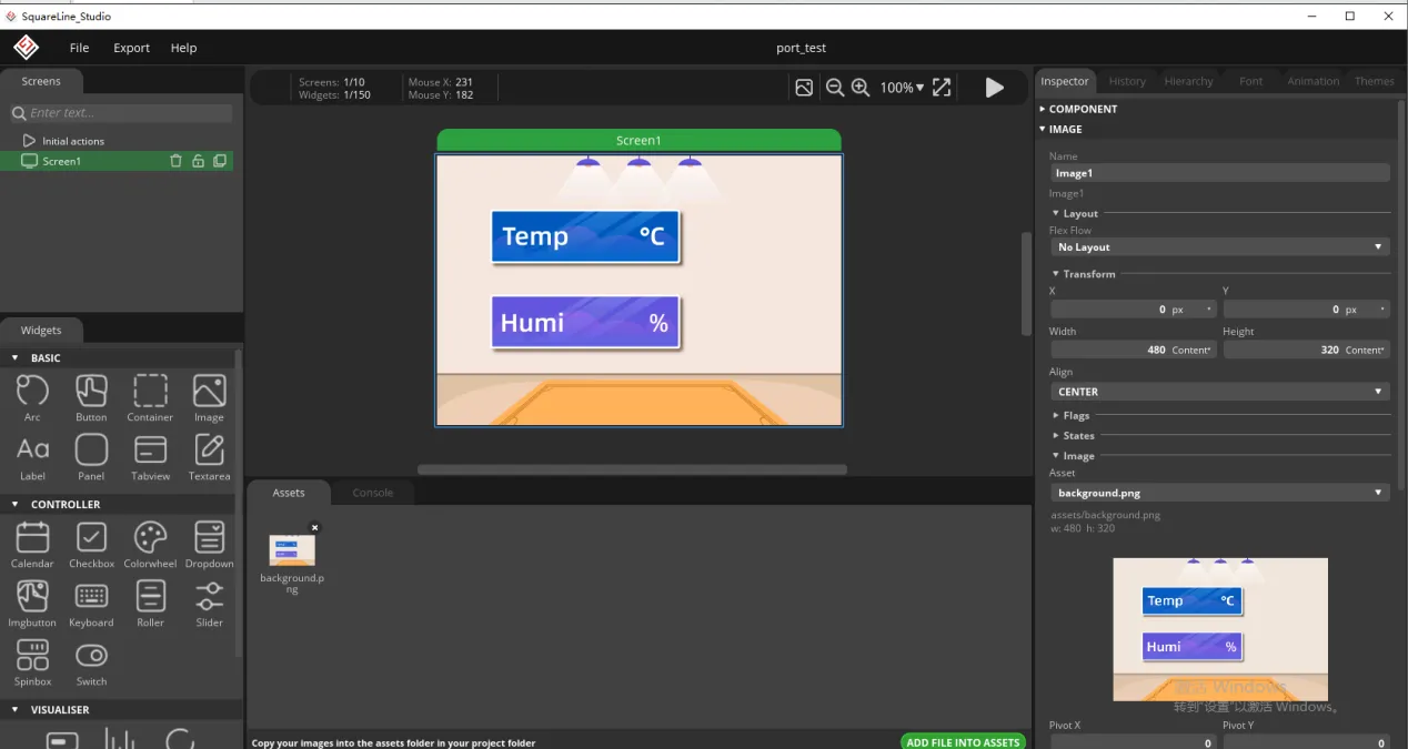

Add background image to the box.
1_11
1_13

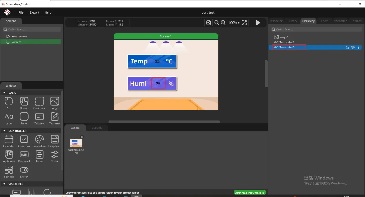

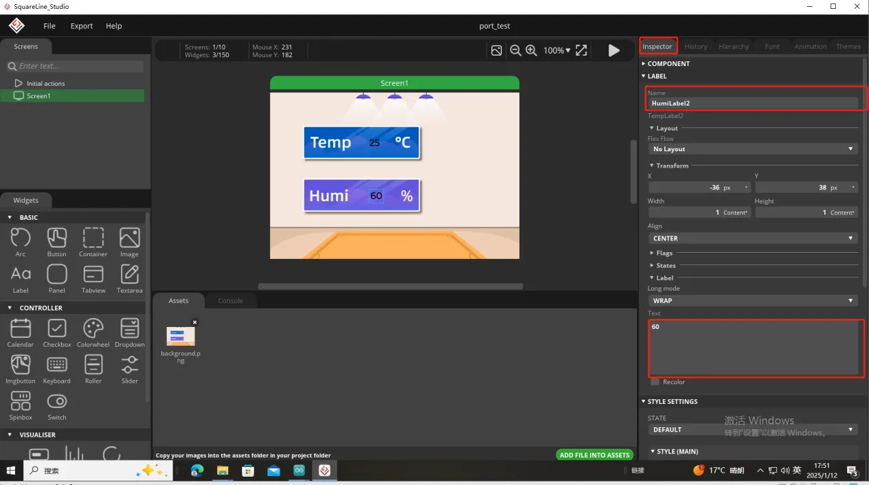

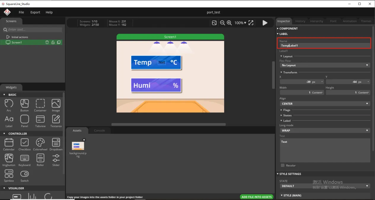

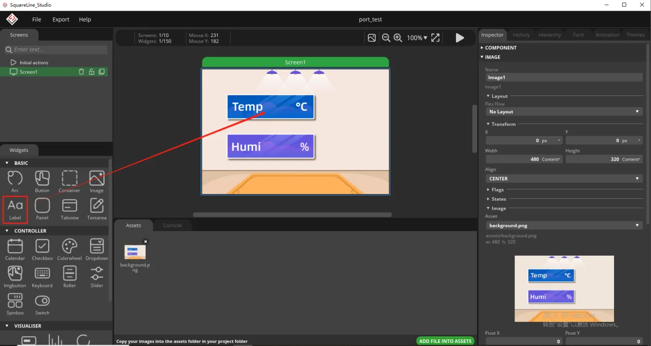

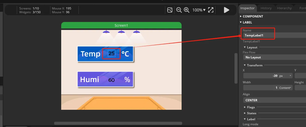

Since we need to display the temperature and humidity values on the screen, we need to add text in the two boxes for temperature and humidity.
1_16
To distinguish between the other text labels that need to be created next, give this label a name to distinguish it.
1_14
And fill in a default temperature value
1_15

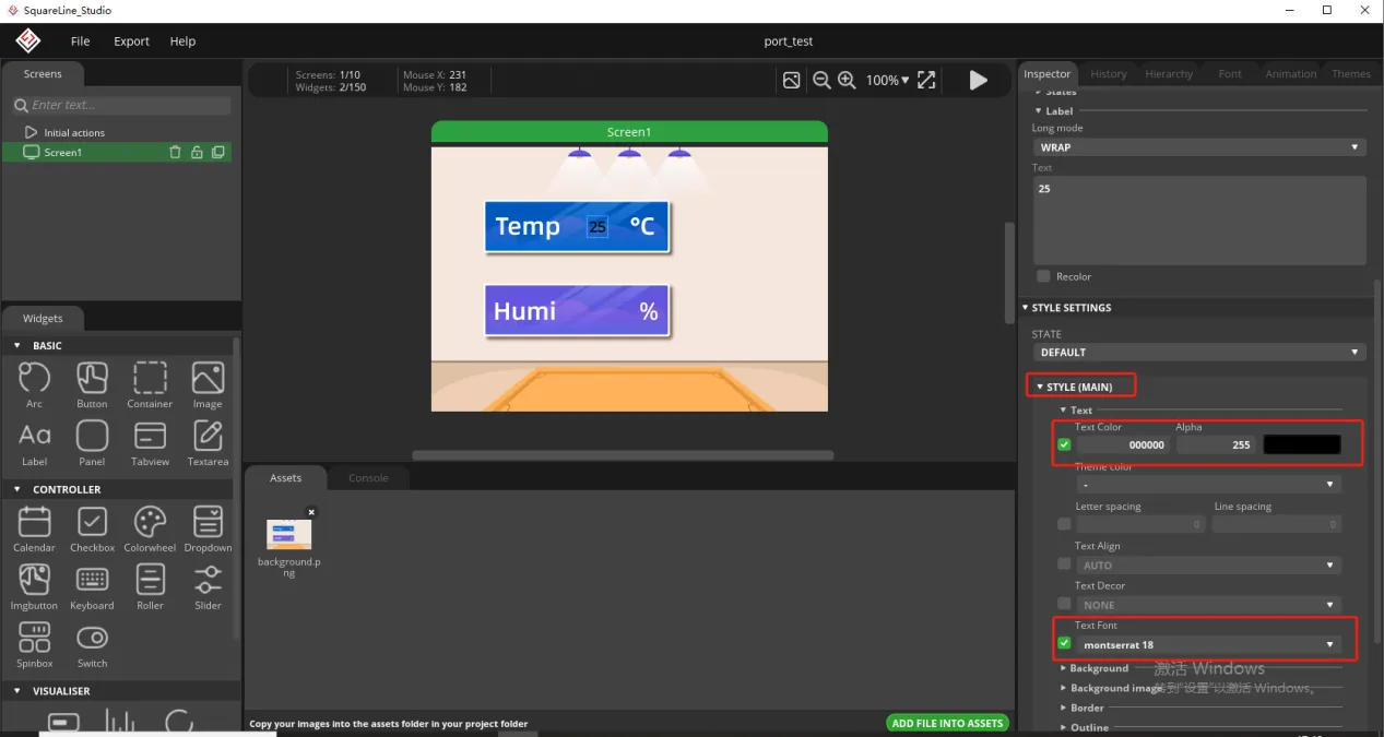

Of course, you can also set the font color and font size here
1_18

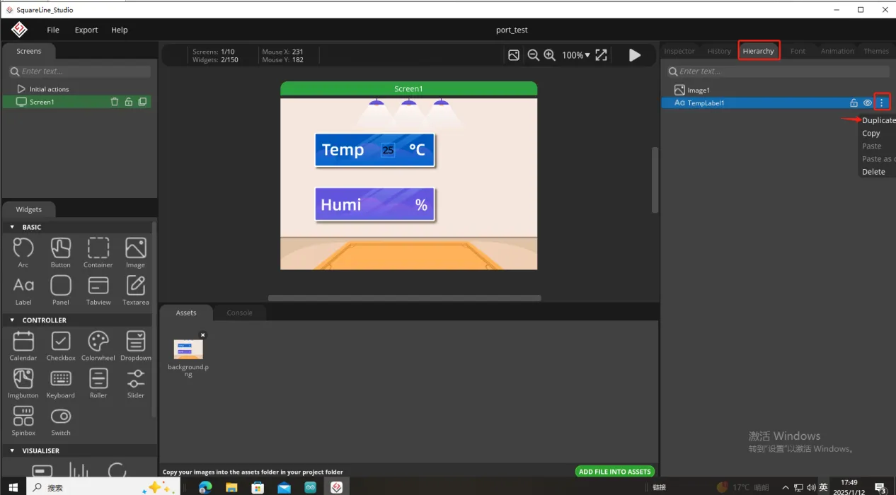

Copy the label just made and display the humidity value
1_20
1_17
Follow the above steps to modify the humidity label
1_19

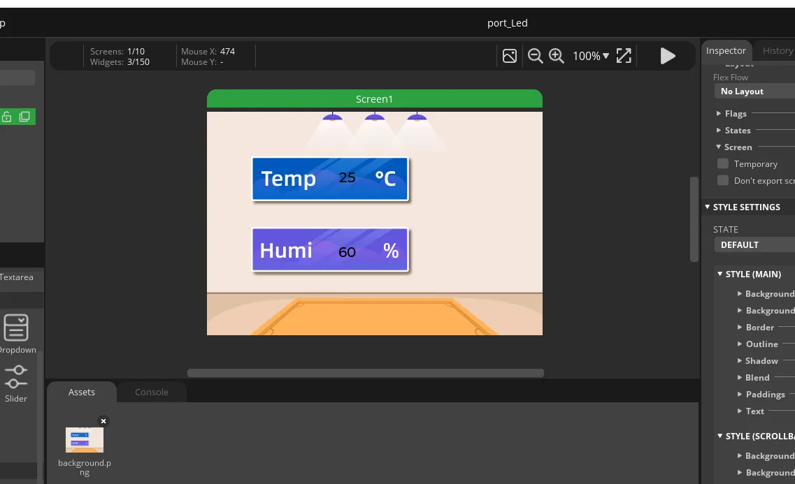

In this way, the display of temperature and humidity is completed.
So, the UI interface we need is completed.

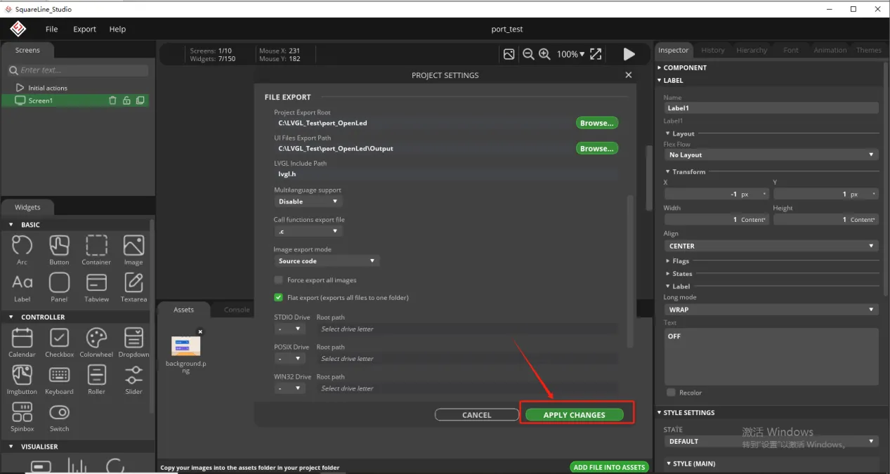

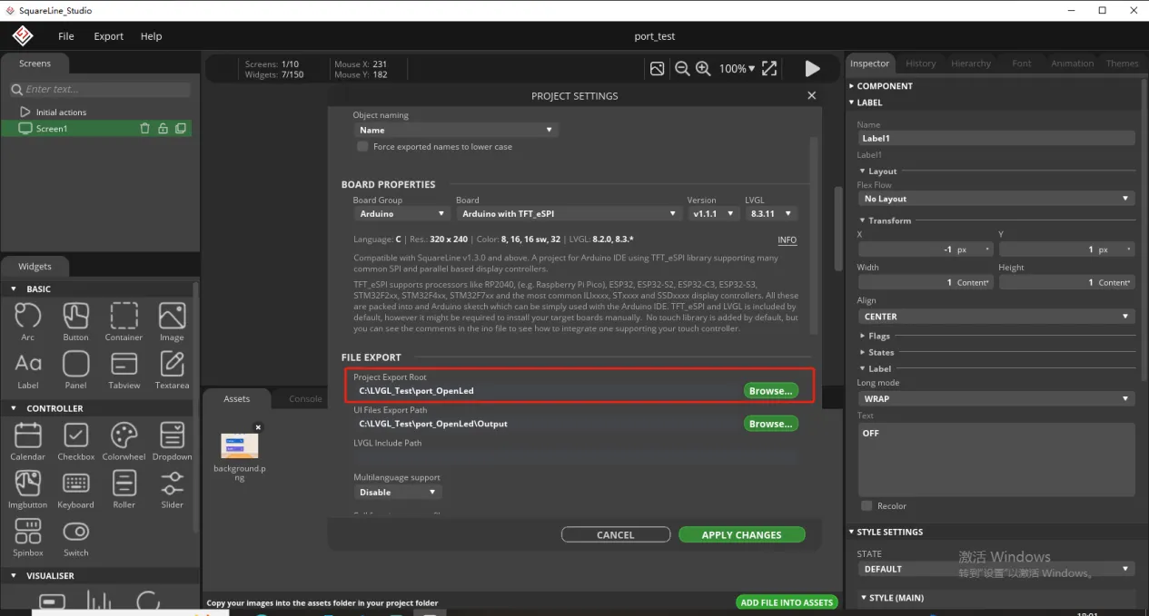

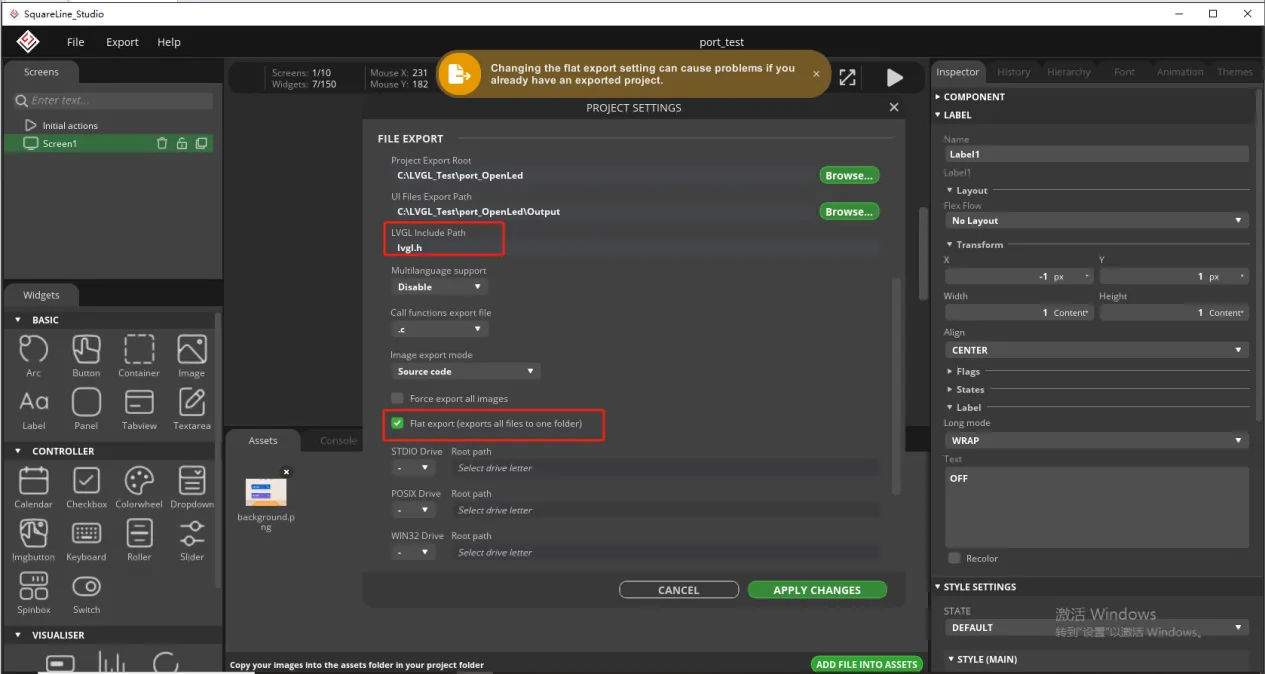

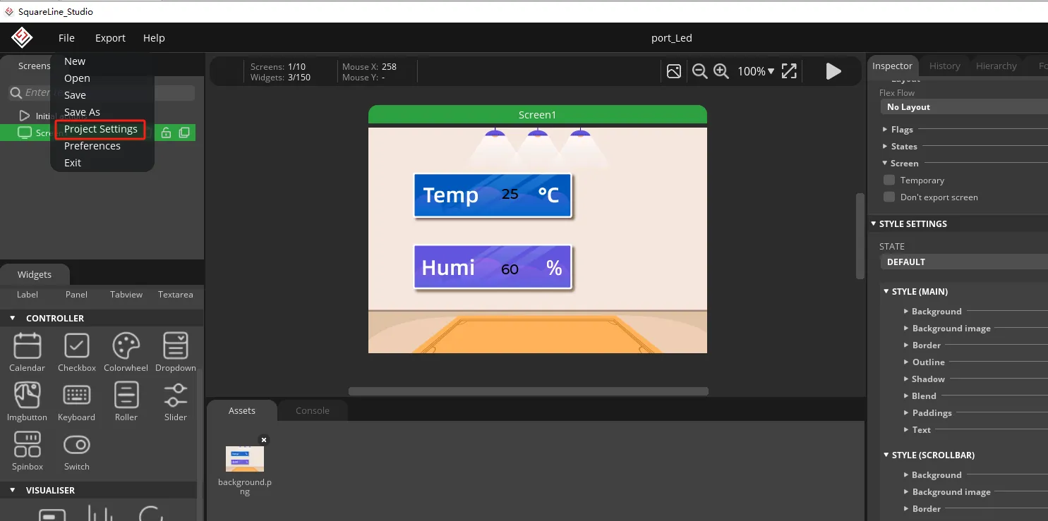

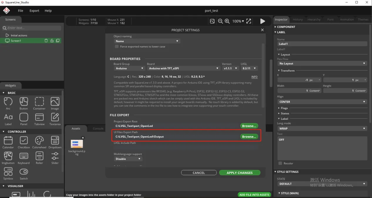

Click on Project Setting
1_24
Set the file export path and customize the path
1_21
But here, you need to create an Output folder in the path above to receive the exported UI files.
1_23
Fill in lvgl. h and select Flat export.
1_26

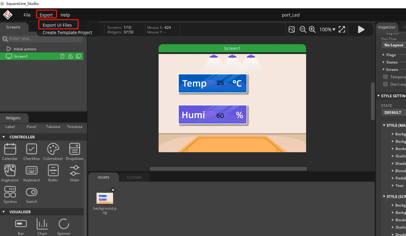

Finally confirm the settings
1_28

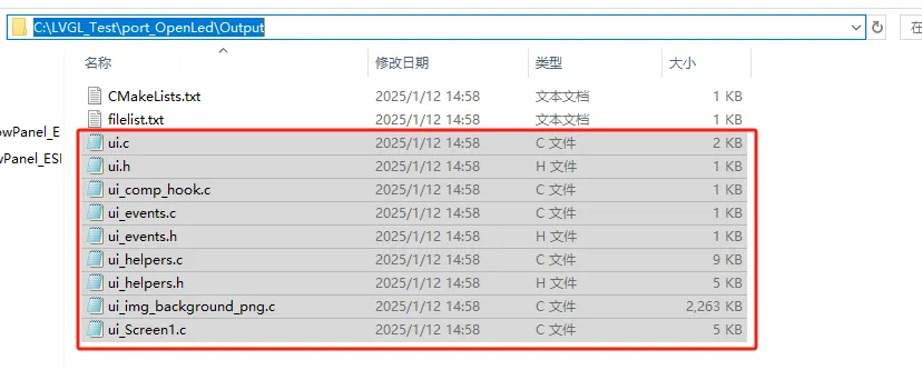

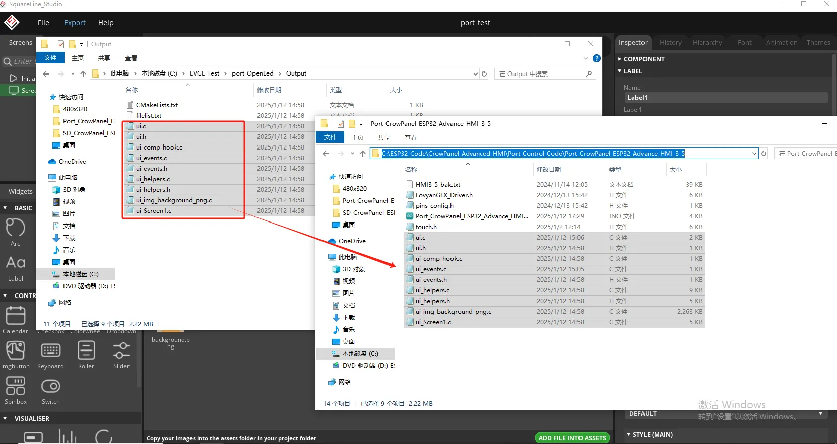

Export the designed UI interface file
1_25

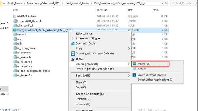

Go to the Output folder you just set up and copy the UI files you generated.
1_27

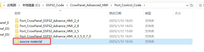

Paste it into the code file you need to open (here I will introduce the 3.5-size code as an example).
1_29

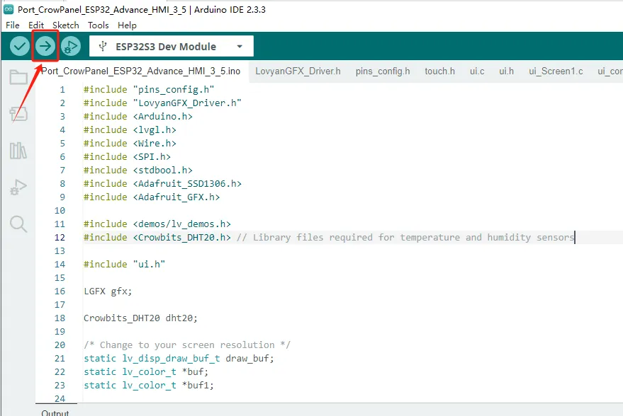

Then use Arduino IDE to open the ino file in the folder
1_30

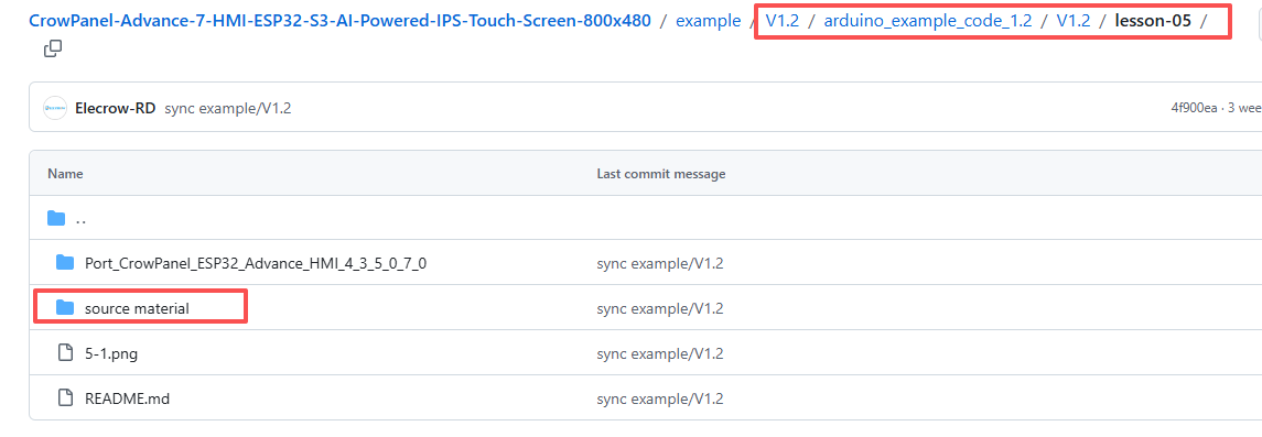

Click the link below to download the complete code for this lesson. Code link:
CrowPanel-Advance-5-HMI-ESP32-S3-AI-Powered-IPS-Touch-Screen-800x480/example/V1.1/arduino_example_code_1.1/V1.1/lesson-05/Port_CrowPanel_ESP32_Advance_HMI_4_3_5_0_7_0 at master · Elecrow-RD/CrowPanel-Advance-5-HMI-ESP32-S3-AI-Powered-IPS-Touch-Screen-800x480

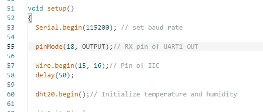

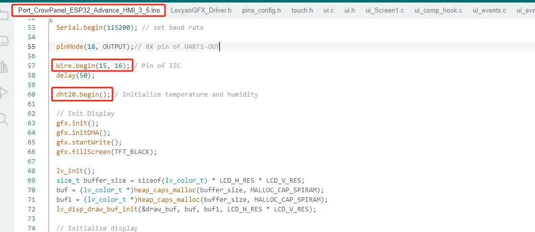

Initialize UART1-OUT pin, IIC pin, and temperature and humidity sensor
1_33

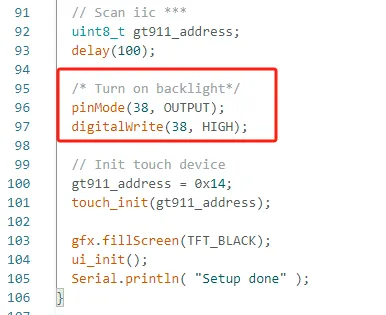

Turn on the screen backlight to enable the screen to display
1_31

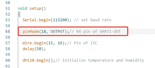

Previously, pin 18 was set as the output mode, and the UART1-OUT interface was connected to the light bulb. By controlling pin 18, the light can be controlled.
The brightness and darkness of bubbles.
1_32

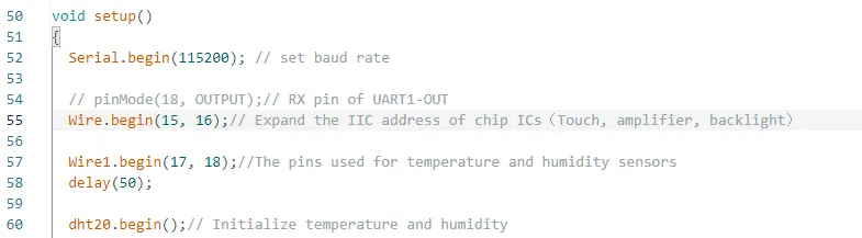

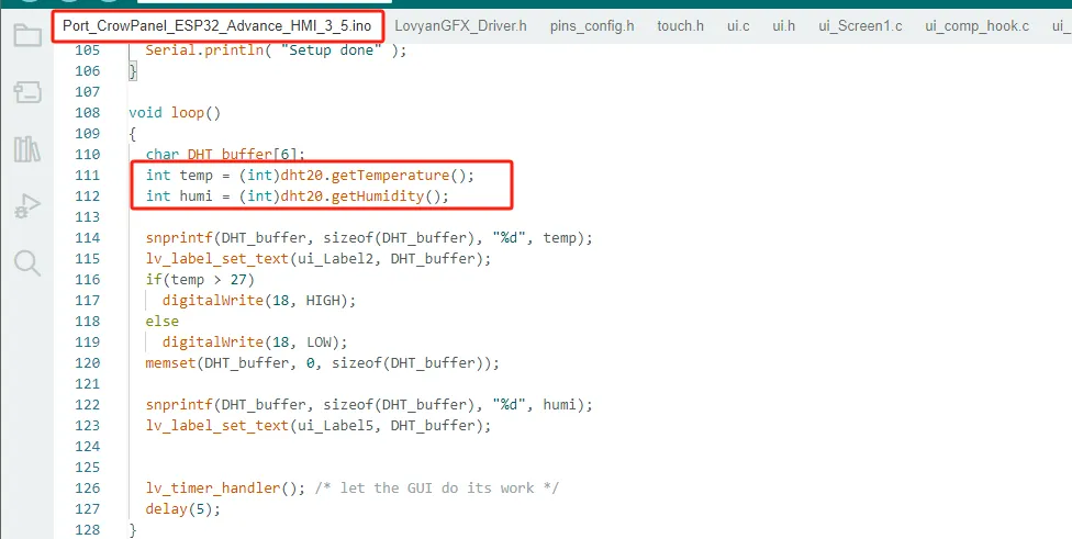

Because the temperature and humidity sensor is connected to the IIC interface, it is necessary to initialize pins 15 and 16 of the IIC and initialize the temperature and humidity sensor.
1_34

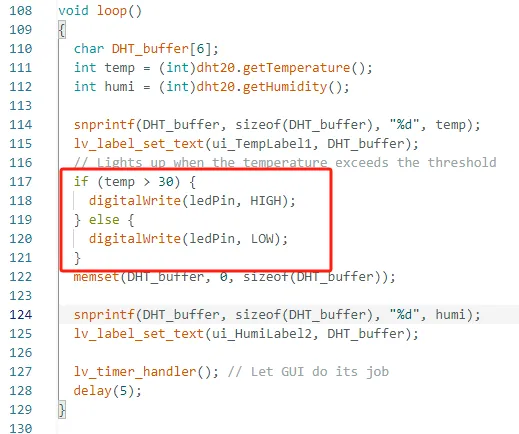

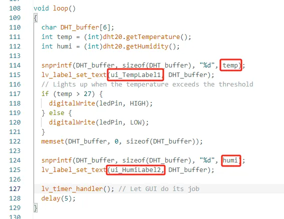

And define two variables to receive data collected by temperature and humidity sensors
1_36
And display the value on the label you previously designed
1_38
1_35
1_37
If the temperature value collected by your temperature and humidity sensor exceeds 30 ℃, the light bulb will automatically light up; If the temperature drops below 30 ℃, the light bulb will automatically turn off. (You can modify the temperature threshold yourself, this is only for the convenience of observing the results)

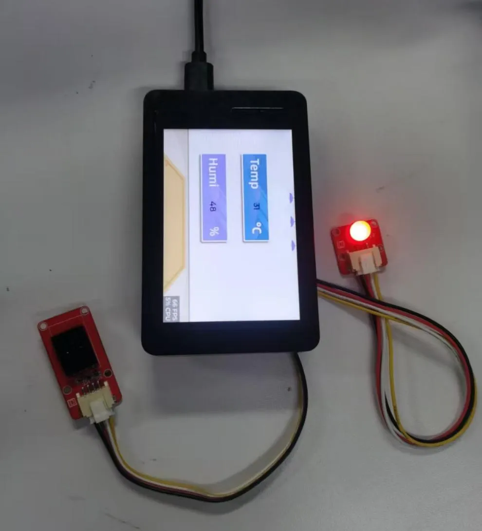

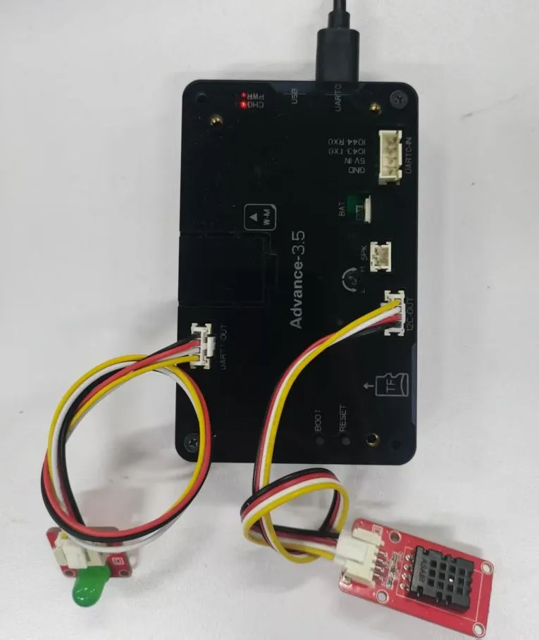

4 Hardware connection
UART1-OUT connection bulb
IIC-OUT connection to DHT20 temperature and humidity sensor

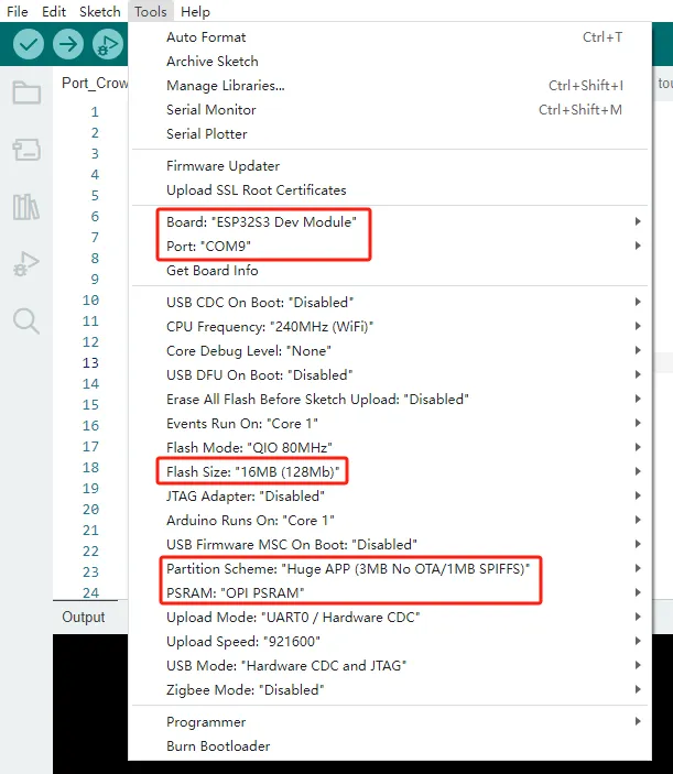

5 Configure the environment, upload code, and view phenomena
(Before uploading the code, please replace the relevant library files. Please refer to Lesson 2 for instructions on how to replace them.)
Configure the operating environment according to the guidance.
1_43
Upload code
1_46

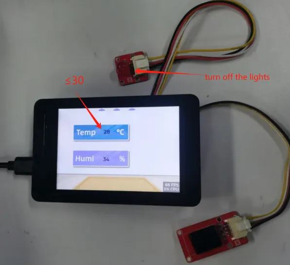

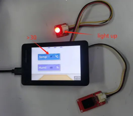

Phenomenon display
1_48
1_45
1_47

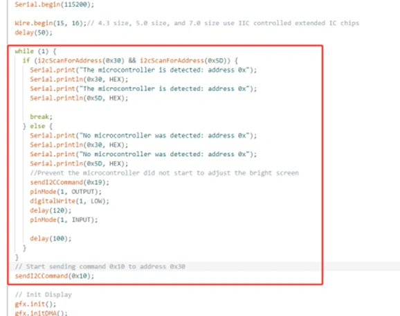

In terms of hardware, we use a microcontroller (STC8H1K28) to control the screen backlight and the mute function of the speaker.
advance-1.2-new
(However, there are other function interfaces that need to be written in the specific code, and you can refer to the complete code provided later.)
Explanation:
  • 0x30 is the I2C address of the microcontroller (STC8H1K28).
  • 0x5D is the I2C address of the touch IC (GT911).
  • sendI2CCommand(0x10) means sending the 0x10 command to the microcontroller (0x30) to instruct the microcontroller to set the screen brightness to maximum.
(For 0x10 mentioned above, you can replace it with the following values:
  • 0x05: Turn off the screen
  • 0x06 to 0x10: The screen brightness will gradually increase to the maximum)
**To set a different brightness level, you must first send 0x10 to turn on the screen, and then send another value to adjust the brightness. **
