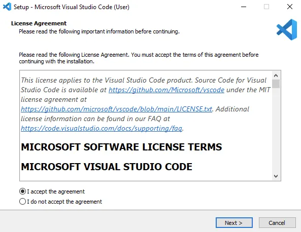

Accept the license agreement and go next.
get-started-with-platformio-3(1)

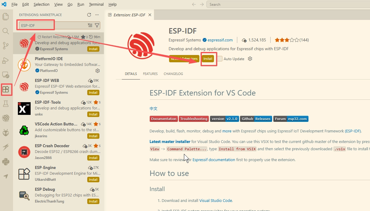

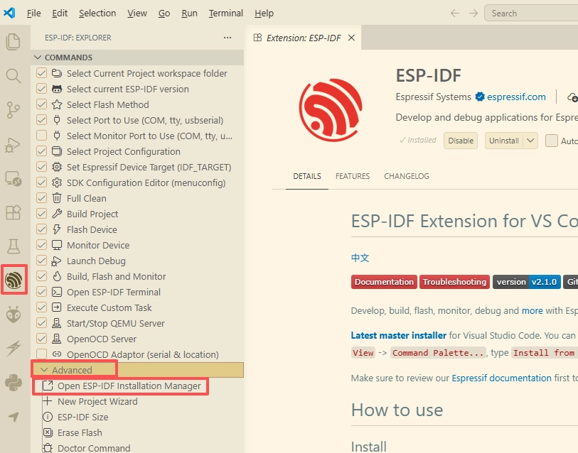

Search for 'ESP-IDF' and install
After ESP-IDF is installed, launch the ESP-IDF Tools Manager

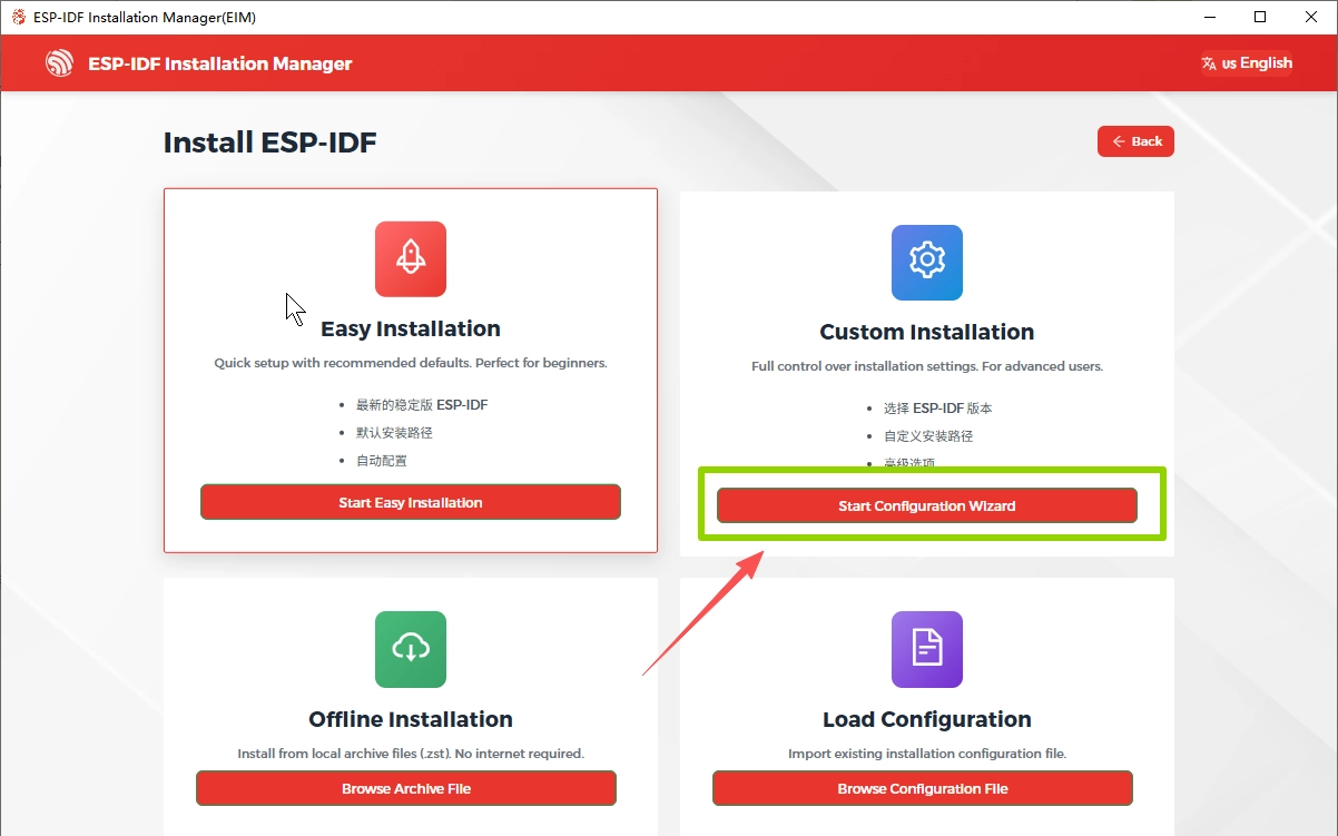

Select Custom Installation
3

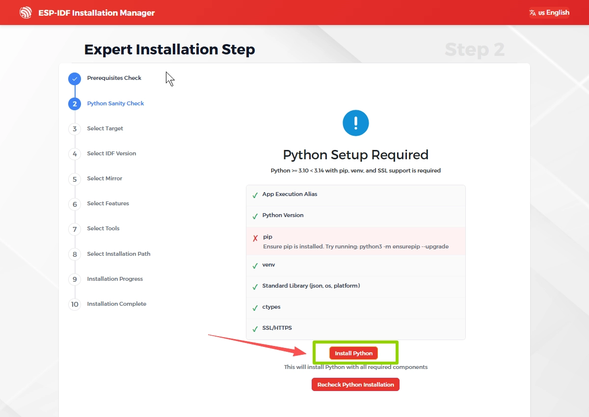

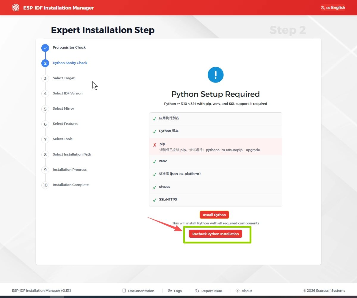

After entering, the installer will automatically check whether your system meets the requirements for installing ESP-IDF. If any required components are missing, click ‘Install Python’ to install the necessary environment
4
After the installation is complete, click it again to recheck whether the environment meets the requirements
4

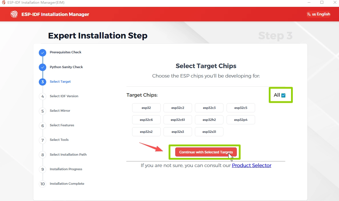

Select Target Chips
4

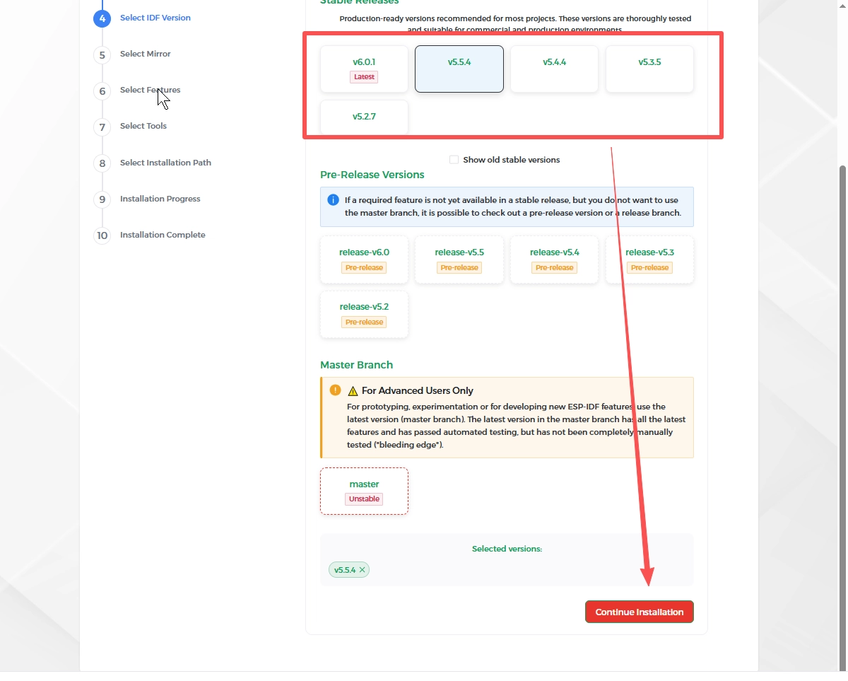

Select the ESP-IDF version (please choose the version required by your course)
4

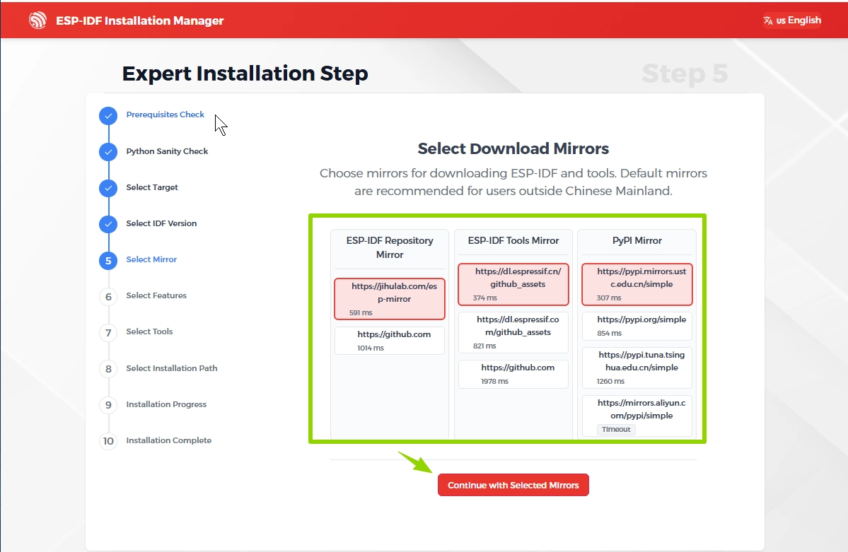

Select Download Mirrors
4

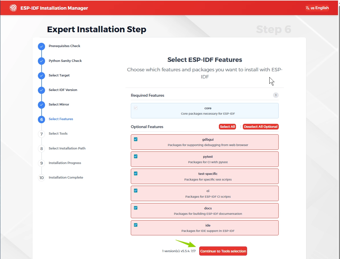

Select ESP-IDF Features
4

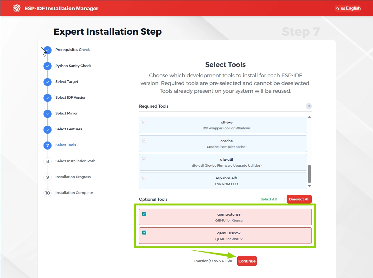

Select Tools
4

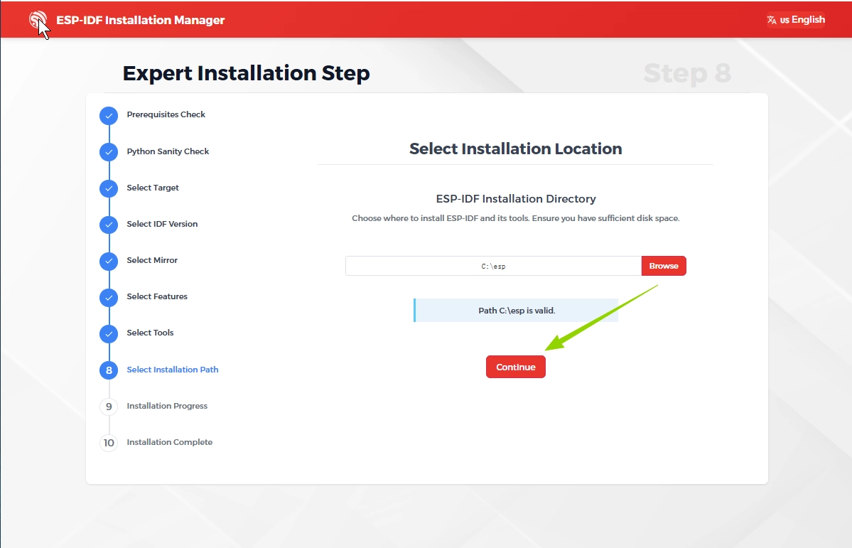

Select Installation Location
4

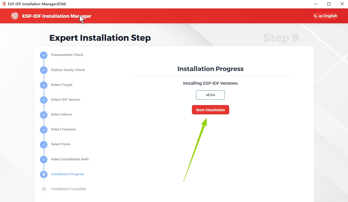

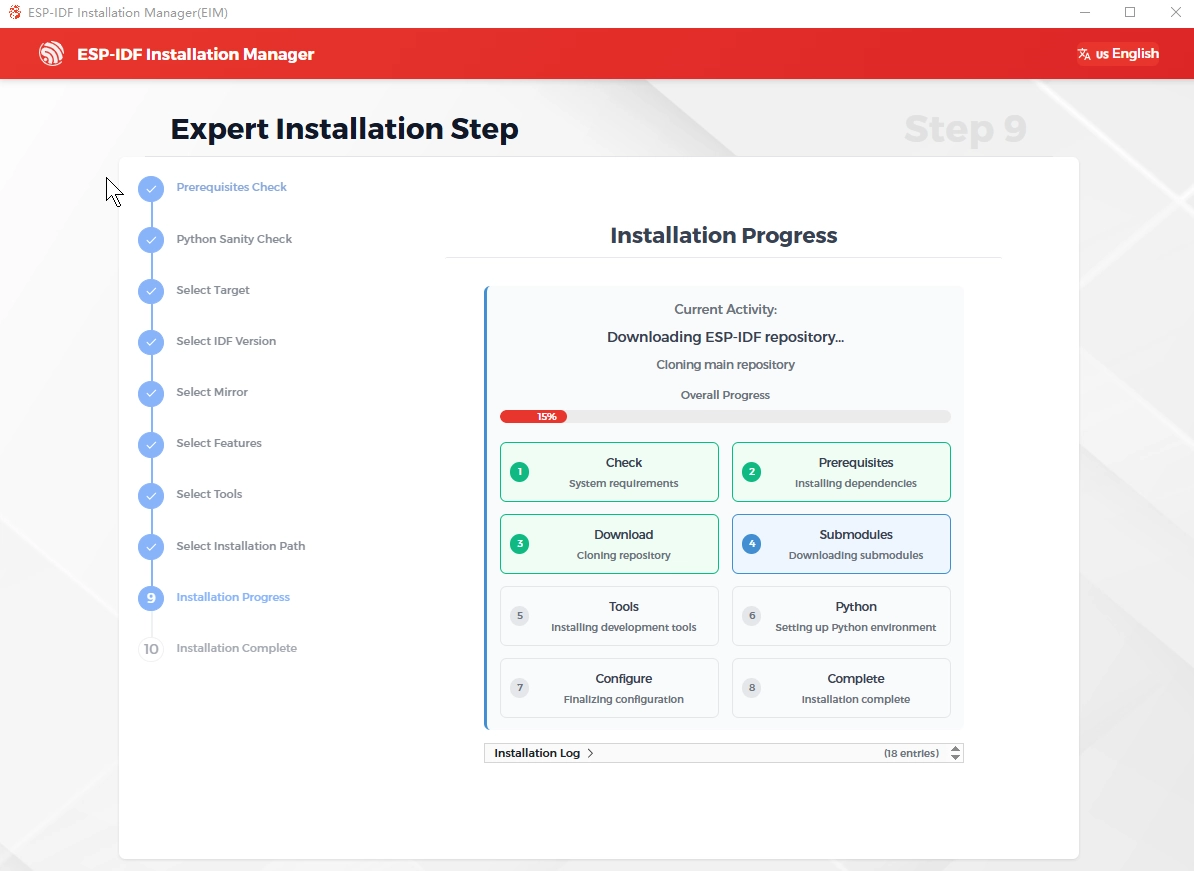

Installation progress
4

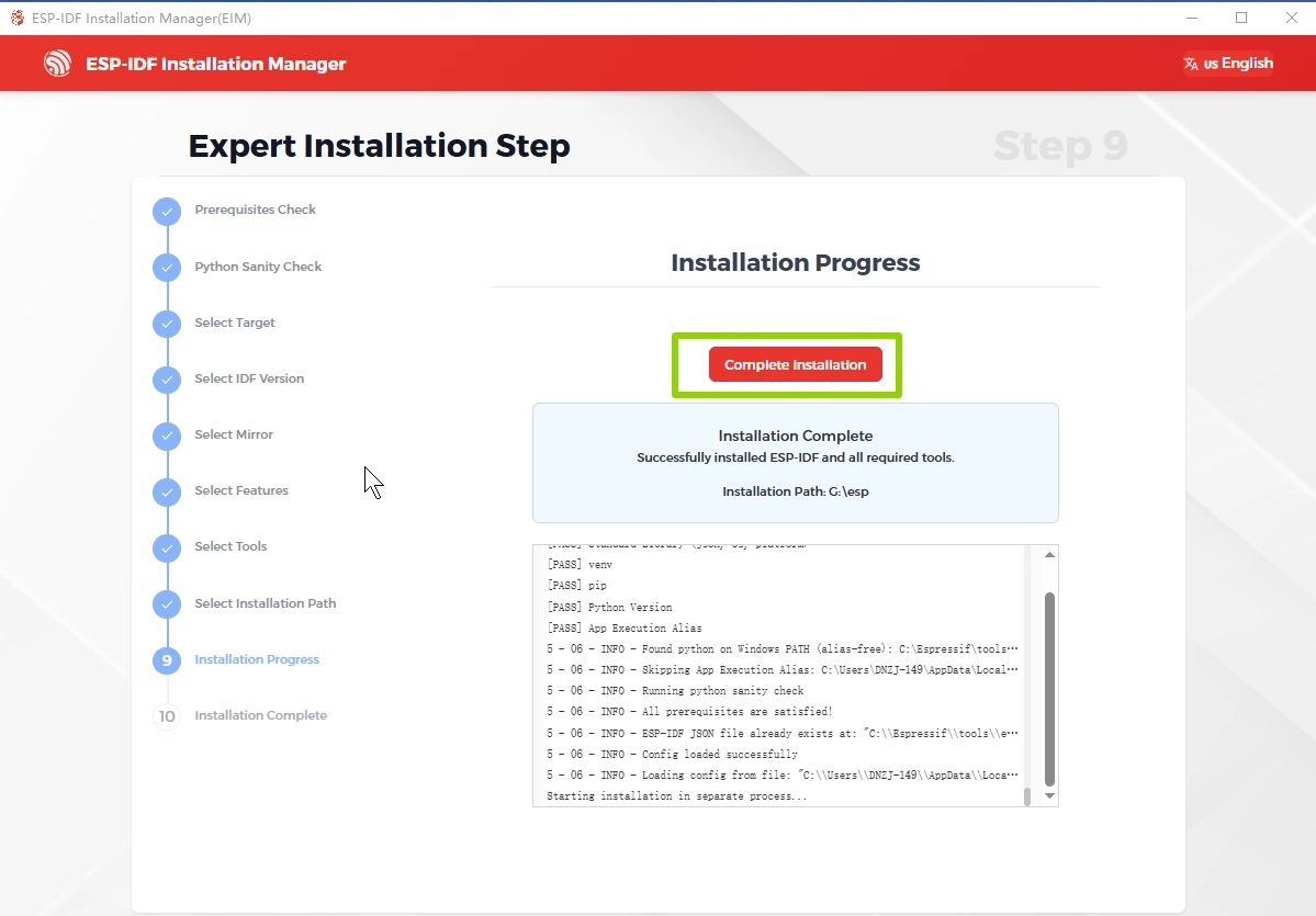

4
4
