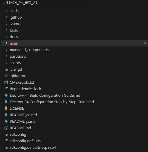

Open the ESP-IDF extension panel in VS Code, click Open ESP-IDF Project, and select the 5inch_P4_HMI_AI folder. After the project opens, confirm that the Explorer root directory contains CMakeLists.txt, main, managed_components, partitions, and sdkconfig.
Do not open only the main subdirectory, otherwise ESP-IDF will be unable to load the full component dependencies and project configuration.
Open the 5-inch project

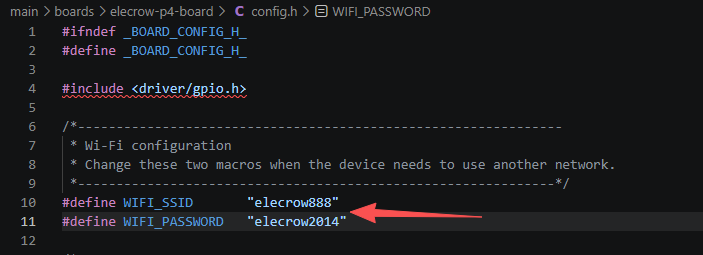

However, during use, you need to change the network in this project to your own network environment.

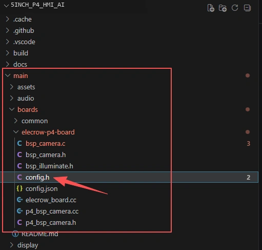

Open main->boards->elecrow-p4-board->config.h
Open the network configuration file
Just modify the Wi-Fi name and password inside to your own.
Modify the default Wi-Fi

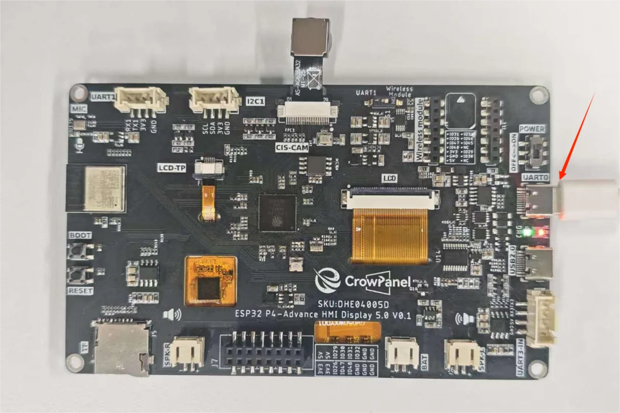

Before connecting the USB power, confirm that the development board is powered off.
Check that the MIPI CSI camera flex cable is oriented correctly, that the gold fingers are fully inserted into the connector and the latch is firmly secured, and at the same time confirm that the LCD flex cable, microphone, speaker, and Wi-Fi antenna (if required by the current model) are securely connected. Hot-swapping the camera flex cable while powered on is prohibited.

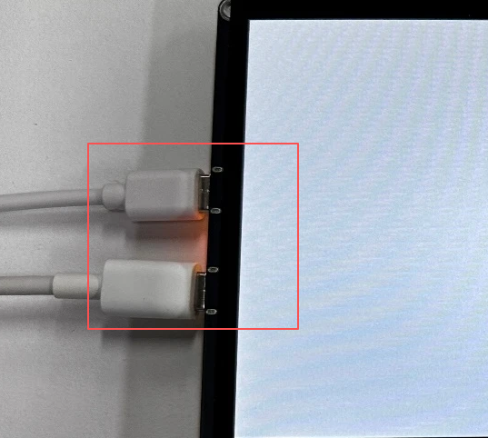

Connect the ESP32-P4 development board to the PC using a USB cable that supports data transfer, and confirm that the power indicator lights up and the serial port can be recognized by VS Code.
P4_5inch_AI_16
This project requires a lot of hardware, so be sure to provide the ESP32-P4 development board with sufficient power.
Provide stable power to the development board
