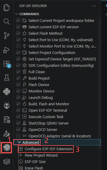

After the installation is complete, we enter ESP-IDF, select "Configure ESP-IDF Extension", and get ready to download the version of ESP-IDF for use.

After entering, select [EXPRESS].
Note: Select version v5.1.1.
Follow the instructions in the red box in the picture step by step to make your choices.
