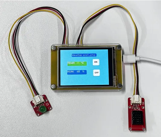

The example tutorial is an environmental monitoring project, demonstrate how to create a UI and use a DHT20 sensor to obtain the environment temperature and humidity and display it on the screen; and how to control the LED on and off by the buttons on the screen.
In this tutorial, we will show you how to design the UI with SquareLine Studio, and show you how to upload the code with Thonny IDE.

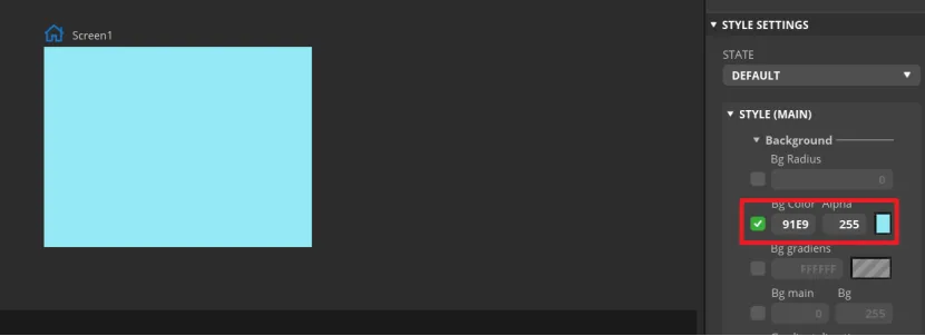

  4. Add background.
    Find "Inspector"->"STYLE SETTING", click to expand "STYLE(MAIN)", then click the 1st "Background". Check the "Bg ColorAlpha" and set the backgroud color.
    SLS-UI-4

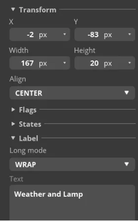

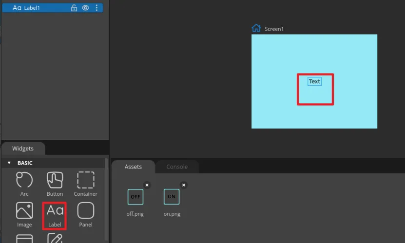

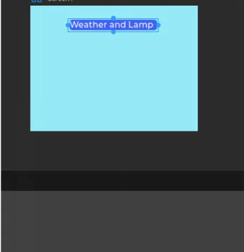

  5. Add Label widget
    SLS-UI-5
    The content, position and size of the label can be adjusted by dragging the mouse. You can also directly enter numbers in the Inspector→LABEL→Transform to adjust. You can set the font color and other attributes in STYLE SETTING→STYLE(MAIN).
    Modify the text of Label1 as the title of the screen.
    SLS-UI-6SLS-UI-7

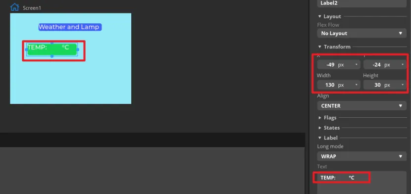

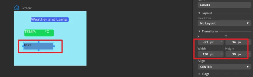

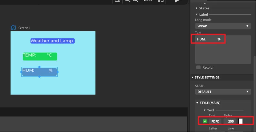

    Add Label2 and Label3 as labels for temperature and humidity in the same way.
    SLS-UI-8
    SLS-UI-9
    SLS-UI-10

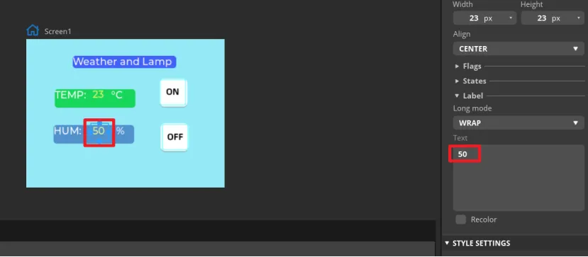

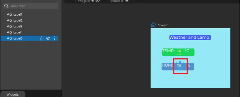

    Add Label4 and Label5 to display the values of temperature and humidity
    SLS-UI-11
    After all Labels are added, you can set the default display value of the Label.
    Defualt-label

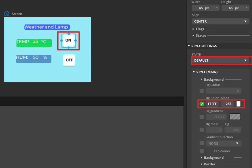

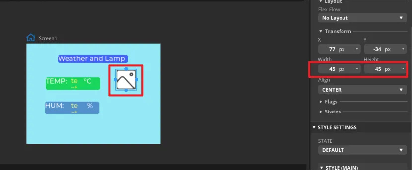

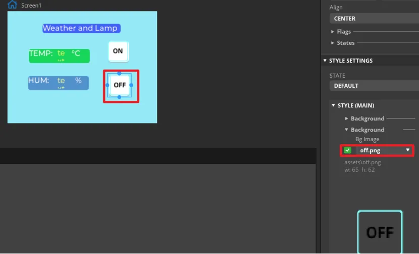

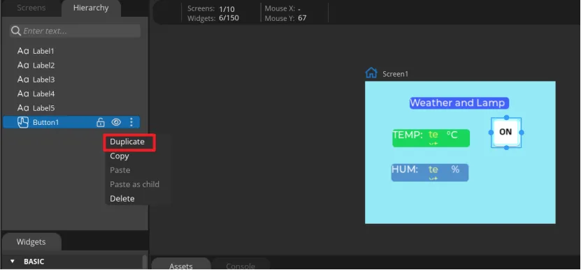

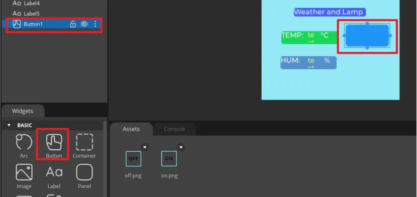

  6. Add Button widget to control the LED.
    SLS-UI-12
    SLS-UI-13
    SLS-UI-14

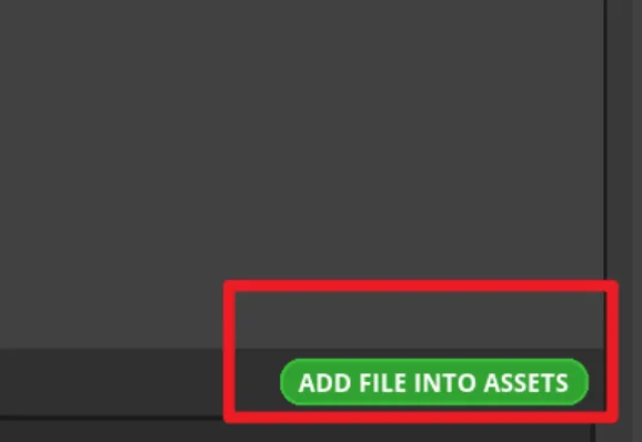

    If you there are no pictures available, please click "ADD FILE TO ASSETS" to add custom images or icons in the "Assets" area.
    SLS-UI-15
    Please click download to download the custom images for the button.
    Because UI files require a large amount of memory when running in Thonny IDE, the UI main page background in this tutorial does not use images to avoid being unable to run.
    SLS-UI-16
    SLS-UI-17
    SLS-UI-18
    SLS-UI-19

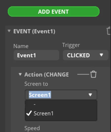

  7. Add events to buttons.
    SLS-UI-20
    SLS-UI-21
    SLS-UI-22

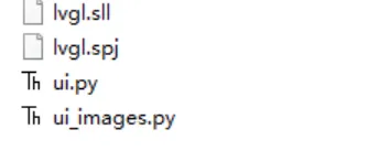

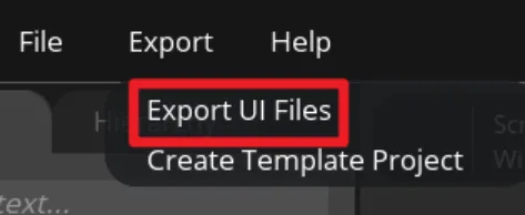

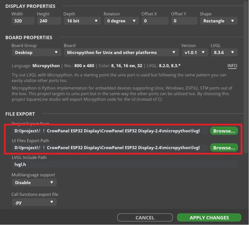

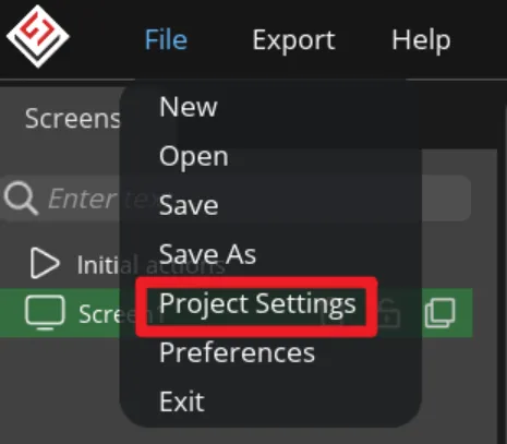

  8. Export UI files.
    SLS-UI-23
    SLS-UI-24
    Then click "APPLY CHANGES".
    SLS-UI-25
    SLS-UI-26
The UI file export is completed. Next we're going to learn about the main program and learn how to upload the code to the board with Thonny IDE.

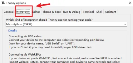

Upload firmware
  1. Connect the CrowPanel ESP32 HMI with your computer.

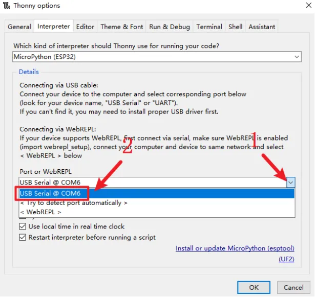

  2. Open Thonny IDE and click "Tools"->"Options"->"Interpreter".
  3. Select "MicroPython(ESP32)" for interpreter.
  4. Select the corresponding serial port(or Try to detect port automatically).
  5. Click "Install or update MicroPython (esptool)"
  6. Click the icon with 3 lines, and click "select local MicroPython image...".Select the "lv_micropython.v1.19.1-ili9341-xpt2046.bin" and install.

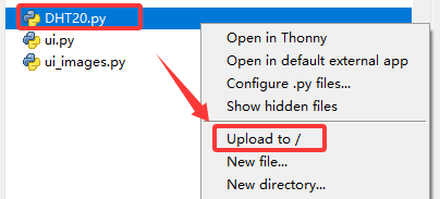

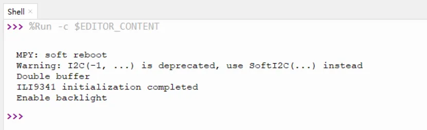

Edit the code

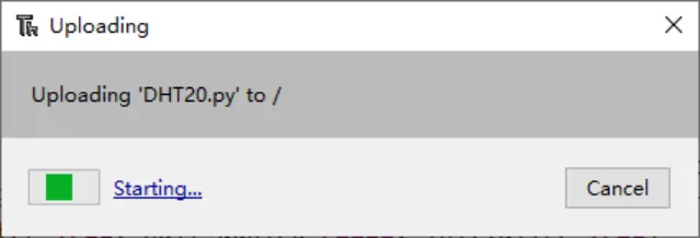

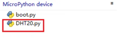

Please click download to download the code file and libraries.
import lvgl as lv

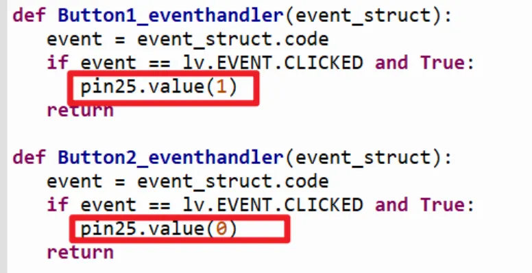

def Button1_eventhandler(event_struct):
   event = event_struct.code
   if event == lv.EVENT.CLICKED and True:
      pin25.value(1)
   return
def Button2_eventhandler(event_struct):
      pin25.value(0)
   return

This part copies the code of ui.py generated by Squareline Studio. We need to modify the part that control the button.
From
button-1
to
button-2
Temperature and humidity display

Upload the code
Upload the libraries
DHT20
  1. In the upper left corner of the thonny, enter the path where DHT20.py is located, right-click DHR20.py, and click Upload to/
  2. Waiting for uploading
  3. The DHT20.py will be added to the MicroPython device column.
ui_image.py
  1. In the upper left corner of the thonny, enter the path where ui_image.py is located, right-click ui_image.py, and click Upload to/
  2. ui_image.py is added to MicroPython device successfully.
Upload the code
Click the "run" icon.
Successfully uploaded.

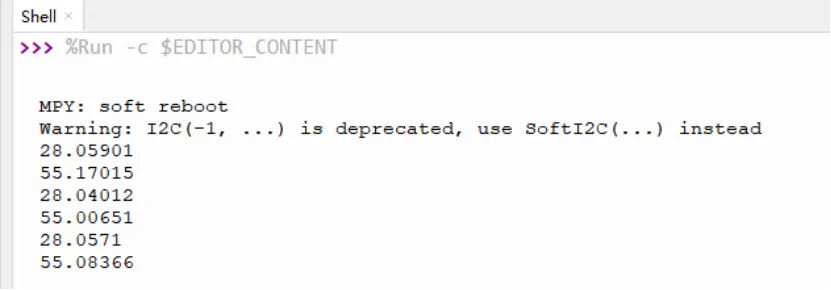

Example 3 Obtain temperature and humidity value
Plug DHT20 module to the IIC port. Add DHT20.py to the device(check the method in "Upload the libraries" section.) and upload the code below, the value of temperature and humidity will be printed.
import time
import DHT20
from machine import I2C, Pin
i2c = I2C(scl=Pin(21), sda=Pin(22))
sensor = DHT20.DHT20(i2c)
while True:
    sensor.read_dht20()
    print(sensor.dht20_temperature())
    print(sensor.dht20_humidity())
    time.sleep_ms(4000)
Example-DHT20

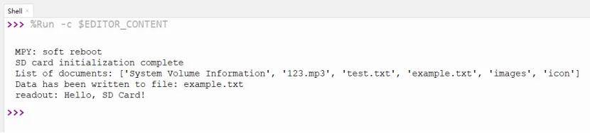

Example 6 Initialize SD card
Upload the following code to ESP32 HMI
import machine
import os
import sdcard
import uos
#  SD Card Initialization
def init_sd():
    # Creating SPI Objects
    spi = machine.SPI(2, baudrate=1000000, polarity=0, phase=0, sck=machine.Pin(18), mosi=machine.Pin(23), miso=machine.Pin(19))
    cs = machine.Pin(5, machine.Pin.OUT)
    sd = sdcard.SDCard(spi, cs)
    vfs = uos.VfsFat(sd)
    uos.mount(vfs, "/sd")
    print("SD card initialization complete")
    print("List of documents:", os.listdir("/sd"))
# write to a file
def write_file(filename, data):
    with open("/sd/" + filename, "w") as file:
        file.write(data)
    print("Data has been written to file:", filename)
# Read file
def read_file(filename):
    with open("/sd/" + filename, "r") as file:
        data = file.read()
    print("readout:", data)
    return data
# Example: Initialize SD card and read/write files
def main():
    init_sd()
    filename = "example.txt"
    data = "Hello, SD Card!"
    read_file(filename)
if __name__ == "__main__":
    main()
Running result:
SDCARD
