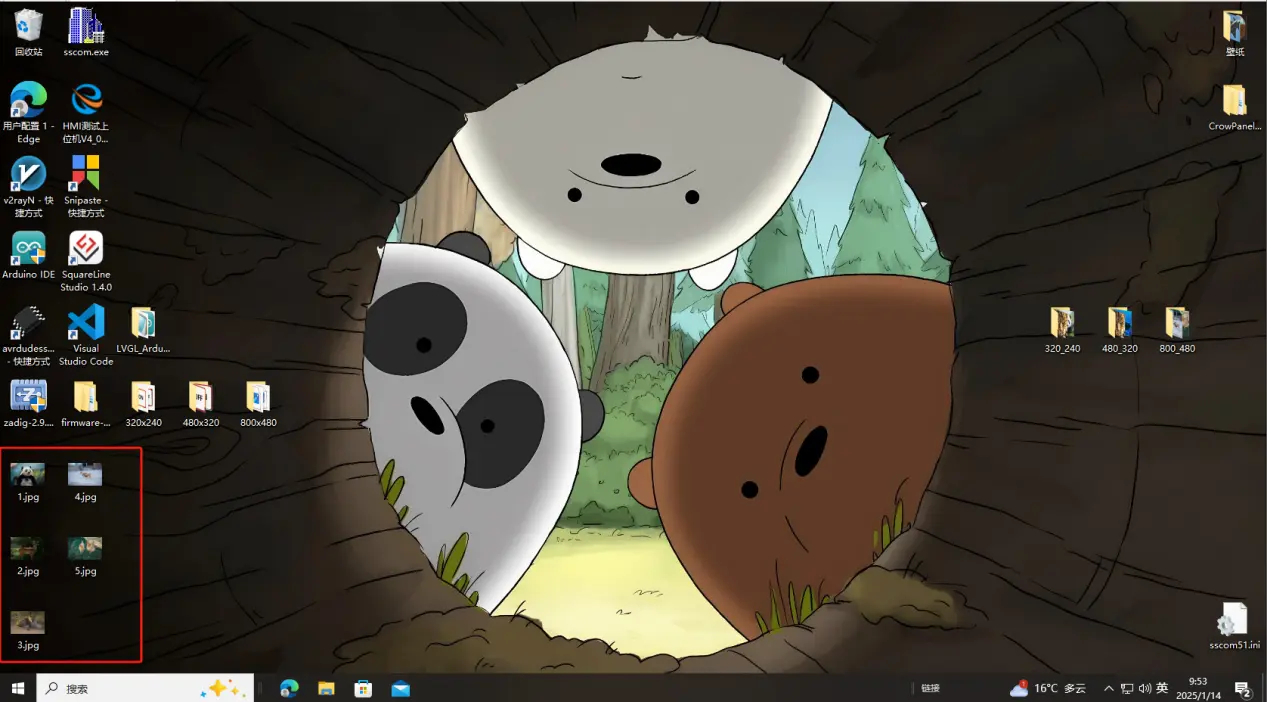

1 Select the photos you want to display on the browser and save them on the desktop (the save path can be customized)
2 Modify the resolution of the image based on the size of the product you are using.

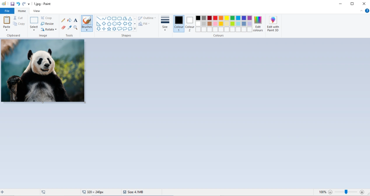

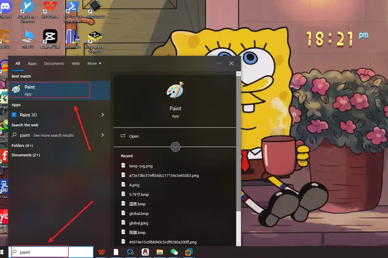

First, open the "paint" tool on the computer.
3

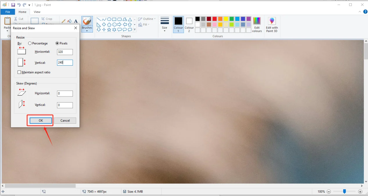

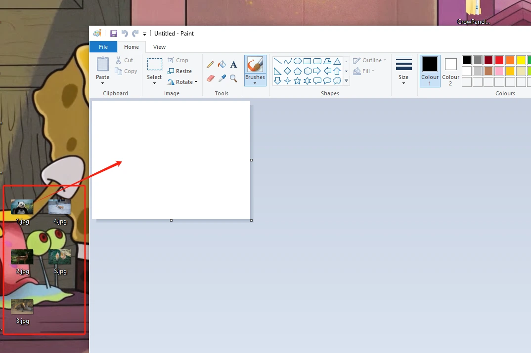

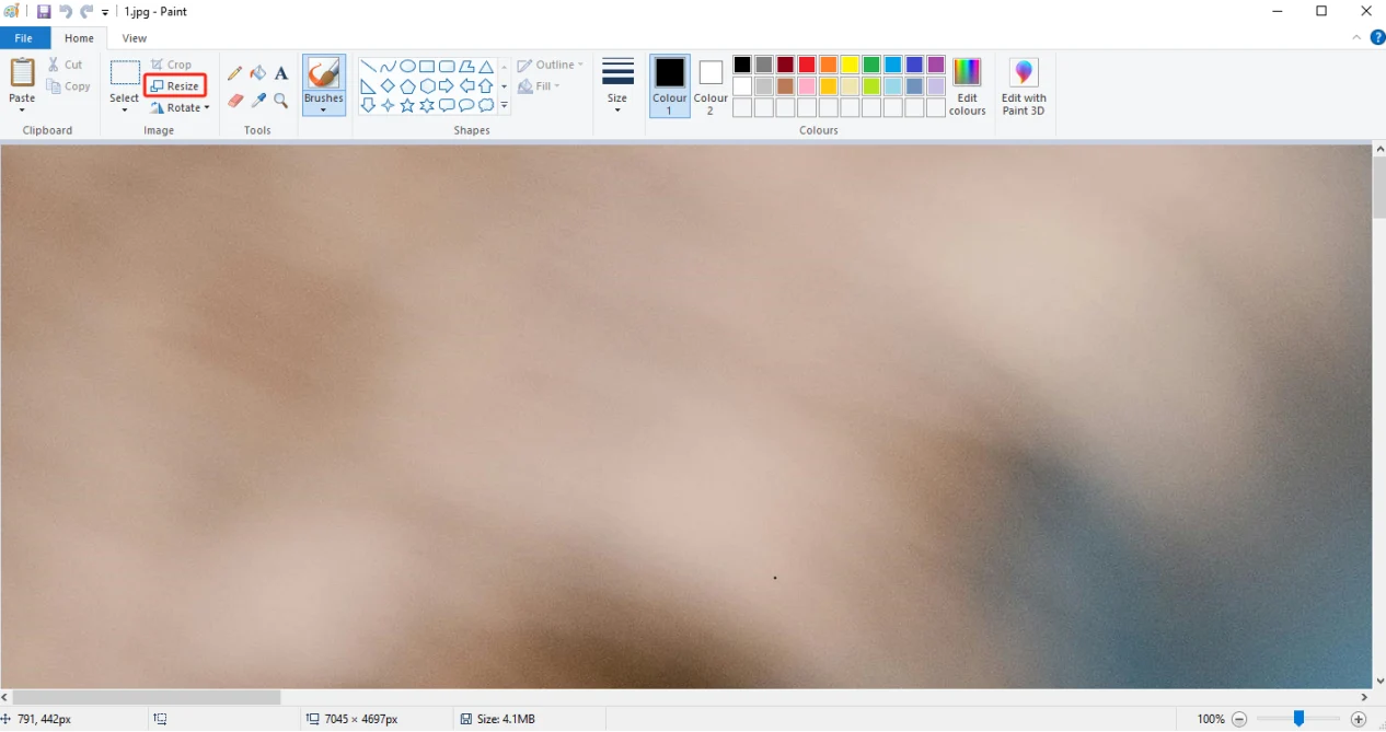

Drag and drop the image into the "paint" tool to readjust the pixels of the image
(Images can be uploaded to the browser and selected according to everyone's preferences)
4
5
Adjust the pixel to 5.0-inch screen resolution: 320x240
(If you are using a different size, please set the correct resolution)
Can be referred to:There are resolutions of different sizes as references above. (Second point)
6
Click confirm
7
Adjust the resolution of the image as shown in the picture

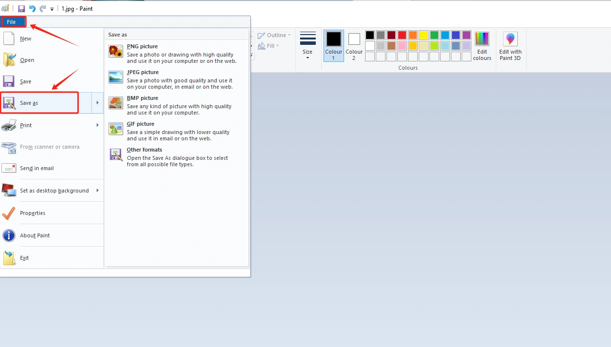

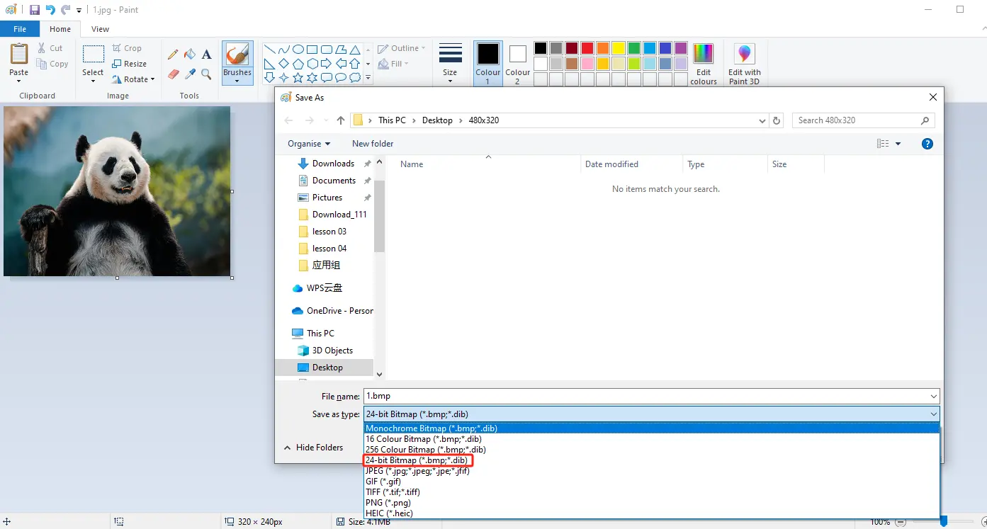

Save in BMP format (must have a 24 bit image depth)
10

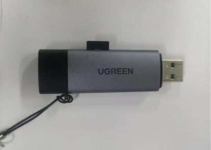

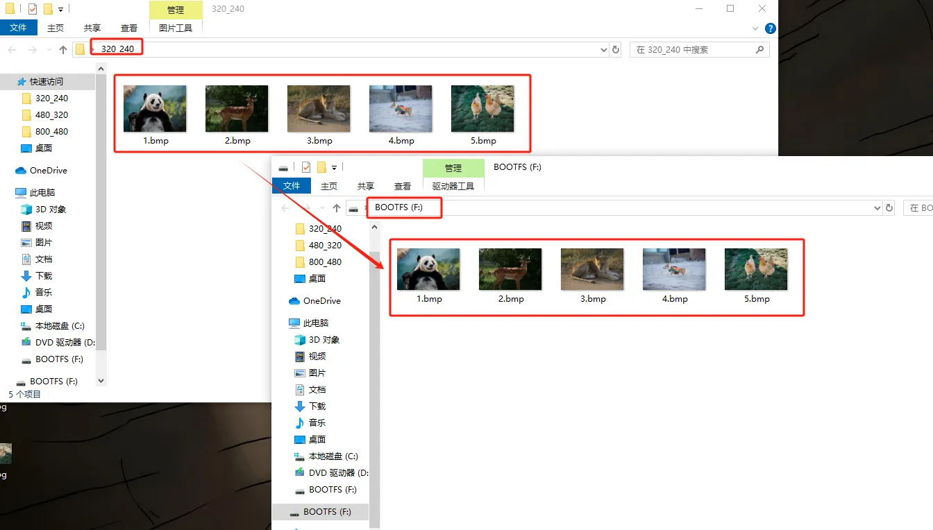

Insert the SD card into the card reader
11
Open the SD drive, copy the modified image to the SD drive and save it
12
Exit the SD card and remove the SD card

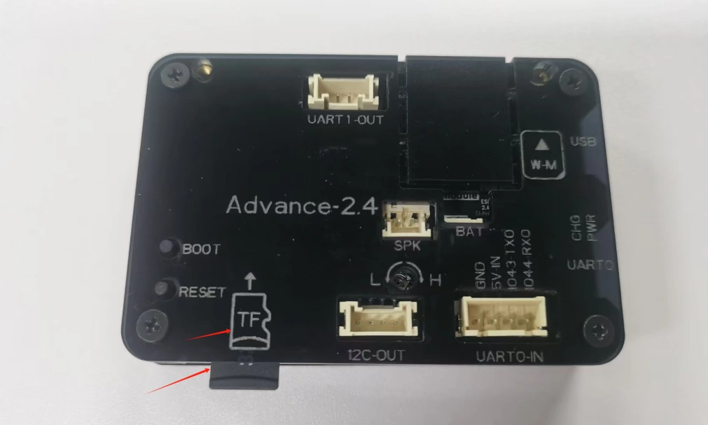

3 Insert the SD card containing this saved image into your CrowPanel ESP32 Advance HMI
13
(5.0 inch, 2.8 inch, 5.0 inch products can be directly inserted for use)
14

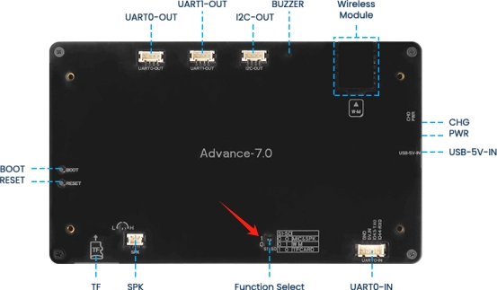

(After inserting the SD card, turn the function switch to 1 0 mode (TF Card mode) for 5.0-inch, 5.0-inch and 7.0-inch.)

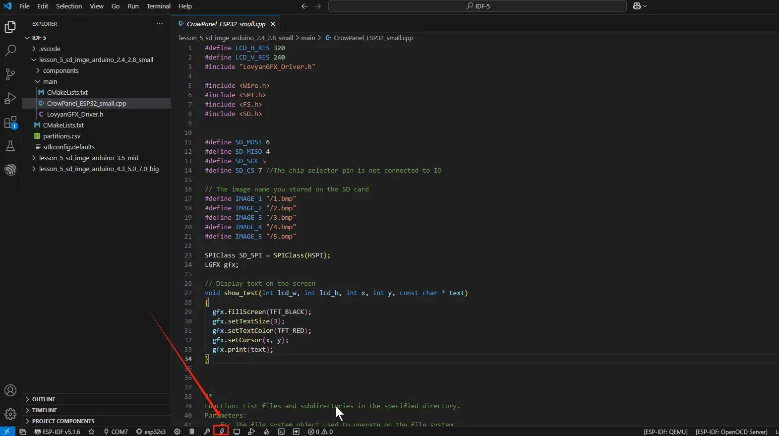

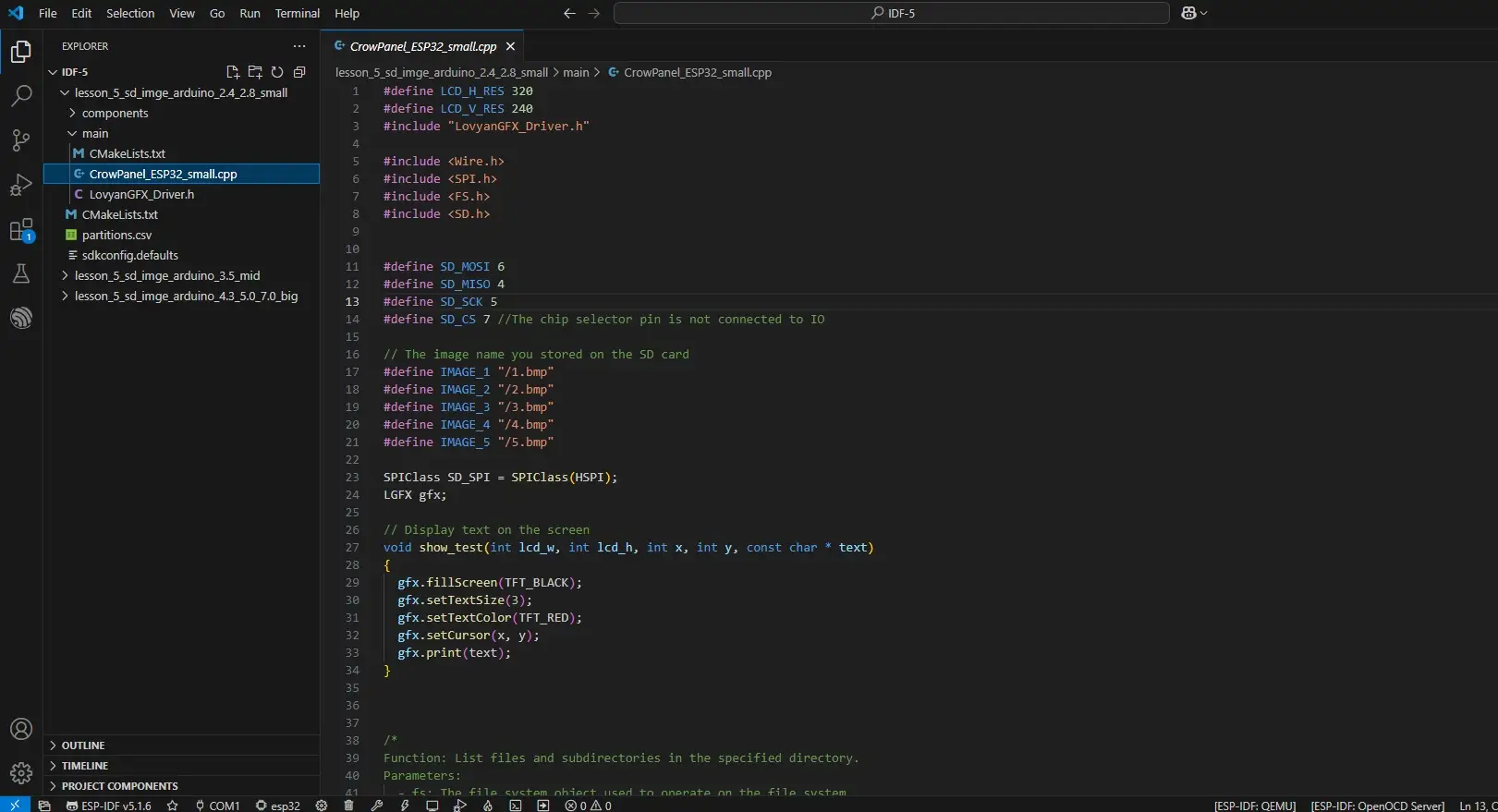

4 Open the code we provide
Code download link:https://github.com/Elecrow-RD/CrowPanel-Advance-5-HMI-ESP32-S3-AI-Powered-IPS-Touch-Screen-800x480/tree/master/example/ESP_IDF
Download it to the Desktop and Open it with VS Code
15

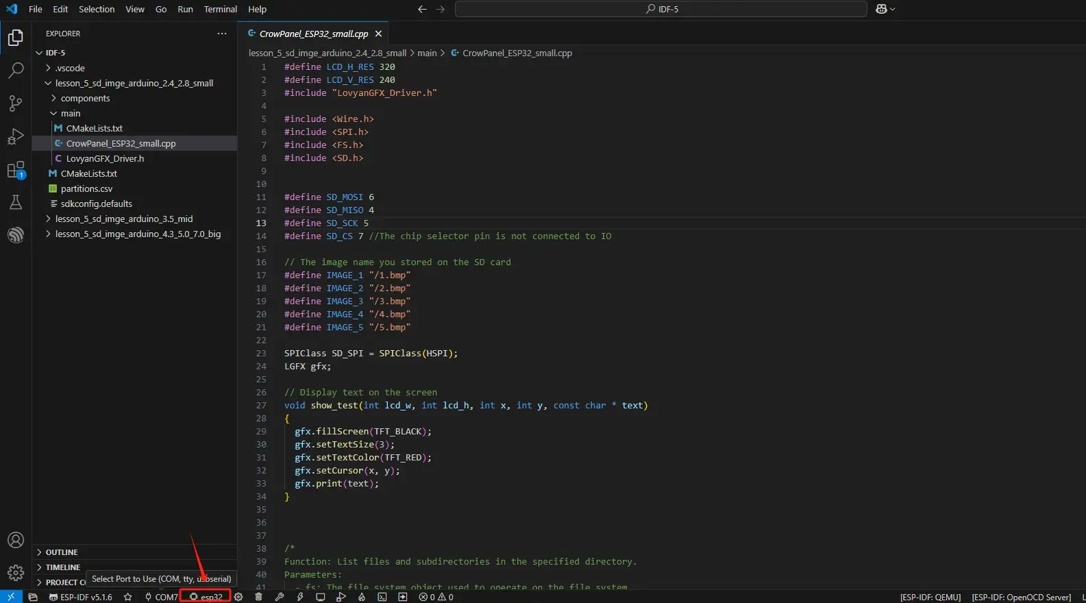

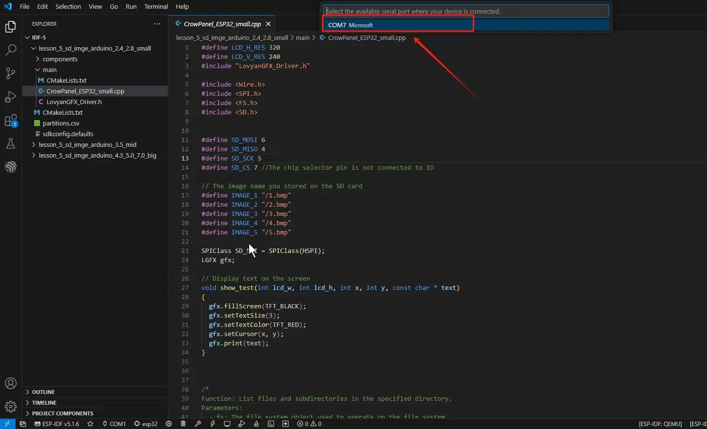

After Connecting the Device, Select the Serial Port
16
16

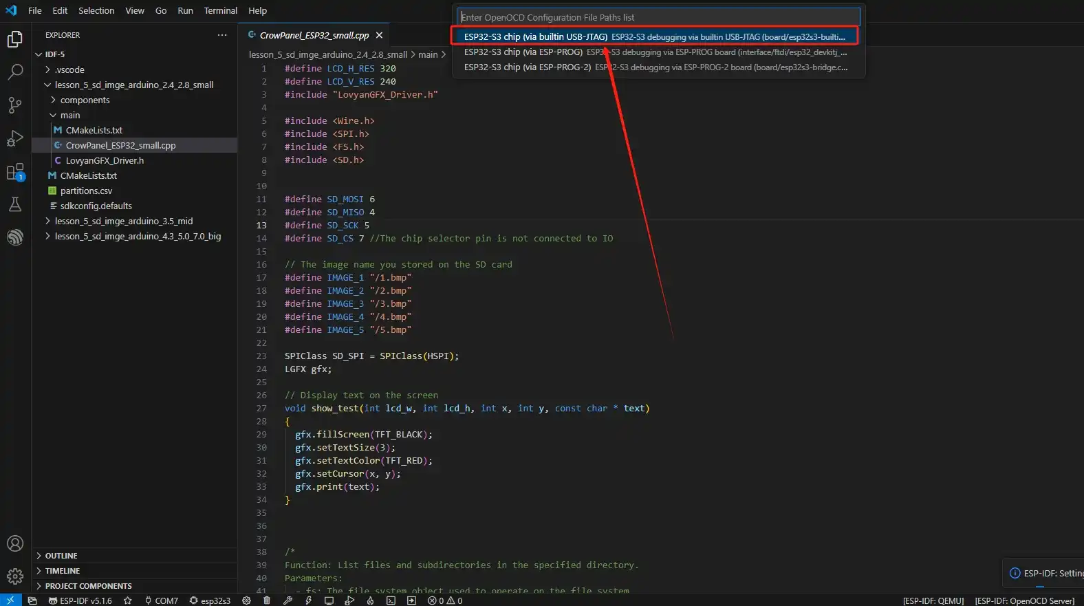

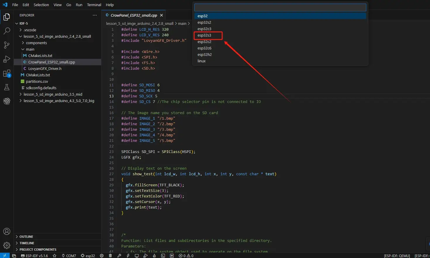

Set the Main Control Chip to: ESP32-S3
18
18
18

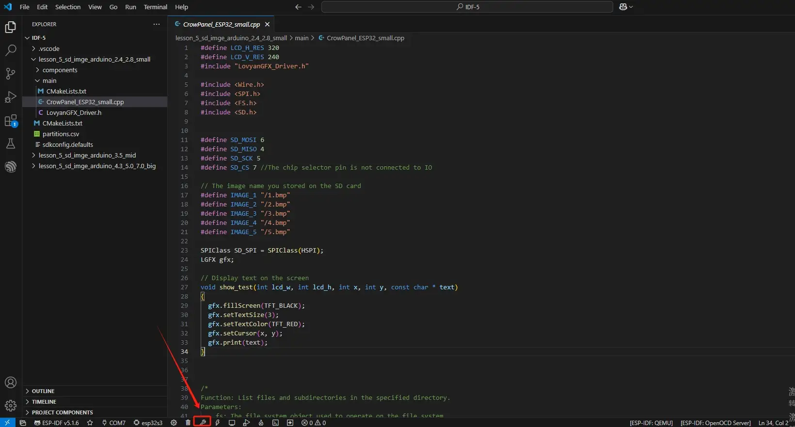

Click "Build Project". Once the compilation is complete, click "Flash Device".

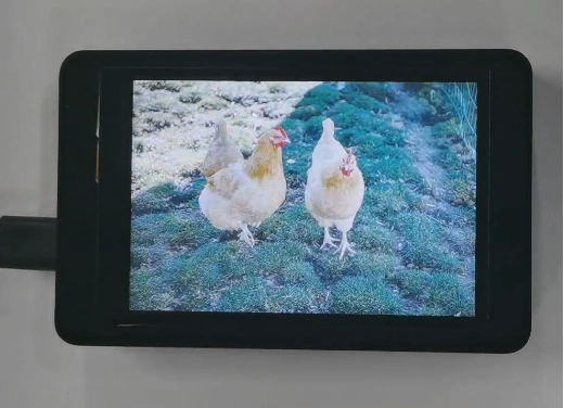

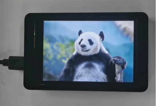

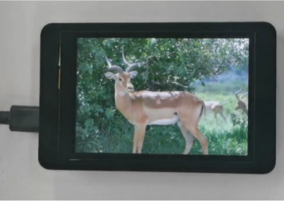

6 Phenomenon display
22
23
24
25
26

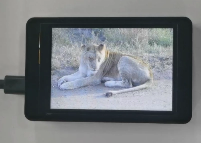

The five photos I saved on the SD card will be displayed in a loop.
