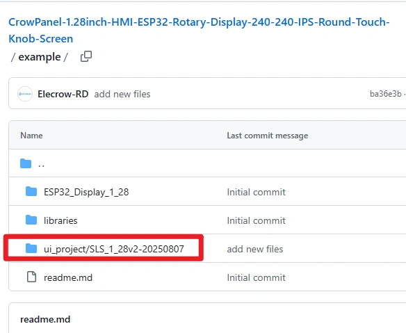

UI engineering files and code resources currently available on GitHub:
CrowPanel-1.28inch-HMI-ESP32-Rotary-Display-240-240-IPS-Round-Touch-Knob-Screen

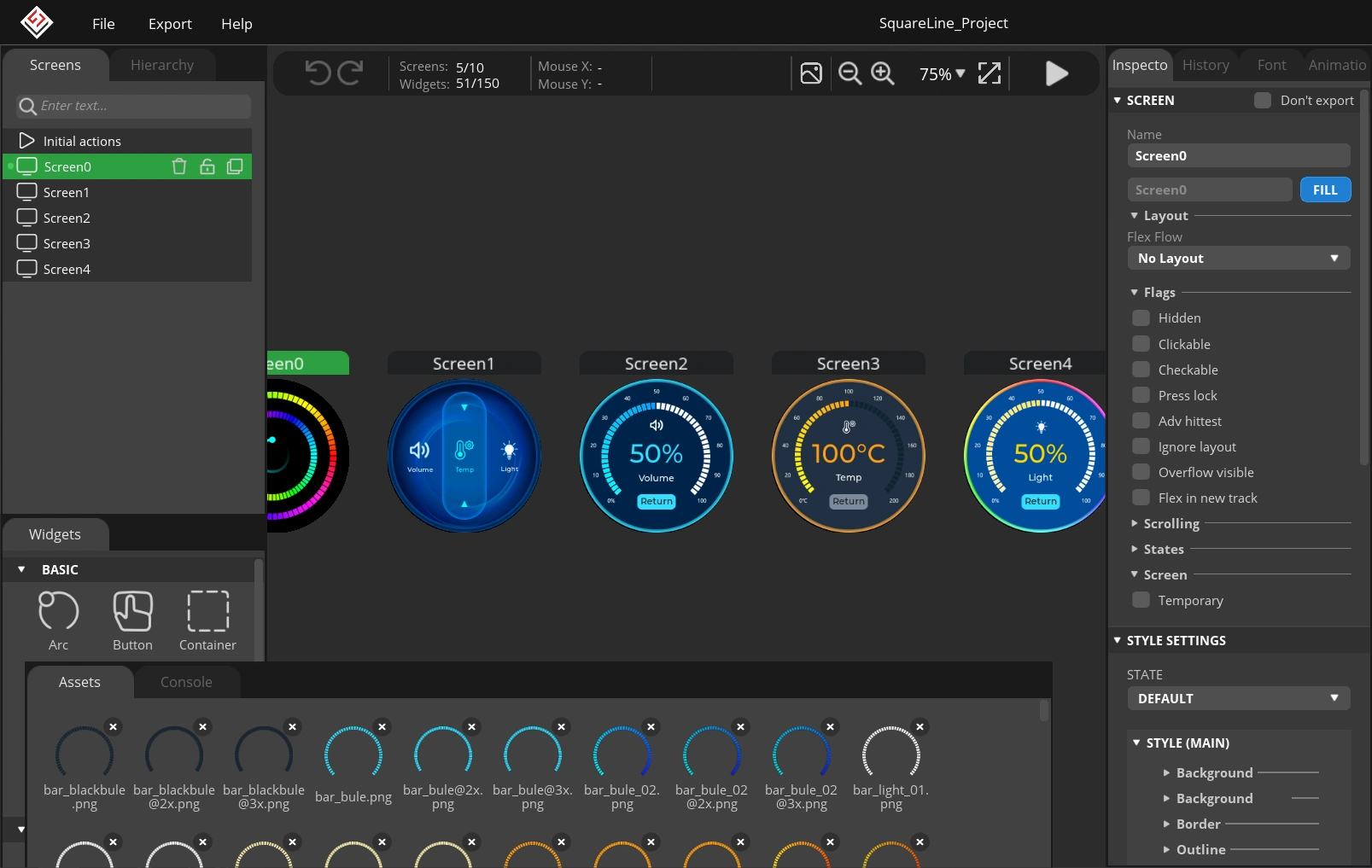

Importing UI projects using SquareLine Studio:
Click “Import Project” in the lower right corner to import the UI project we provided.
CrowPanel1.28inchRotary-3
After importing, the project will appear in the list. Double-click to open the factory.
CrowPanel1.28inchRotary-5
CrowPanel1.28inchRotary-6

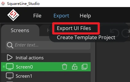

You can directly export UI files, use the UI files we provide, or modify the UI project yourself to customize your settings.
CrowPanel1.28inchRotary-7
CrowPanel1.28inchRotary-8

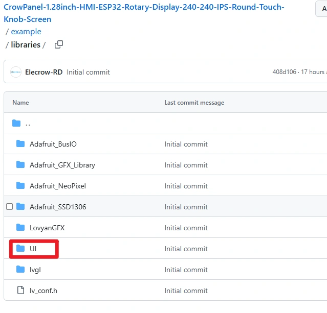

Click on the GitHub link download to download the code, and use Arduino to open.
CrowPanel1.28inchRotary-9
Click on the GitHub link download to download the library and UI files we provide, and place these files in the libraries folder..

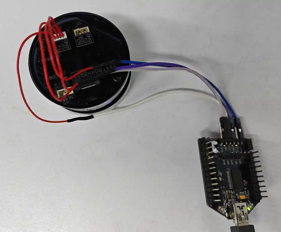

Important Notes for Downloading Programs:
Before downloading any program, you must press the boot button before powering on, Then select the corresponding serial port number to download the program.
①When using the USB-5v-IN port for direct program download, if you need to send or receive data via the serial port, you must enable “USB CDC ON BOOT” in the download settings section of the tool.
CrowPanelRotary-1
②When using UART to download programs, a USB-to-TTL converter is required. When viewing serial port data, there is no need to enable USB CDC on boot.

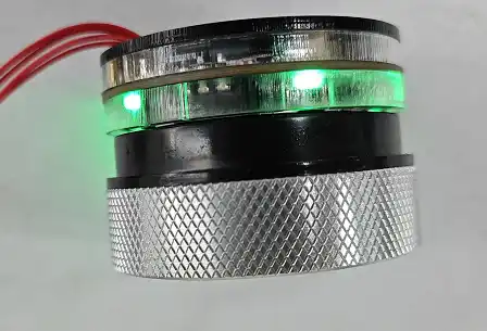

CrowPanelRotary-2
Simple example:
RGB_CODE:
The example provides the minimum required RGB LED control, including three basic effects: solid color, running light, and breathing light.
