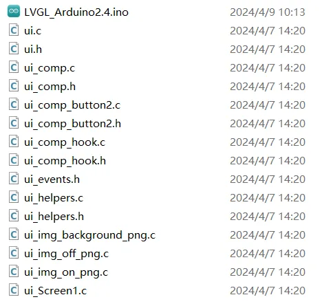

  9. Export UI files.
    SLS-UI-25
    SLS-UI-26
    Then click "APPLY CHANGES".
    SLS-UI-27
    SLS-UI-28
    SLS-UI-29
    Please click download to download the main program(and the expert UI is included).
    SLS-UI-30

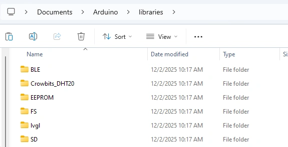

Please click download to download the libraries we modified.
SLS-UI-36
SLS-UI-37
Tips:

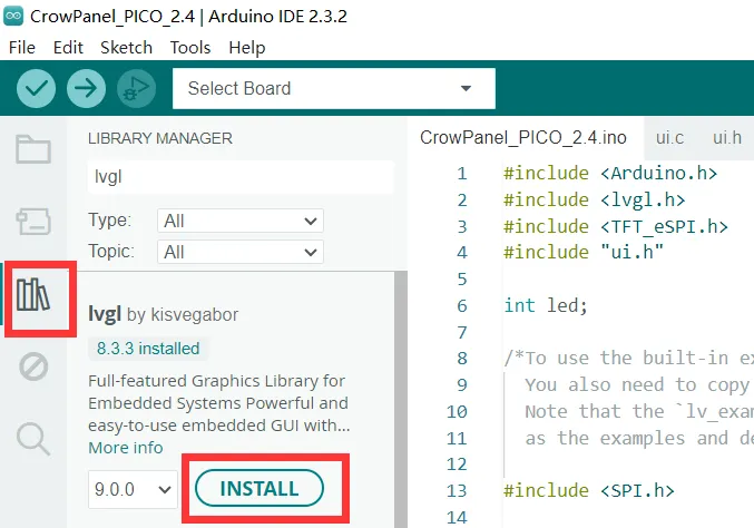

  • If you install the lvgl libraries by Library Manager, you need to copy the demos folder and examples folder and paste them to src folder. And modify the lv_conf_template.h file and rename it to lv_conf.h, and place it in libraries folder.(Please refer to the library provided)
  • If you install the TFT_eSPI libraries by Library Manager, you need to modify User_Setup.h file accordding to the hardware specification.(Please refer to the library provided)
SLS-UI-38
Download version 8.3.3 of LVGL.
SLS-UI-39

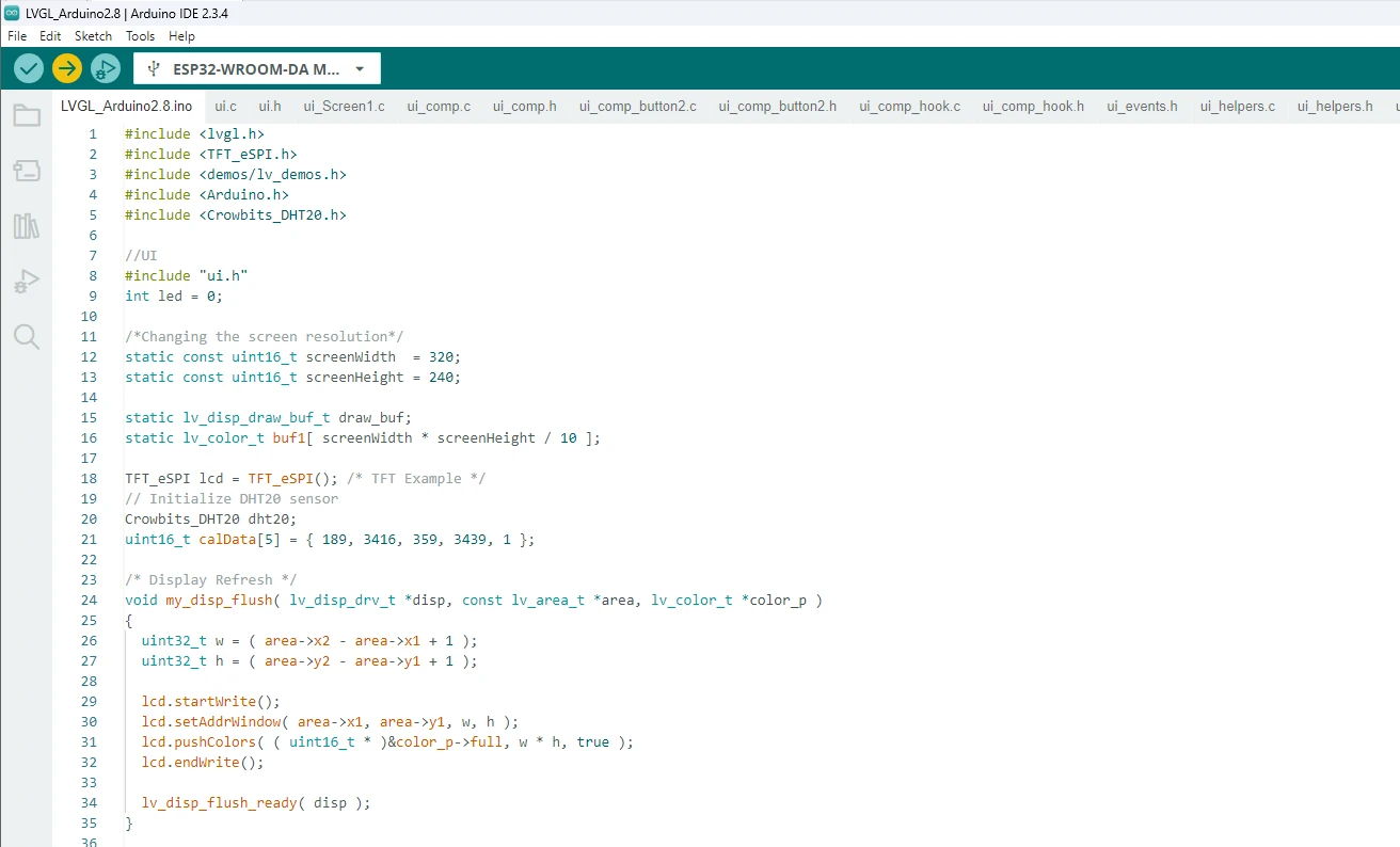

The Complete Code
#include <lvgl.h>
#include <TFT_eSPI.h>
#include <demos/lv_demos.h>
#include <Arduino.h>
#include <Crowbits_DHT20.h>
//UI
#include "ui.h"
int led = 0;
/*Changing the screen resolution*/
static const uint16_t screenWidth  = 320;
static const uint16_t screenHeight = 240;
static lv_color_t buf1[ screenWidth * screenHeight / 10 ];
TFT_eSPI lcd = TFT_eSPI(); /* TFT Example */
// Initialize DHT20 sensor
    Crowbits_DHT20 dht20;
uint16_t calData[5] = { 189, 3416, 359, 3439, 1 };
/* Display Refresh */
void my_disp_flush( lv_disp_drv_t *disp, const lv_area_t *area, lv_color_t *color_p )
  uint32_t w = ( area->x2 - area->x1 + 1 );
  uint32_t h = ( area->y2 - area->y1 + 1 );
  lcd.startWrite();
  lcd.setAddrWindow( area->x1, area->y1, w, h );
  lcd.pushColors( ( uint16_t * )&color_p->full, w * h, true );
  lcd.endWrite();
  lv_disp_flush_ready( disp );
uint16_t touchX, touchY;
/*Read Touchpad*/
  bool touched = lcd.getTouch( &touchX, &touchY, 600);
  if ( !touched )
  else
    /*Setting the coordinates*/
    data->point.x = screenWidth - touchX;
    data->point.y = touchY;
    Serial.printf("Touch X:%d  Y:%d\n", data->point.x, data->point.y);
void setup()
  Serial.begin( 115200 ); /*Initializing the Serial Port*/
  pinMode(4, INPUT);
  //IO Port Pins
  pinMode(25, OUTPUT);
  digitalWrite(25, LOW);
  Wire.begin(22, 21);
  dht20.begin();
  lcd.begin();
  lcd.setRotation(1);
  lcd.fillScreen(TFT_BLACK);
  delay(100);
      //Backlight Pins
  pinMode(27, OUTPUT);
  digitalWrite(27, HIGH);
  SPI.begin(14, 4 , 13, 33);
  lv_init();
  lcd.setTouch( calData );
  lv_disp_draw_buf_init( &draw_buf, buf1, NULL, screenWidth * screenHeight / 10 );
  /*Initializing the display*/
  lv_disp_drv_init( &disp_drv );
  /*Change the following line to display resolution*/
  lv_disp_drv_register( &disp_drv );
      /*Initialize the (virtual) input device driver*/
  lv_indev_drv_init( &indev_drv );
  lv_indev_drv_register( &indev_drv );
  ui_init();
void loop()
  Serial.println(led);
  char DHT_buffer[6];
  int a = (int)dht20.getTemperature();
  int b = (int)dht20.getHumidity();
  if(led == 1)
    digitalWrite(25, HIGH);
  if(led == 0)
  delay( 10 );

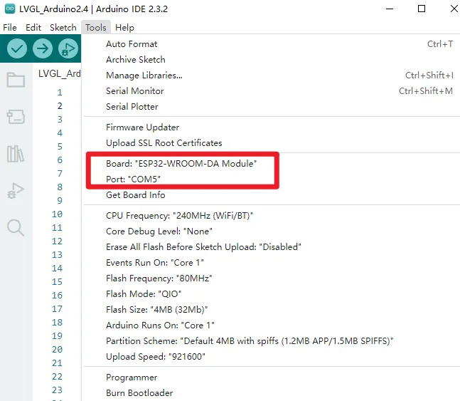

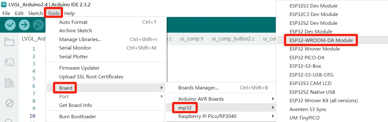

  1. After completing the installation of the ESP32 board according to "Get Started with Arduino IDE" and the installation of the library according to "Install Libraries", open the program and connect the ESP32 HMI 2.4-inch to the computer via a USB-C cable.
  2. Select Board: click "Tools" -> "Board" -> "esp32" and select "ESP32-WROOM-DA Module"(select ESP32 Dev Module also be good)
    select-board

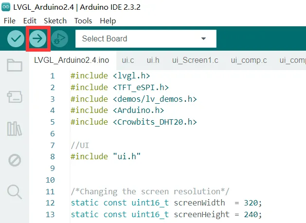

  4. Upload the code
    upload-the-code

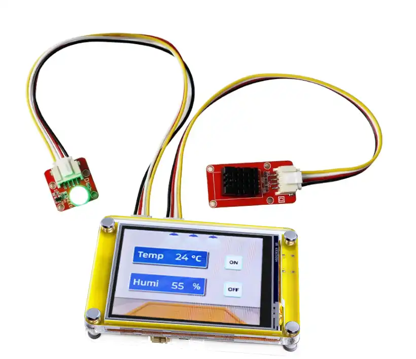

  5. After the program is successfully uploaded, connect the DHT20 sensor to the IIC port and the LED to GPIO_D (IO25), the temperature and humidity values will be displayed on the screen. Click the ON button on the screen and the LED will turn on. Click the OFF button and the LED will turn off.
ESP32-2.4-ARDUINO

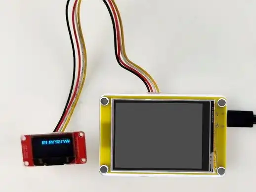

Example2: Control an external OLED screen through I2C.
Connect the OLED screen to IIC port.
Install the U8g2 library. Then upload the following code.
ESP32 version: 2.0.14
U8g2 version: 2.35.30
#include <U8g2lib.h>
#include <Wire.h>
#define I2C_SDA 22
#define I2C_SCL 21
U8G2_SSD1306_128X64_NONAME_F_SW_I2C u8g2(U8G2_R0, /*clock=*/I2C_SCL, /*data=*/I2C_SDA, /*reset=*/U8X8_PIN_NONE);
void setup() {
  Serial.begin(115200);
  //OLED
  u8g2.begin();
  u8g2.enableUTF8Print();        // enable UTF8 support for the Arduino print() function
  u8g2.setFont(u8g2_font_ncenB14_tr);
  u8g2.setFontDirection(0);
  for (int i = 128; i > -78; i -= 20)
    u8g2.firstPage();
    do {
      u8g2.drawStr(i, 25, "ELECROW");
      delay(2);
    } while ( u8g2.nextPage() );
void loop() {
oled-elecrow
