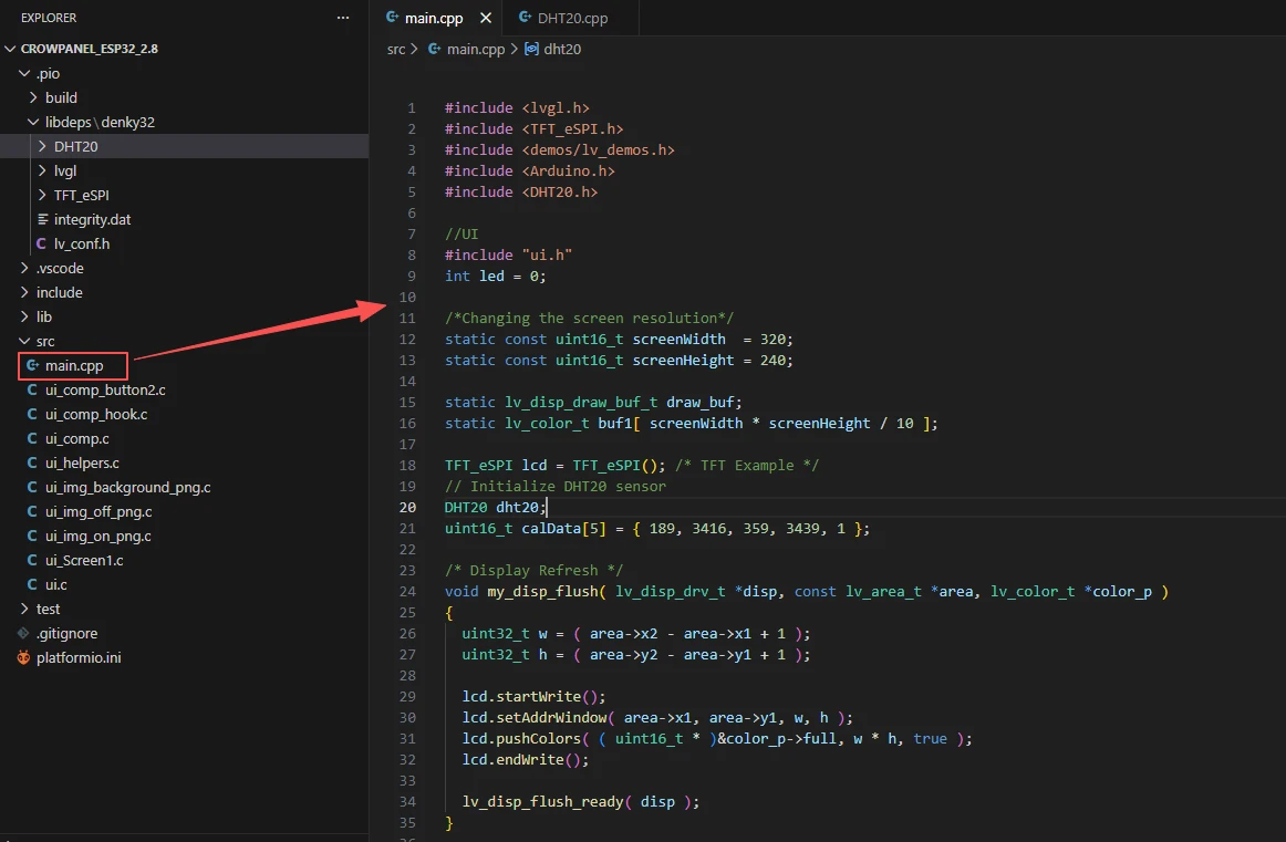

  3. Write the main program in main.cpp.
    PIO-5

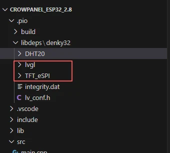

  3. Add TFT_eSPI library.
    PIO-11
    PIO-12
    PIO-13
    PIO-14
    We can see that the library has been added successfully!

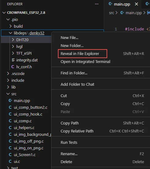

    Right-click the "libdeps\denky32", click "Reveal in File Explorer", and select the DHT20 library we provided.
    Please click download to download the DHT20 library.

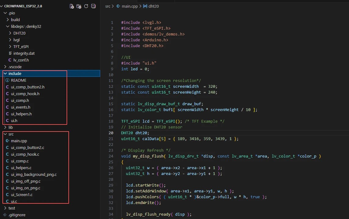

Add the UI file into PlatformIO Project
We need to add the UI file (generated from SquareLine Studio) to the PlatformIO project.
The .c files in the UI file should be placed in the /scr folder of the project file, and the .h files should be placed in the /include folder.
PIO-34
PIO-35

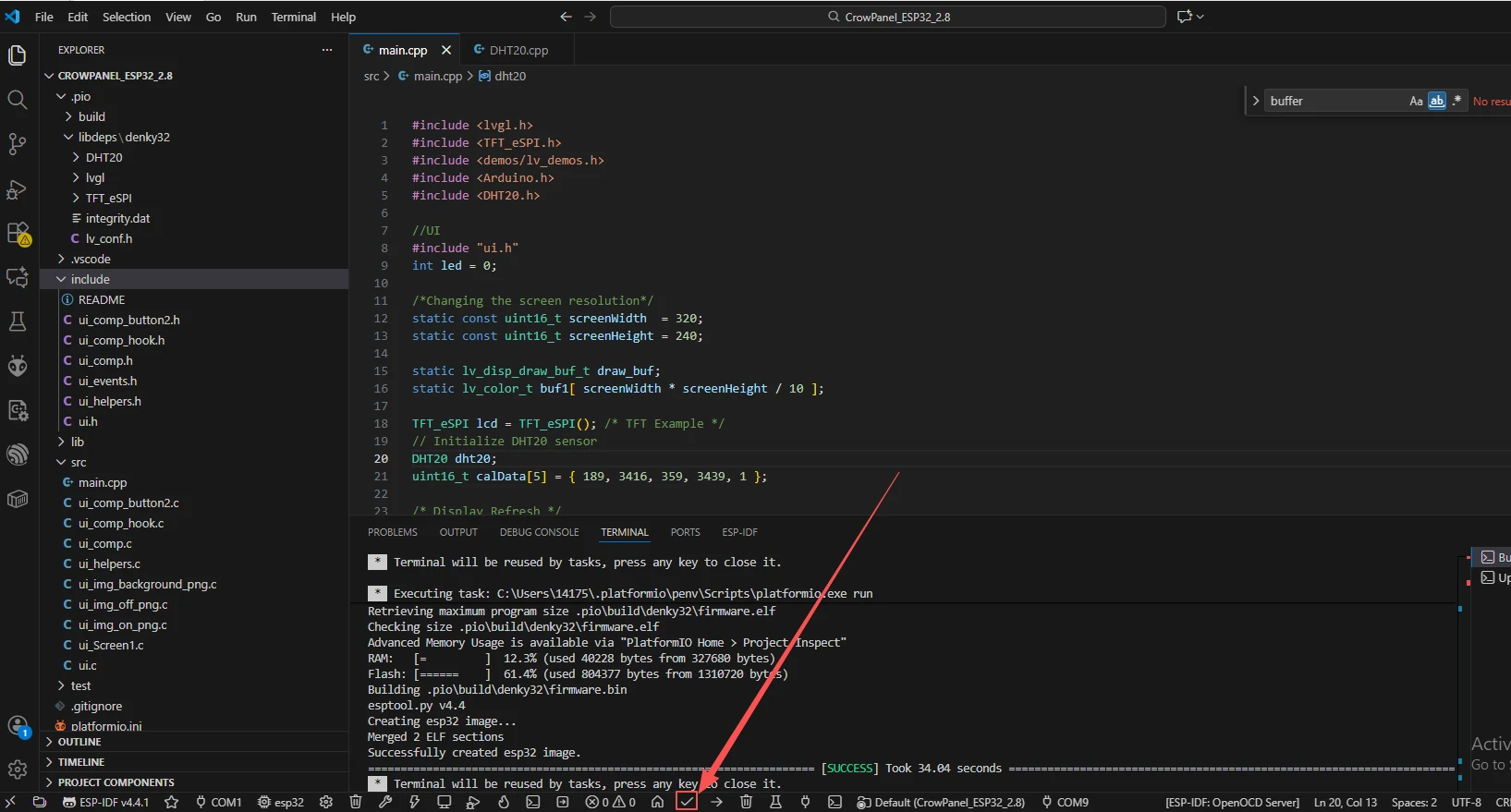

  1. Compile the program.
    Upload-code-1

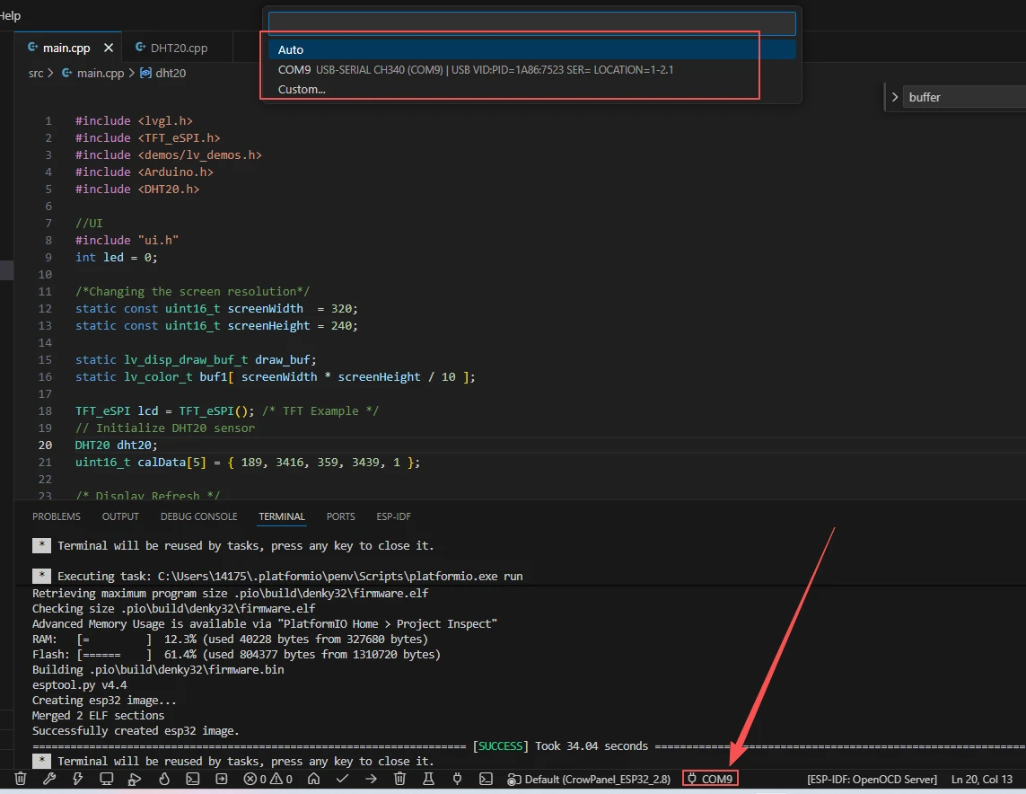

  2. Select the serial port and upload the code.
    Here we select Auto. The software will automatically select the corresponding serial port for program download. If the automatically selected serial port is incorrect, you can manually select the correct serial port.
    Upload-code-2

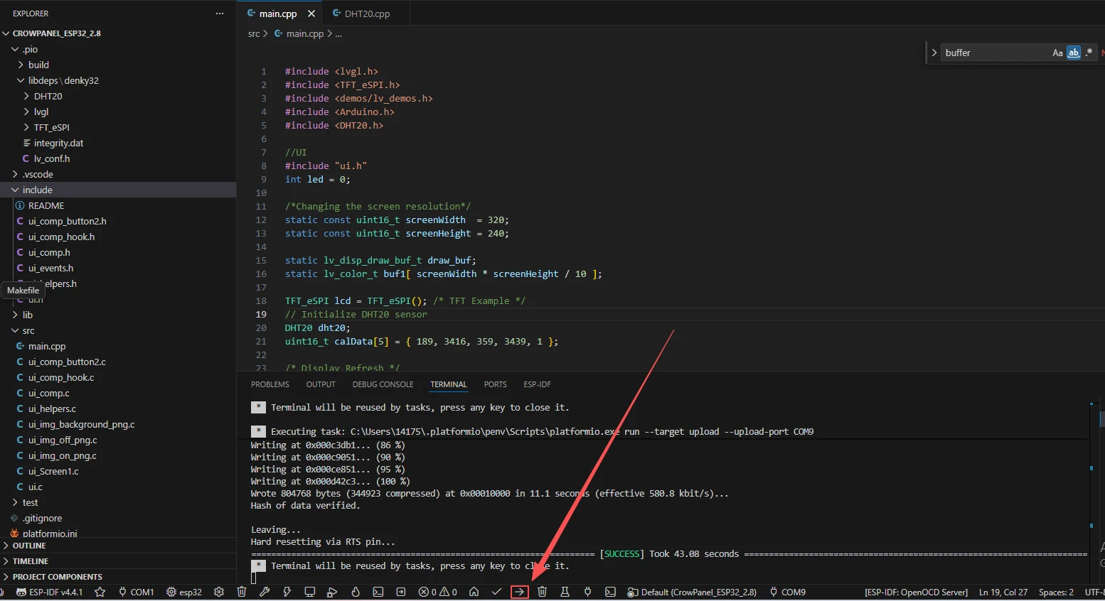

  3. Click the upload button to up the program to the board.
    Upload-code-3
  4. The program will run on the board!

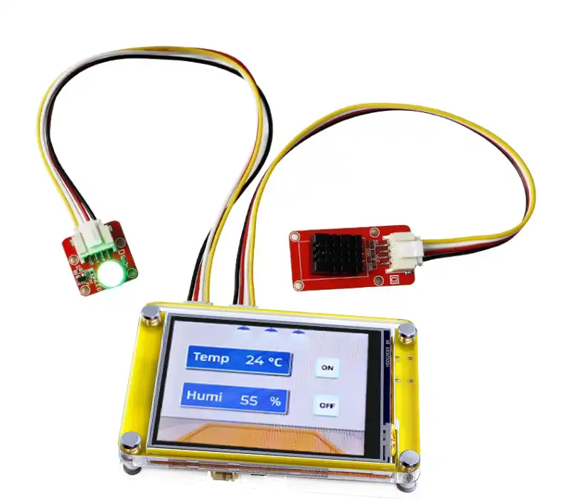

    ESP32-led
