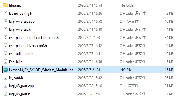

Code reference link: https://github.com/Elecrow-RD/CrowPanel-Advanced-7inch-ESP32-P4-HMI-AI-Display-1024x600-IPS-Touch-Screen/tree/master/example

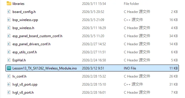

Double-click to open the Lesson 13 code (.ino file).
(There are two sets of code here, one for transmitting and one for receiving.)
Open the TX project
Open the RX project

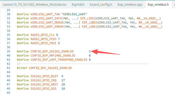

After opening the code, first go to bsp_wireless.h and enable the definitions related to the SX1262 module used in this lesson.
image-20260727181648057

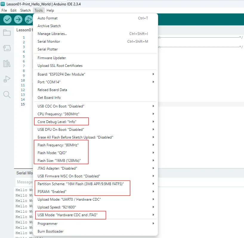

Configure the relevant options as follows.
  • Board: ESP32P4 Dev Module
  • Core Debug Level: Info
  • PSRAM: Enabled
Screenshot of the standard upload configuration from Lesson 1

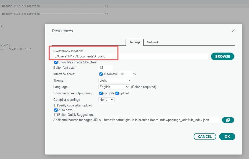

Follow the library import steps explained in detail in Lesson 1 to import the library files required by this project into the development environment, ensuring that the code can correctly locate the relevant dependencies during compilation, thereby guaranteeing proper program operation.
P4_Arduino_01_Images_15

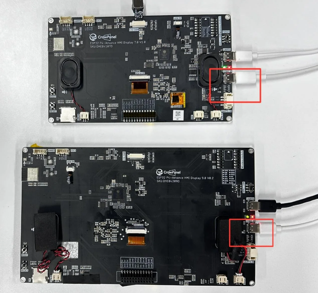

USB connect development board

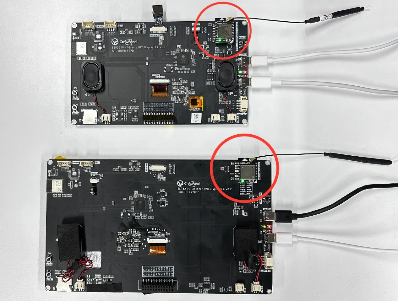

With the power off, install the two SX1262 LoRa modules into the wireless module slots.
Module interfaces of the two boards
When running multiple peripherals, add independent Type-C power to the USB 2.0 port.
External USB power supply

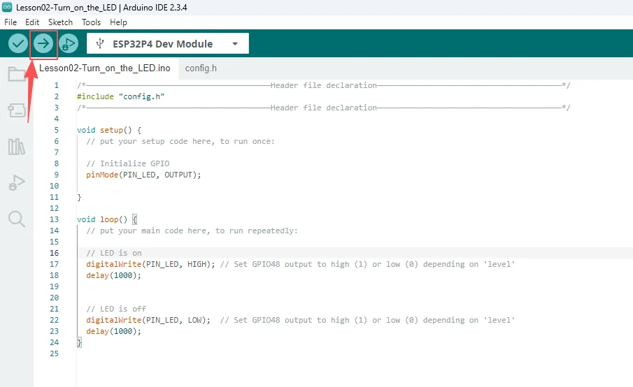

Before uploading the code, first select the upload configuration by following "4. Software Operation Steps".
Connect UART0, compile and upload using the general configuration; keep the development board powered.

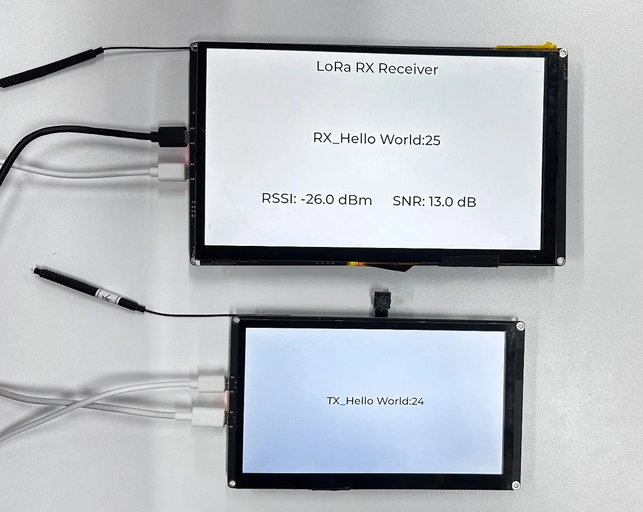

After the code is uploaded successfully:
The TX board displays TX_Hello World:i; the RX board displays RX_Hello World:i, and shows RSSI (dBm) and SNR (dB).
Both ends must use the same frequency, bandwidth, spreading factor, coding rate, and sync word.
SX1262 RX/TX results with RSSI/SNR

7. Experimental Observations
  • The TX counter increments by approximately 1 per second; the RX displays the corresponding message and increments only after receiving real data.
  • The RX can display RSSI/SNR, and the values change with distance, obstruction, and antenna orientation.
