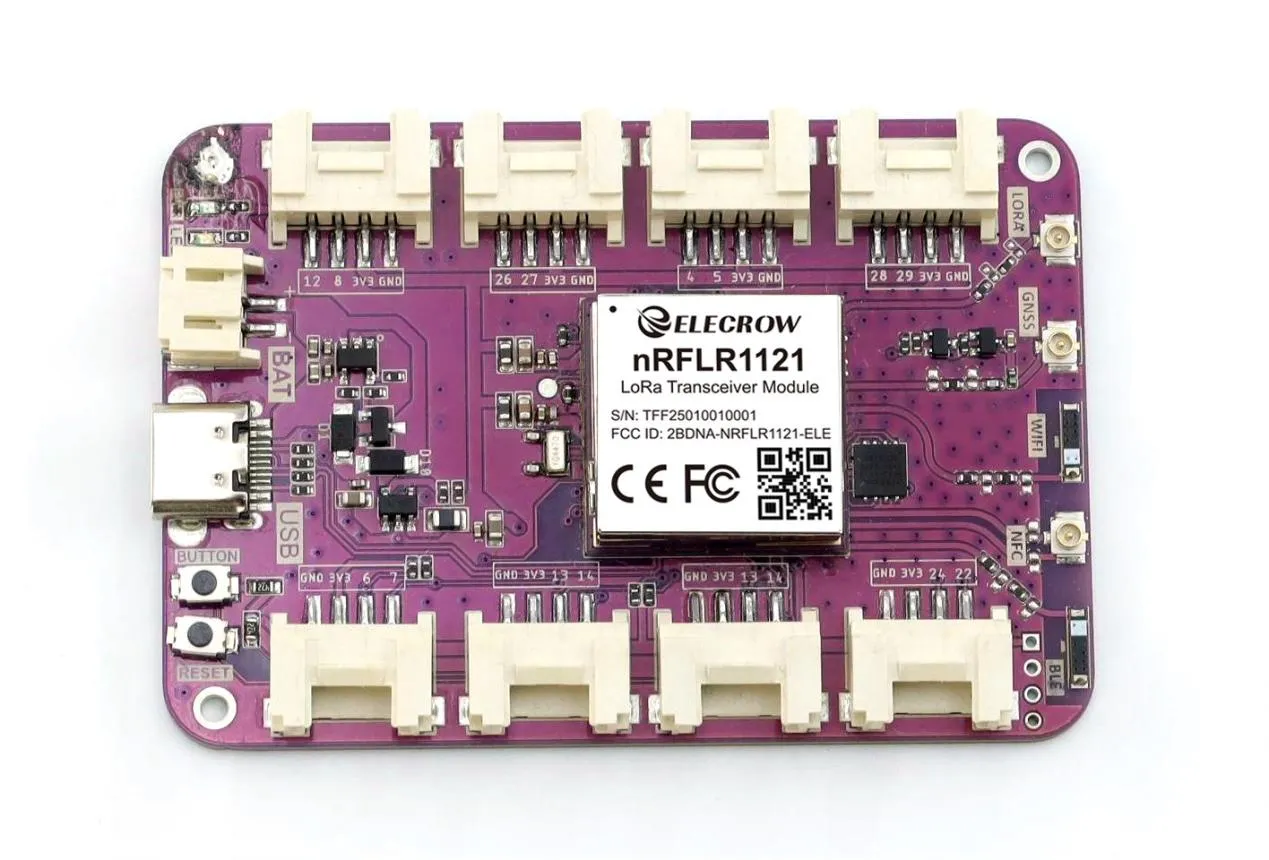

The Elecrow nRFLR1121 module integrates the Nordic nRF52840 microcontroller and the Semtech LR1121 LoRa transceiver chip. It is a high-performance, low-power, long-range transceiver module. It supports Bluetooth 5.3 and low-power Bluetooth, complies with the A, B, and C classes of the LoRaWAN 1.0.4 specification. And it supports LoRa point-to-point (P2P) communication mode, covering the 850~930MHz (applicable to 868MHz, 915MHz) global ISM frequency band, with a maximum transmit power of +20dBm, a transmission rate range of 1.91~62.5Kbps, and a transmission distance of up to 10 km. In addition, the module supports ground ISM band communications, covering the global 2.4GHz spectrum and Sub-GHz band, and also supports S-band LR-FHSS (Long Range - Frequency Hopping Spread Spectrum) technology for satellite connection (the two cannot work at the same time). This makes it suitable for remote areas without ground network coverage, such as environmental monitoring of meteorological stations and hydrological stations and transmits data to the central server via satellite communication.
The nRFLR1121 module has built-in AT command firmware, supports SDK customized development, and rich peripheral interfaces provide high flexibility to meet diverse development needs. Designed in accordance with industrial standards, the nRFLR1121 module is an ideal choice for high-reliability applications such as remote monitoring, ship communications, and rescue missions.

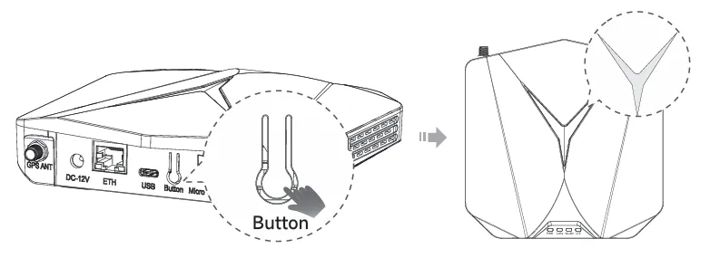

STEP1:Turn on the device's AP hotspot
Press and hold the button for 5 seconds until the top indicator light slowly flashes blue, then it will enter configuration mode.

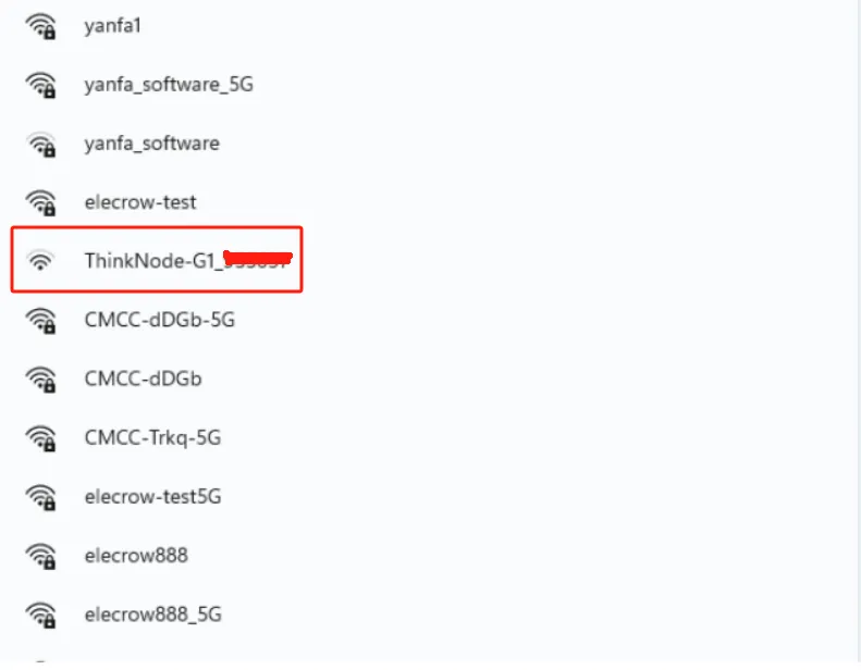

The name of the AP hotspot is ThinkNode - G1_XXXXXX (6 - digit MAC address). No password is required, and you can connect directly. Connect your computer or mobile phone to this AP hotspot.

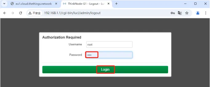

STEP3:Log in to the local console

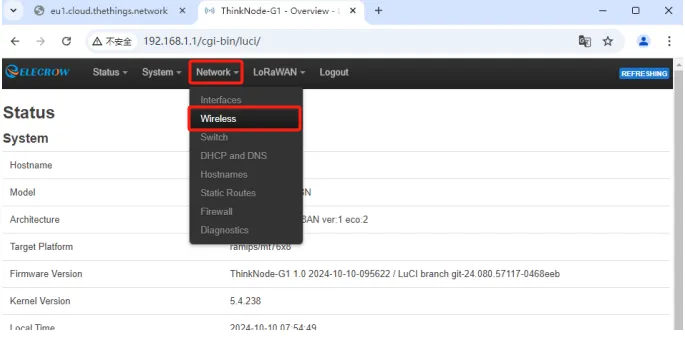

Enter the IP address (192.168.1.1) in your browser to access the local console. Then log in with the username "root", enter the password "root", and click the "Login" button.

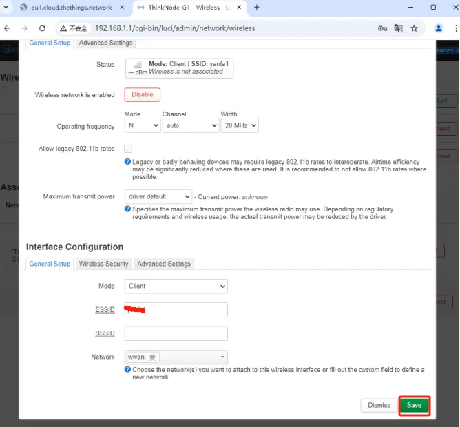

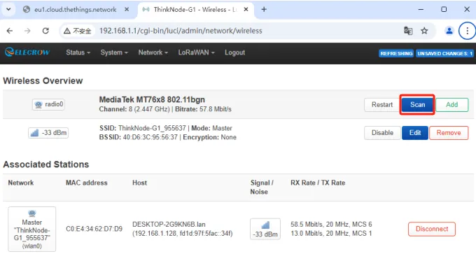

STEP4:Log in to the Luci page, and click Network - Wireless
STEP5:Click the "Scan" button to scan for Wi - Fi.

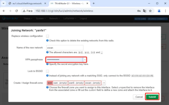

STEP6:Select your Wi - Fi to join the network.
STEP7:Enter the Wi-Fi password, then click "Submit", and save the settings.

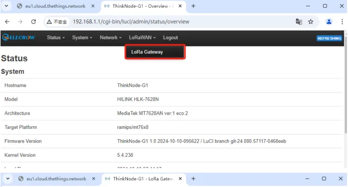

STEP8:Set the gateway's Internet connection method to Wi-Fi.

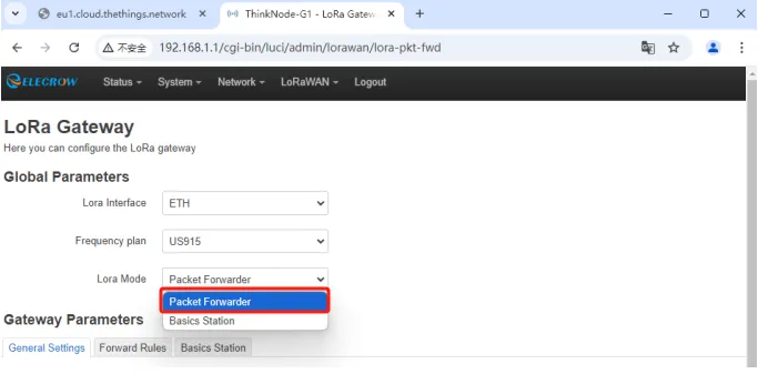

On the Luci interface, click "LoRaWAN" and navigate to the LoRa Gateway interface.
Select the network configuration mode as "WiFi".
STEP9:Set Mode to Packet Forwarder

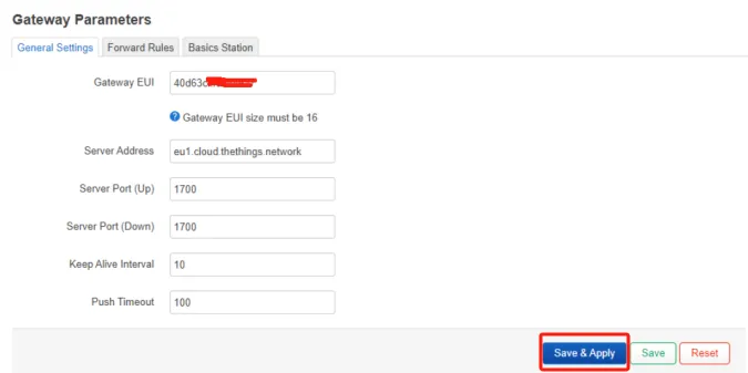

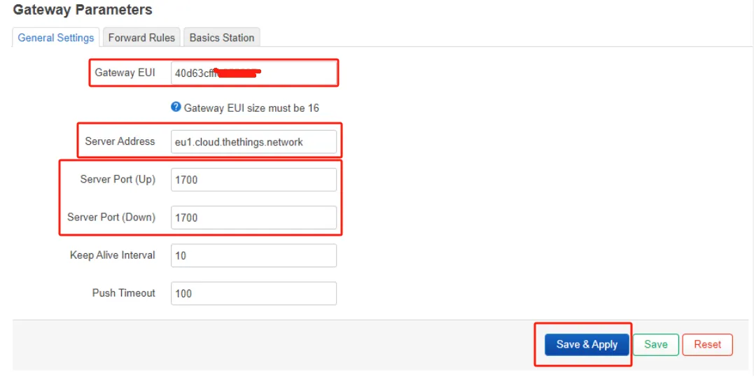

STEP10:Packet Forwarder Settings
1.Gateway EUI: It will automatically obtain the EUI of the connected gateway.
2.Server address: For the Semtech UDP packet forwarder, use "server-address". "server-address" is the address of The Things Stack deployment.
3.Server Ports (Up/Down): The uplink and downlink ports are typically set to 1700.
Other settings can be left as default or adjusted according to your requirements.

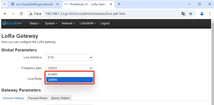

STEP11:Channel Plan Settings
Select the Region and Frequency plans according to the actual situation.This lesson takes EU868 as an example, so select EU868 here.
Then click "Save & Apply" to apply your settings.

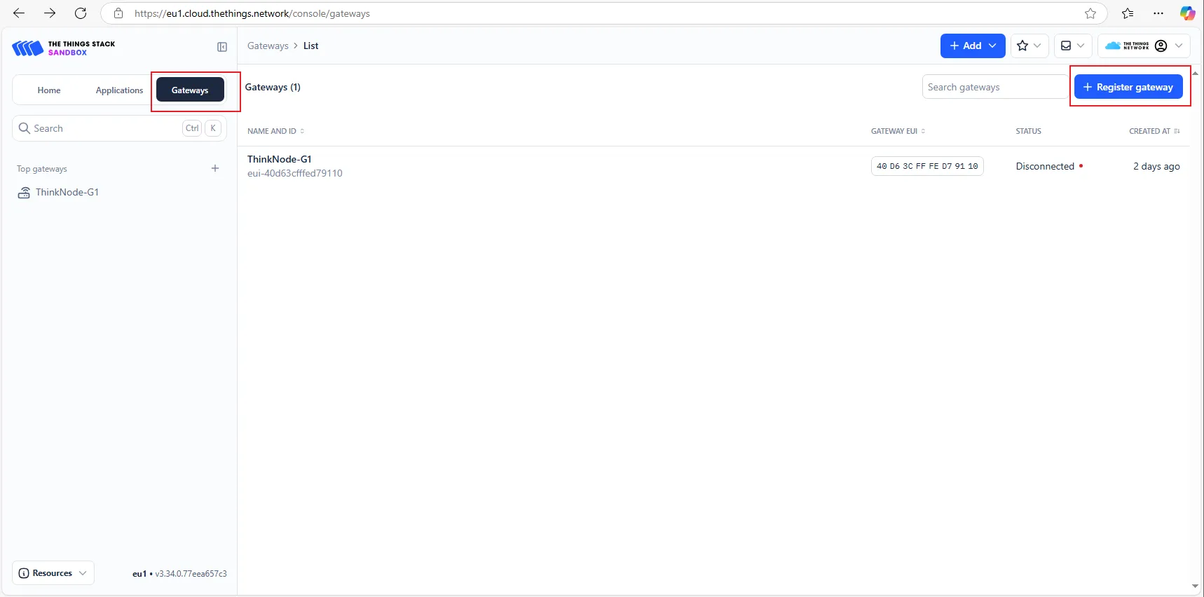

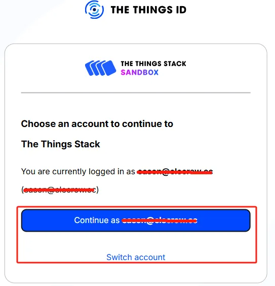

STEP1:Log in to The Things Stack (console.cloud.thethings.network). If you don't have a TTN account, please register first.

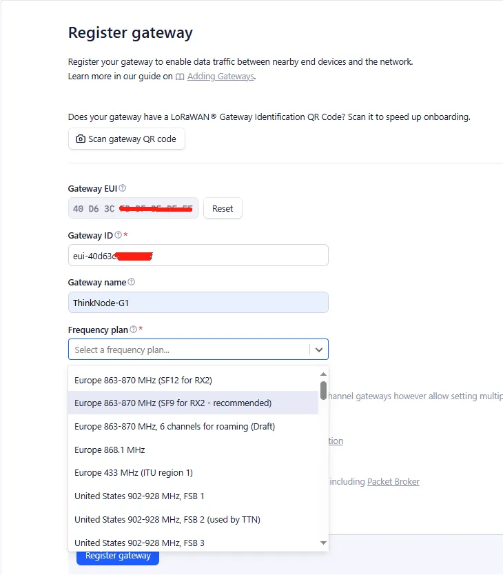

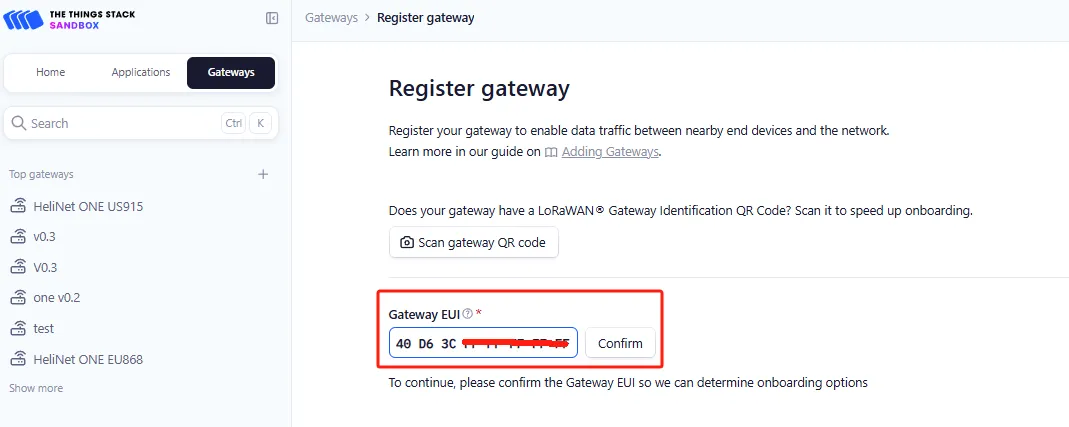

STEP2:Register the gateway, fill in the EUI, and click "confirm".
Gateway ID: It typically consists of letters (eui - "Gateway EUI") (The ID must contain only lowercase letters, numbers, and dashes).Note that the letters in "Gateway EUI" must be converted to lowercase.
Gateway Name: The name of the gateway.
Frequency Plan: Select the corresponding frequency according to your gateway version.

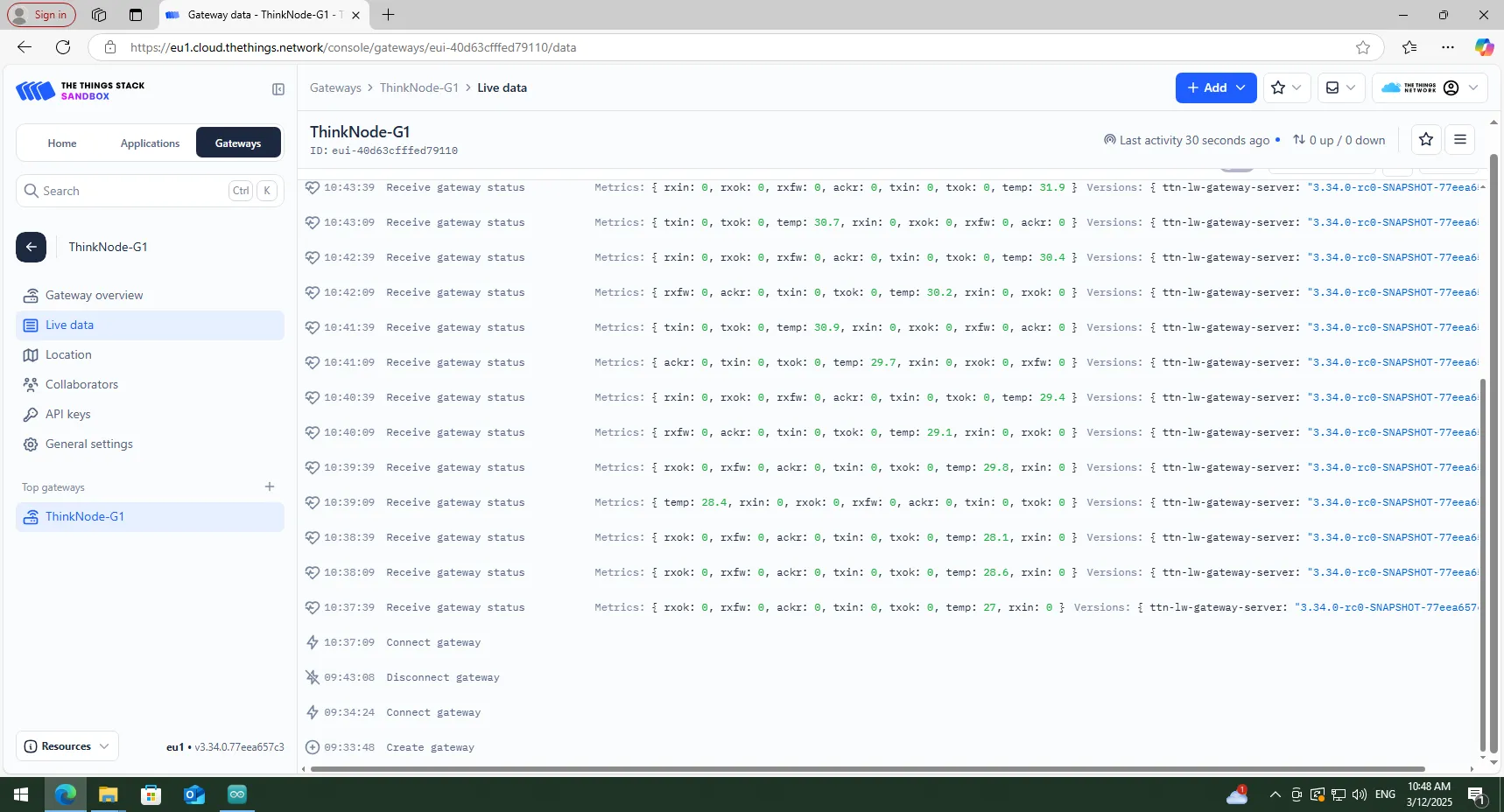

After successful registration, you can view the gateway in the overview.
Double - click the gateway settings button and wait for the gateway to restart. The gateway is now connected to TTN as a Packet Forwarder.

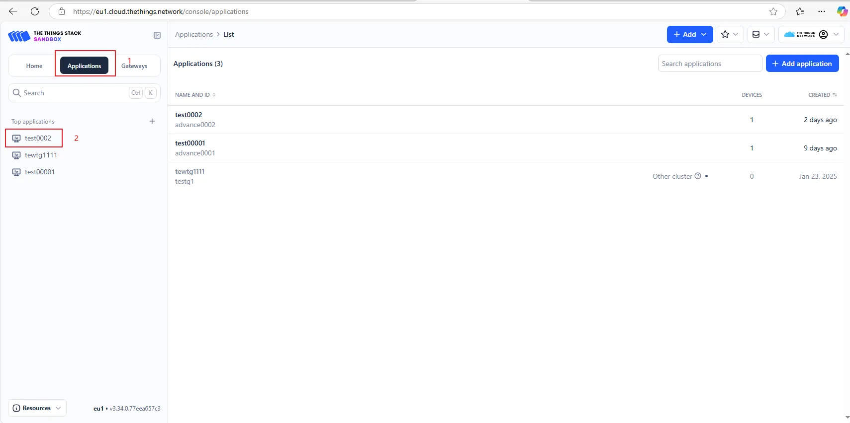

STEP1:Log in to the registered TTN account.

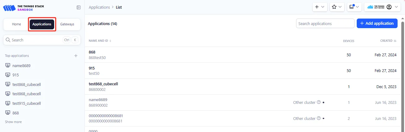

In the TTN server interface, click "Applications".

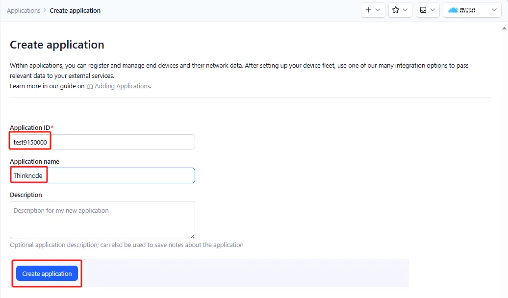

STEP2:Click "Add application" to start adding a node application.
Enter the Applications ID and Applications name, then click "Create application".

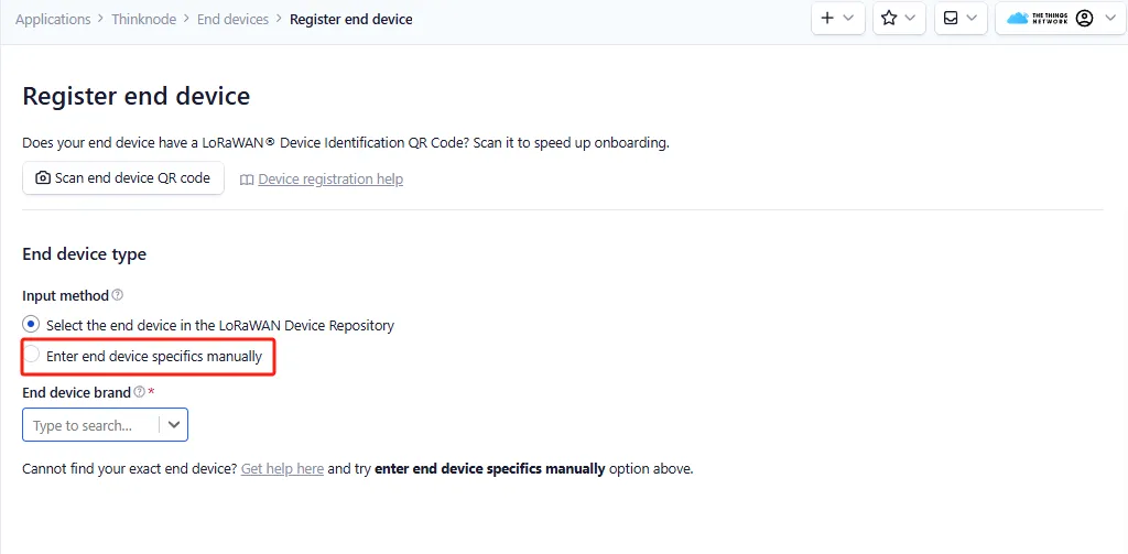

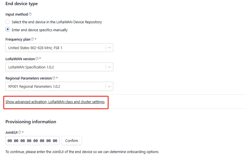

STEP4:In the "Register end device" page, click the "Enter end device specifics manually" option.

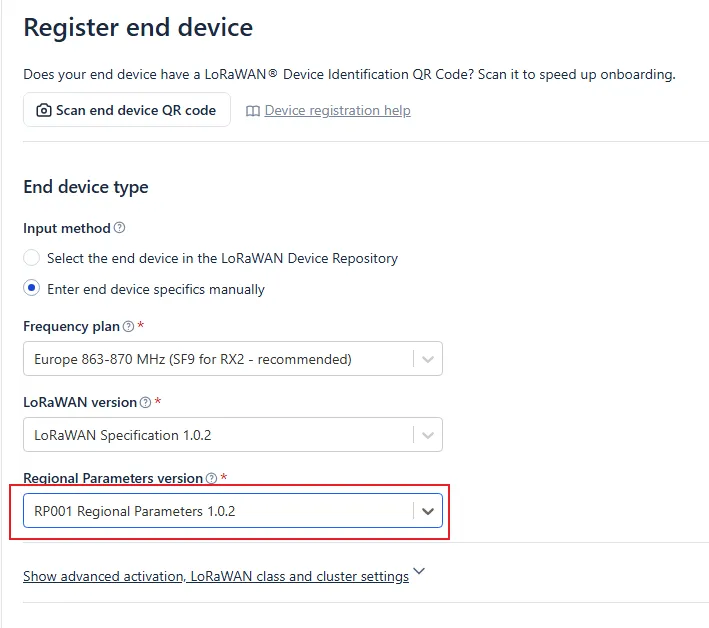

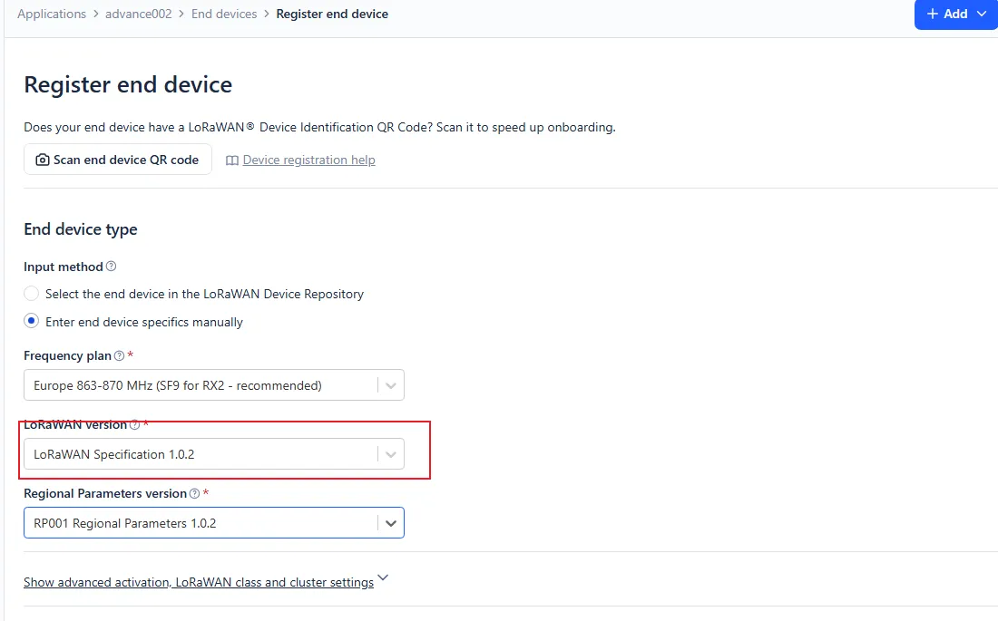

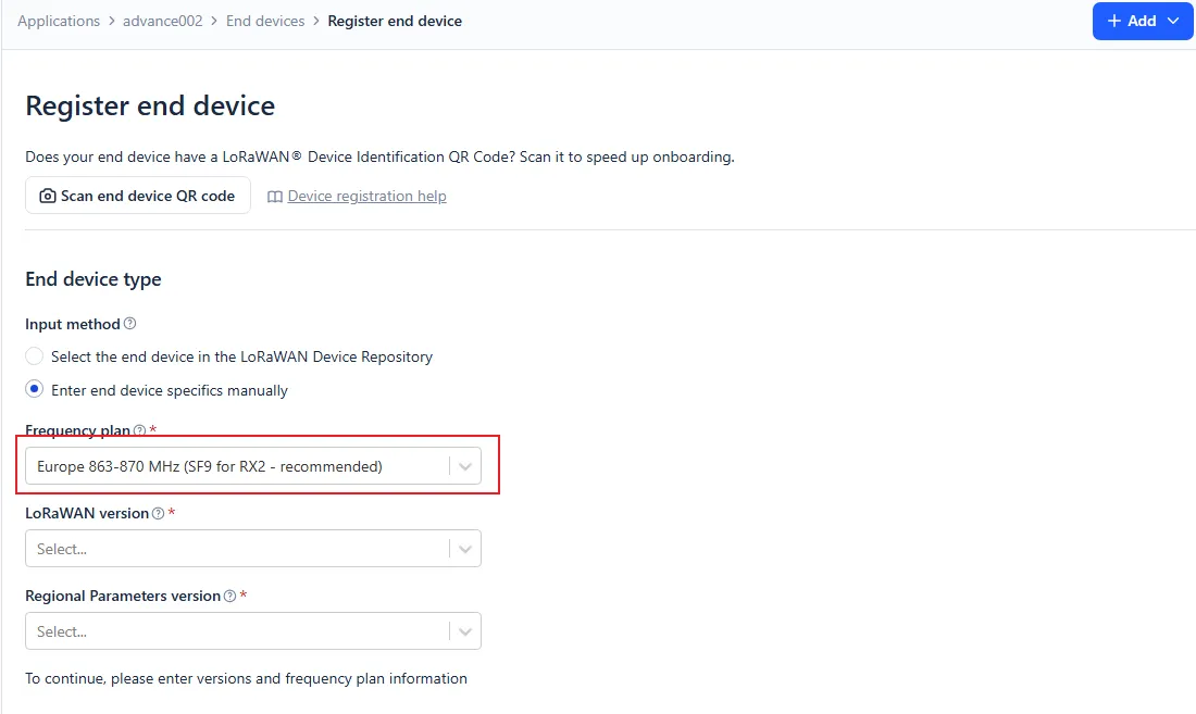

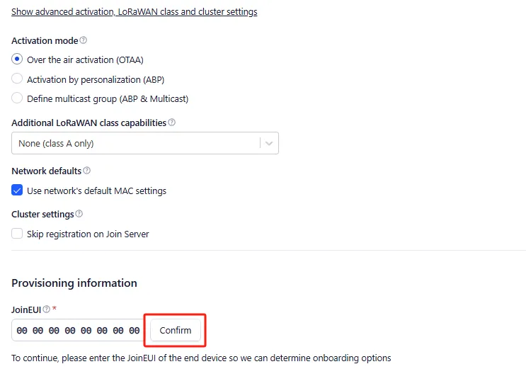

STEP5:Set the Frequency plan, LoRaWAN version, Regional Parameters version, and JoinEUI (APPEUI).
Note: JoinEUI is the same as AppEUI.
Set the Frequency plan.Note that the frequency band range should be consistent with that of the gateway you are using.
Set the LoRaWAN version.
Set the Regional Parameters version.

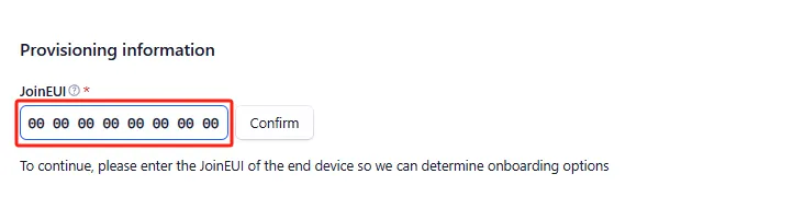

Set the JoinEUI (APPEUI).

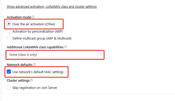

STEP6:Click "Show advanced activation, LoRaWAN class and cluster settings" to configure parameters such as the activation mode and the device operating mode.
· When the activation mode is OTAA
Configure it to OTAA mode (i.e., the default mode).
Then click "Confirm".

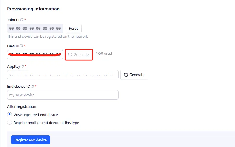

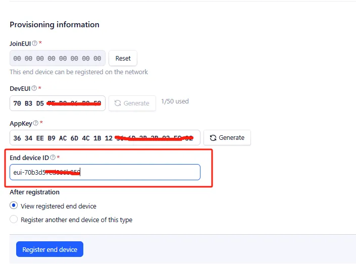

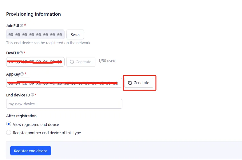

STEP7:According to the activation mode selected above, configure the corresponding device parameters as shown in the following figure:
Click "Generate" to automatically generate the DevEUI.
Click "Generate" to automatically generate the AppKey.
Enter the End device ID.
Click "Register end device".

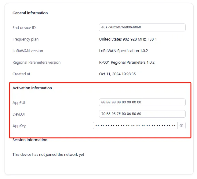

The OTAA device registration was successful.

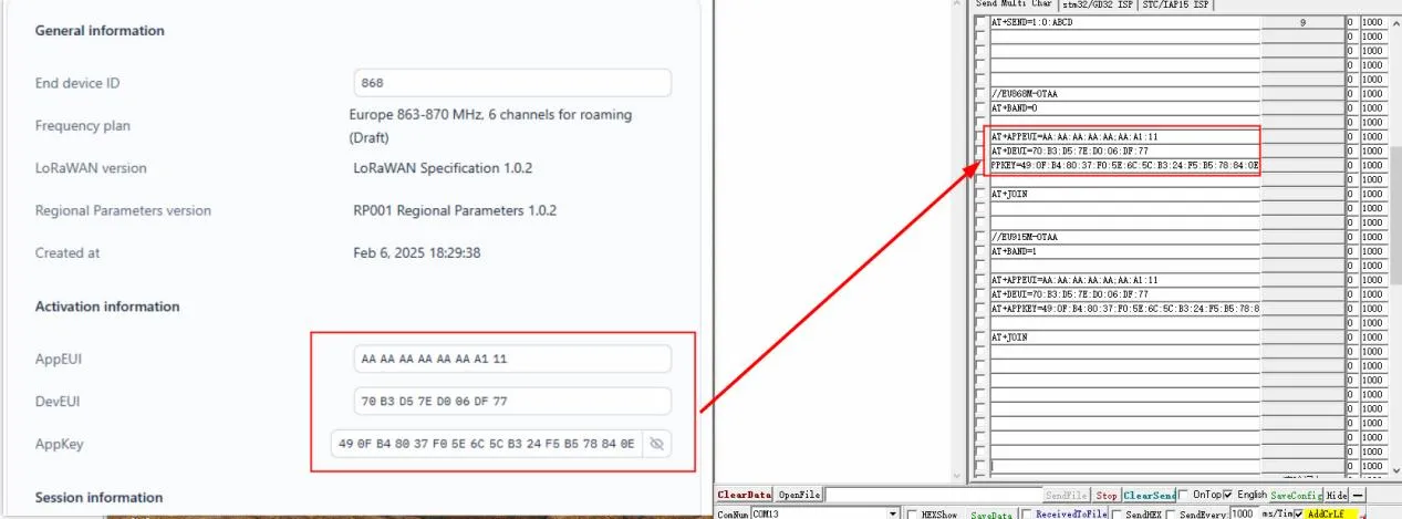

Note: Save the content in the Activation information, which will be used when sending AT commands later.

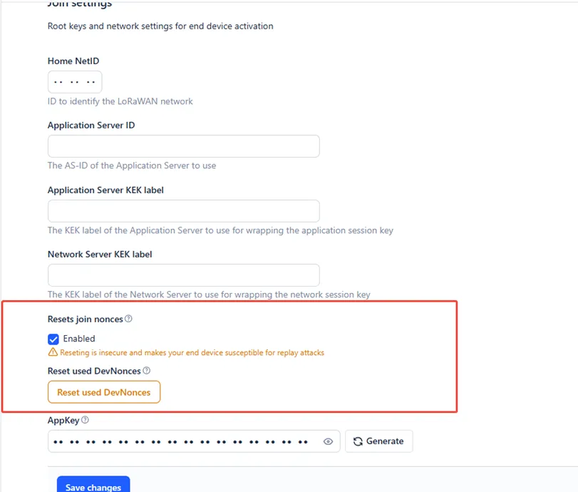

Note: Since LoRaWAN does not allow repeated use of network access, when the used DevNonce is ignored, the node can test network access indefinitely.

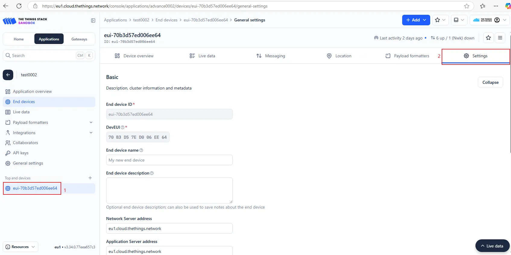

Click on Application -> Application Name
Click on node name->Settings
Pull down to the bottom of the page, Select Join Settings.
Enable "Resets join nonces"

    1.nRFLR1121 Node Board

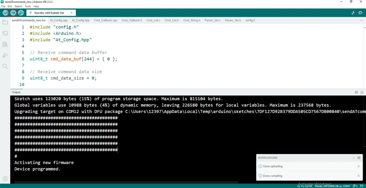

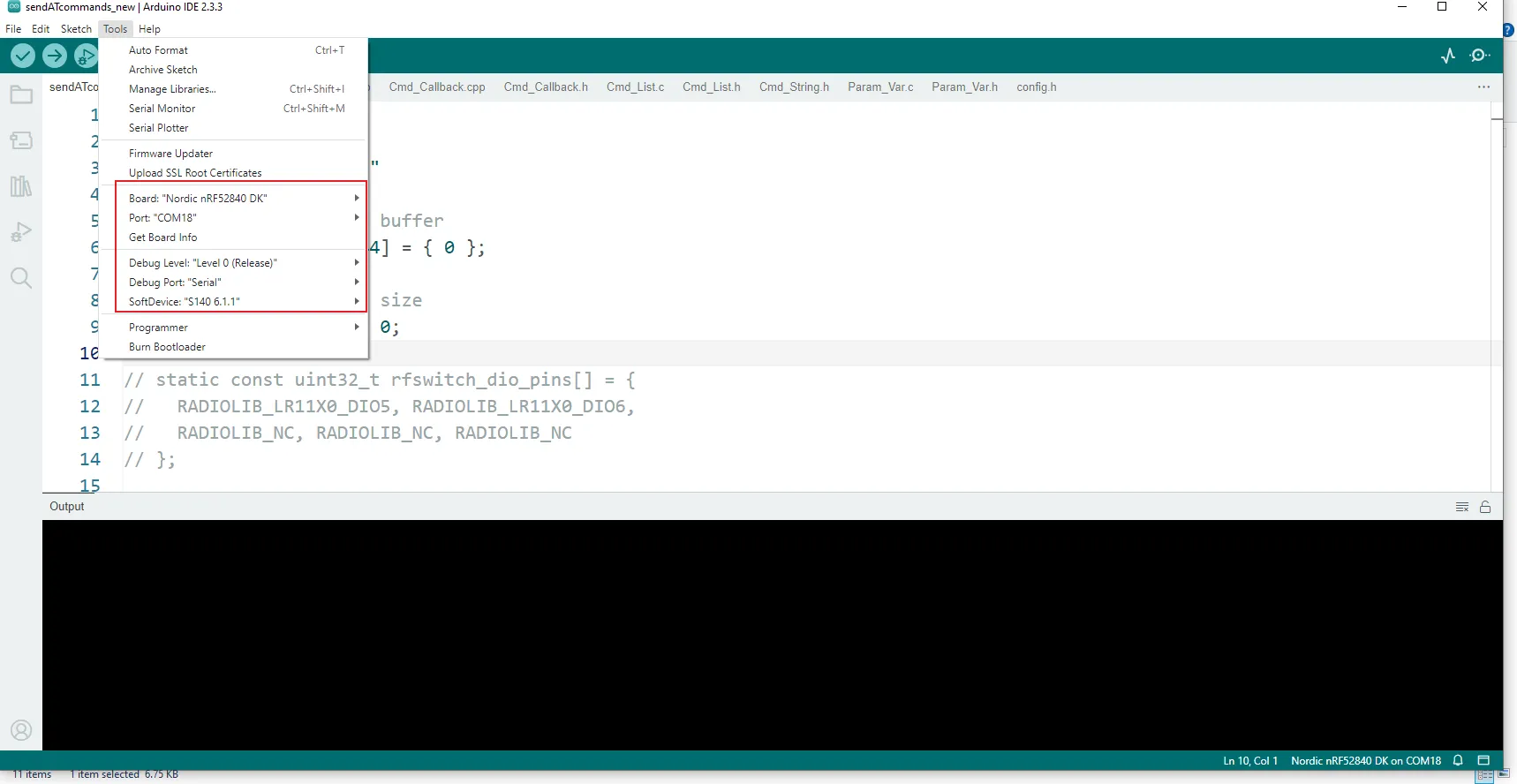

Connect the nRFLR1121 Node Board to the PC via a TYPE-C data cable. Press the "RST" button on the nRFLR1121 Node Board twice. A virtual USB drive named "TECHOBOOT" will automatically pop up on the computer.
Open the code of this lesson with Arduino and select the corresponding development board configuration.
Click "Burn" in Arduino. Wait for the burn to finish, and then the nRFLR1121 Node Board can be configured for USB-TTL communication.
Note: After the program is burned, power off the nRFLR1121 Node Board, and then power it on again!

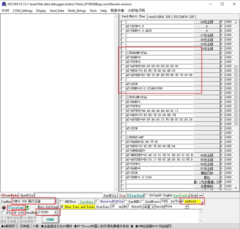

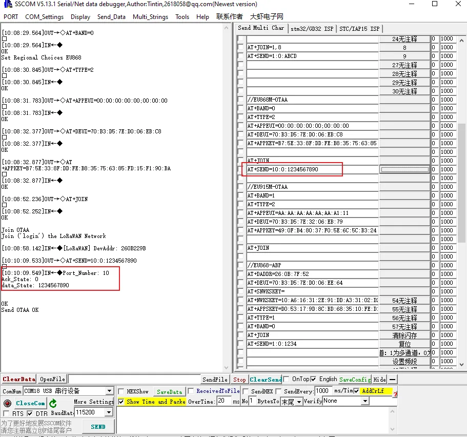

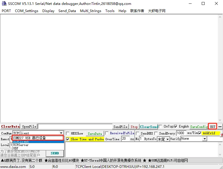

STEP1:Open the SSCOM serial port tool in the serial port assistant. Select the USB COM port recognized by the computer and click "EXT", as shown in the figure below:
STEP2:Make the following selections and input AT command information on the extended interface of the serial port assistant:
(1)Serial port Settings
  1. Baud rate:115200
  2. Check the option for adding carriage return and line feed in the serial port.
  3. Open the serial port and select "Data Terminal Ready": Click "opencom" and only check the "DTR" option.
(2)Configuration steps for the node to access the single-channel gateway (send AT commands)
  1. Set the network access frequency band of the node: AT+BAND=0. (0 represents the 868 MHz frequency band, 1 represents the 915 MHz frequency band. The node has been configured in the eight-channel mode.)
  2. Set the mode for the node to join the gateway:AT+TYPE=2(Set the network joining mode of the node to OTAA mode).
  3. Set the node's DevEui: AT+DEUI=70:B3:D5:7E:D0:06:**** (The red part corresponds to that on the TTN server).
  4. Set the node's AppEui: AT+APPEUI=AA:AA:AA:AA:AA:AA:**** (The red part corresponds to that on the TTN server).
  5. Set the node's AppKey: AT+APPKEY=49:0F:B4:80:37:F0:5E:6C:5C:B3:24:F5:B5:78:**** (The red part corresponds to that on the TTN server).
    Here, you need to replace the DevEui, AppEui, and AppKey with those in the created OTAA node application.
  6. Set the node to start joining the network: AT+JOIN. After sending this command, you need to wait for the node to join the network. Only after the node successfully joins the network can you send the next command, as shown in the following figure: After the node successfully joins the network, the information printed by the serial port tool:
    Enter the above AT commands in sequence on the extended interface of the serial port assistant. When you enter the "AT+JOIN" command, if "DevAddr" appears, it indicates that the nRFLR1121 node module has successfully joined the network!
  7. Start sending data: AT+SEND=10:0:1234567890(Parameter description: The last parameter is the data to be sent, and only an even number of data can be sent).
    The commands in the SSCOM serial port tool are as follows:

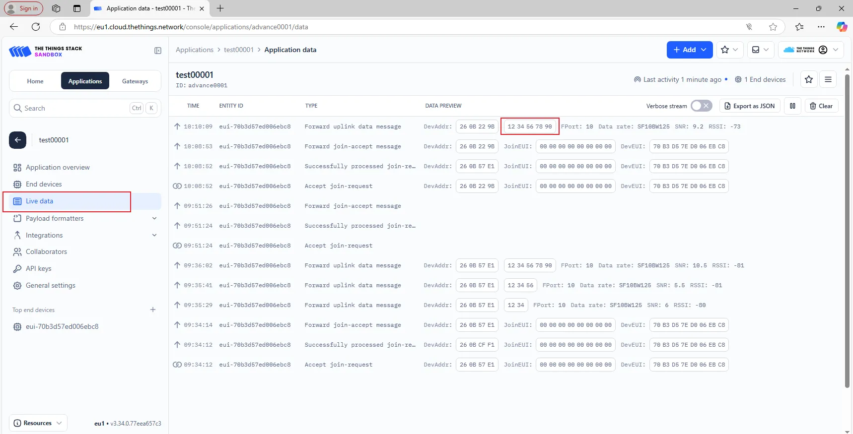

  8. After sending data using the "AT+SEND=10:0:1234567890" command, you can view the data "1234567890" sent by the node in real - time in the "Applications -> Live data" section of the TTN server background.
