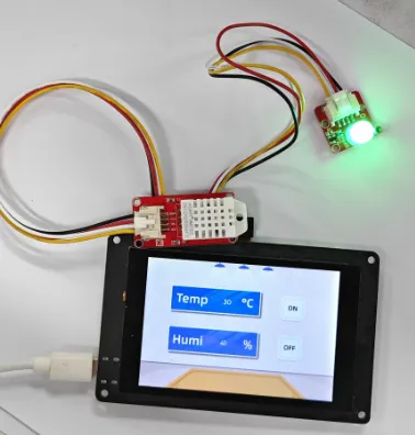

The example tutorial is an environmental monitoring project, demonstrate how to create a UI and use a Humidity&Temperature sensor to obtain the environment temperature and humidity and display it on the screen; and how to control the LED on and off by the buttons on the screen.

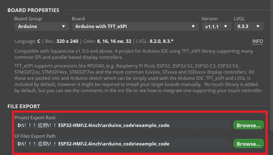

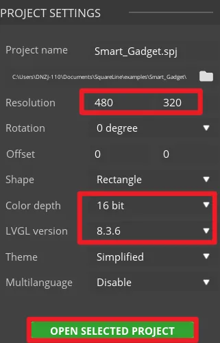

Open the SquareLine Studio and create a project. Select "Arduino"->"Arduino with TFT_eSPI".
Note:
Set the name of the project, you can select the folder to save the project. Click CREATE to create the project.

Export UI files.
Then click "APPLY CHANGES".

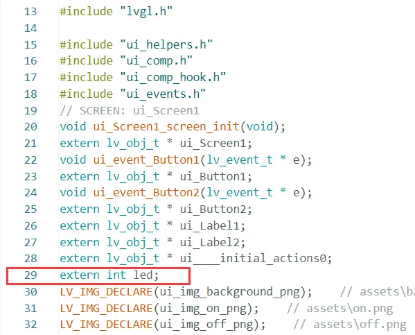

Modify the button event code.
First, define an extern variable in the ui.h file to store the status of the LED. In the main program, the LED light is controlled to turn on and off by judging the status of this variable.
- When button 1 (ON button) is pressed, set the LED value to 1.
- When button 2 (OFF button) is pressed, set the LED value to 0.

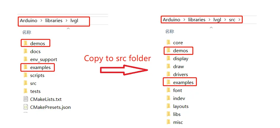

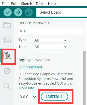

- If you install the lvgl libraries by Library Manager, you need to copy the demos folder and examples folder and paste them to src folder. And modify the lv_conf_template.h file and rename it to lv_conf.h, and place it in libraries folder.(Please refer to the library provided)

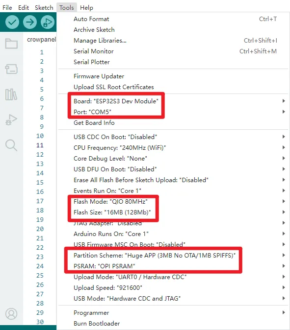

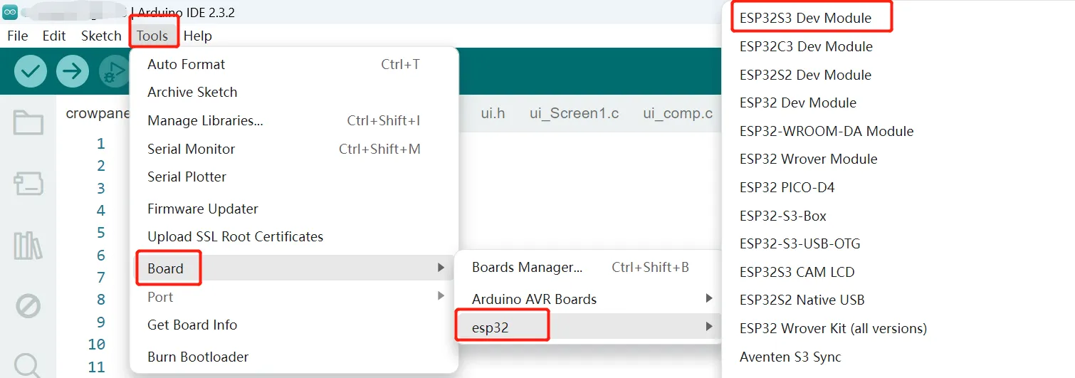

After completing the installation of the ESP32 board according to "Get Started with Arduino IDE" and the installation of the library according to "Install Libraries", open the program and connect the ESP32 Terminal to the computer via a USB-C cable.
Select Board: click "Tools" -> "Board" -> "esp32" and select "ESP32S3 Dev Module"
Setting: Click "Tool", select "16MB" as the flash size, select "Huge APP..." as the partition scheme, and select the "OPI PSRAM" as the PSRAM.
Select Port
Select the serial port corresponding to the ESP32 terminal board.

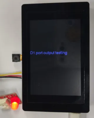

After the program is successfully uploaded, connect the sensor to the D2 Port(IO40) port and the LED to D1 Port(IO11), the temperature and humidity values will be displayed on the screen. Click the ON button on the screen and the LED will turn on. Click the OFF button and the LED will turn off.

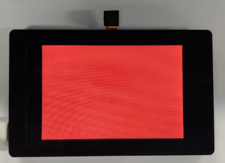

Example 1: Switch color screen¶
Open and upload the A-LCD.ino
The screen will display different colors

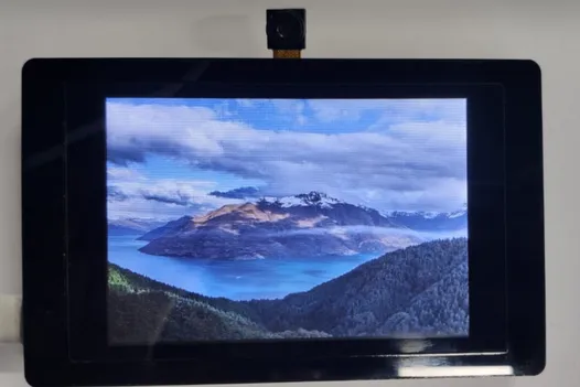

Example 2: Display the pictures from TF card¶
- Insert the TF card in to card slot
- Open and upload the A-TF-PIC.ino
- The pictures will show on the screen

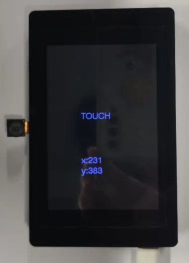

Example 3: Touch initialization¶
Open and upload the A-TOUCH.ino
The XY coordinates of the touch will be displayed when touching different positions

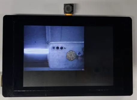

Example 4: Camera initialization¶
Open and upload the A-Camera.ino
The camera will open

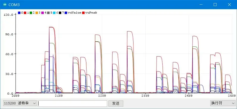

Example 8: Microphone initialization¶
Upload the A_AUDIO.ino
The serial monitor will display the sound waveform
