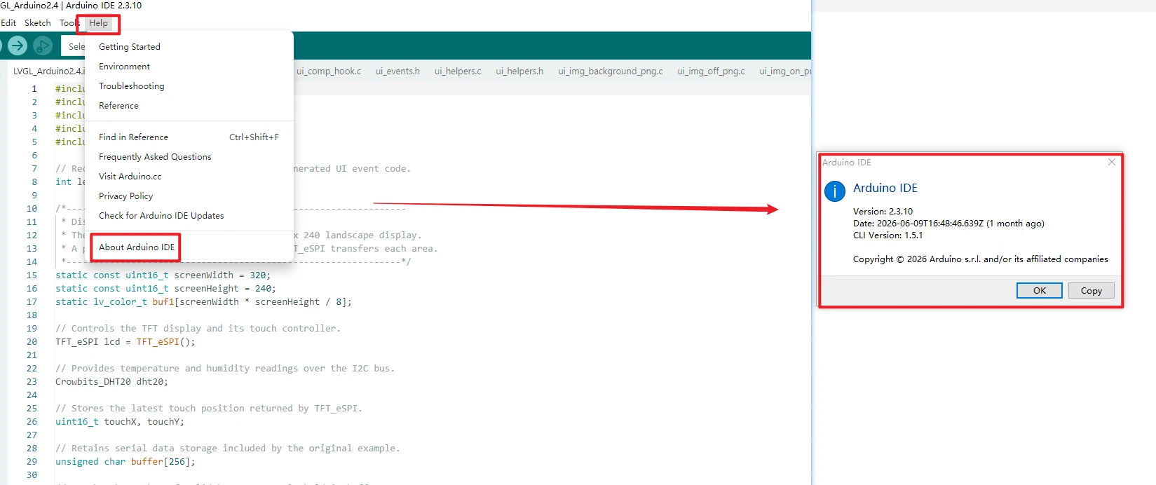

3.1 Confirm the Arduino IDE Version
Launch the Arduino IDE and open Help > About Arduino IDE to confirm you are using Arduino IDE 2.x. The version number shown in the screenshots is for demonstration only and does not need to match the screenshots exactly.
Software installation: Download_Arduino_IDE - Elecrow Wiki
Confirm the version in "About Arduino IDE"
