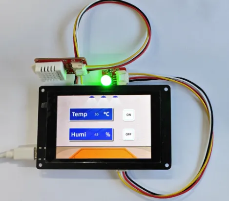

The example tutorial is an environmental monitoring project, demonstrate how to create a UI and use a Humidity&Temperature sensor to obtain the environment temperature and humidity and display it on the screen; and how to control the LED on and off by the buttons on the screen.

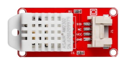

ESP32 Terminal RGB Crowtail-AM2302 Crowtail-LED
CrowPanel-ESP32-Content-T-RGB1 AM2302 CROWTAIL-LED
BUYNOW BUYNOW BUYNOW

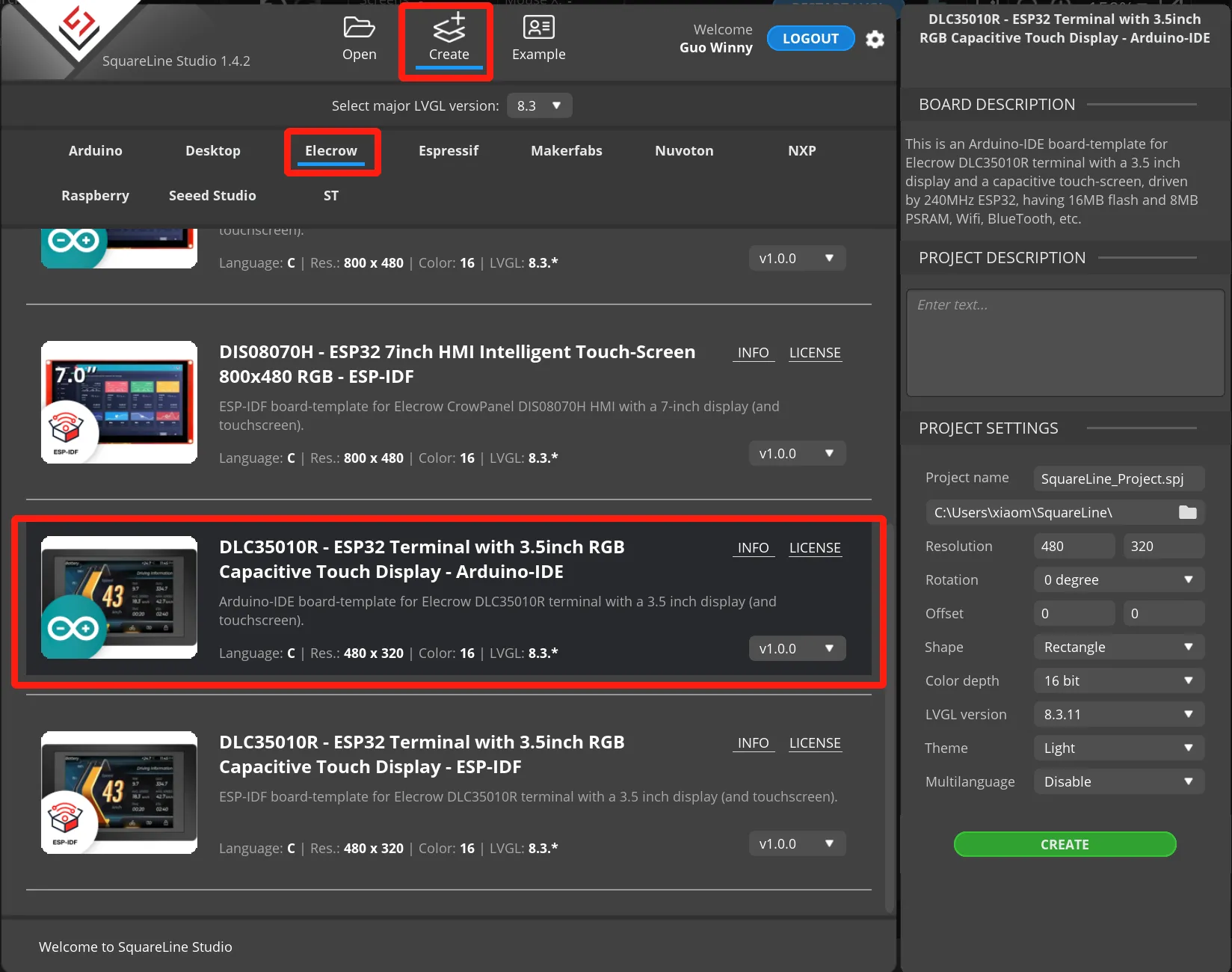

  1. Open the SquareLine Studio and create a project. Select "Elecrow"->"DLC35010R - ESP32 Terminal...-Arduino-IDE".

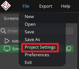

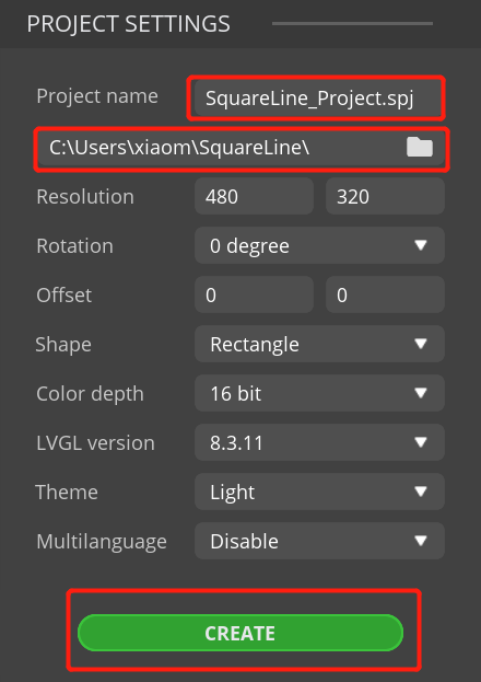

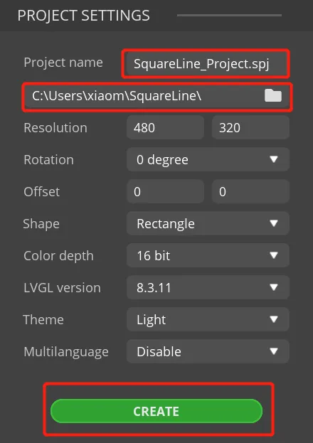

  2. Set the name of the project, set the screen resolution to 480*320, set the color depth to 16bit, and keep other default settings. After setting, click CREATE to create the project.
    SLS-UI-2

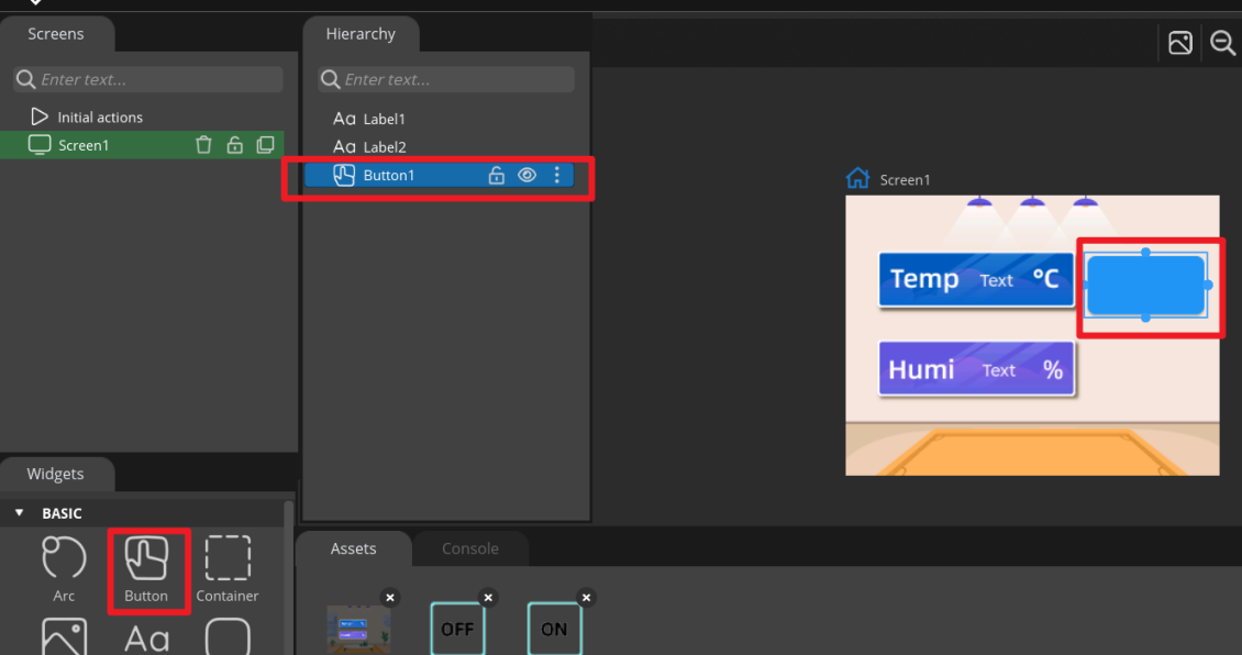

  7. Add Button widget to control the LED.
    SLS-UI-12
    SLS-UI-13
    SLS-UI-14
    SLS-UI-15
    SLS-UI-16
    SLS-UI-17
    SLS-UI-19
    SLS-UI-20

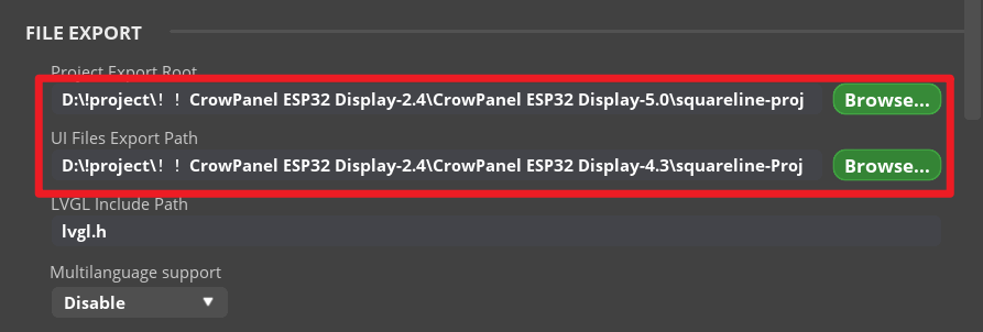

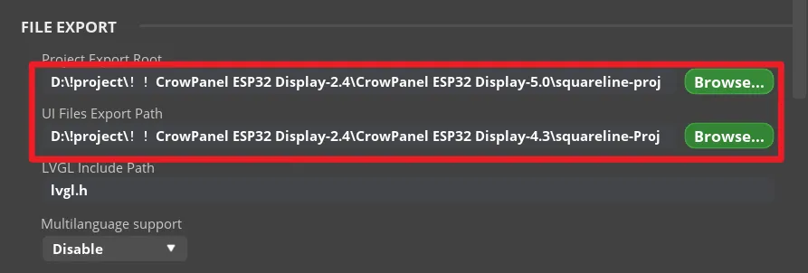

  9. Export UI files.
    SLS-UI-25
    SLS-UI-26
    Then click "APPLY CHANGES".
    SLS-UI-27

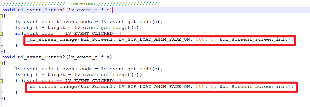

  10. Modify the button event code.

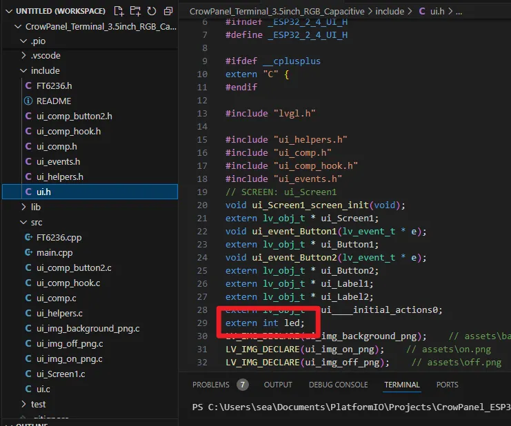

    First, define a extern int led; in the ui.h file to store the status of the LED. The value of this variable is judged to control the on and off of the LED.
    SLS-UI-30
    SLS-UI-31
    • When button 1 (ON button) is pressed, set the LED value to 1.
      ![SLS-UI-32](./assets/images/CrowPanel_ESP32_Terminal_RGB_with_PlatformIO/SLS-UI-32.webp)
    • When button 2 (OFF button) is pressed, set the LED value to 0.
      ![SLS-UI-33](./assets/images/CrowPanel_ESP32_Terminal_RGB_with_PlatformIO/SLS-UI-33.webp)

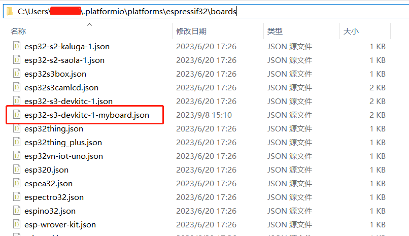

  1. Place the esp32-s3-devkitc-1-myboard.json to the directory in the following picture:
    PIO-1
    Please click download to download the esp32-s3-devkitc-1-myboard.json.

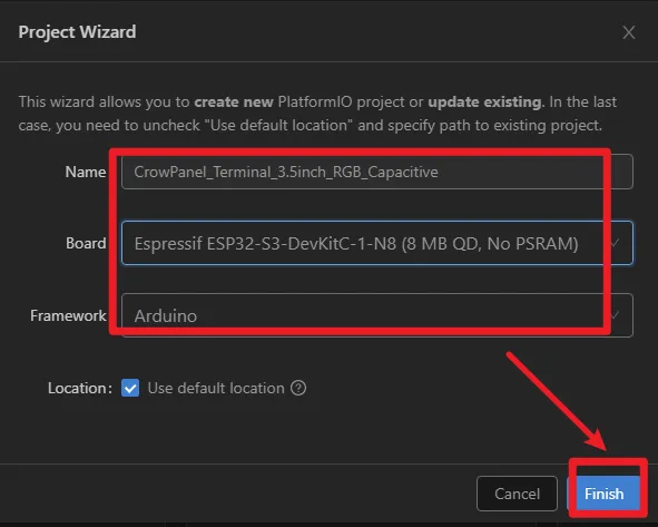

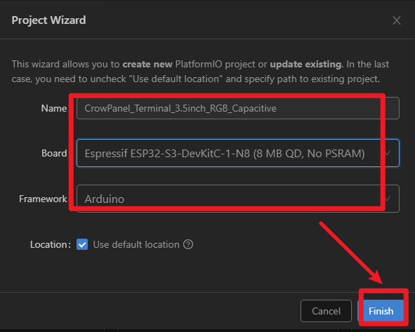

  3. Add a project name "CrowPanel_Terminal_3.5inch_RGB". Select "Espressif ESP32-S3-DevKitC-1-N8 (8 MB QD, NO PSRAM)" for the board and "Arduino" for the framework.
    PIO-3

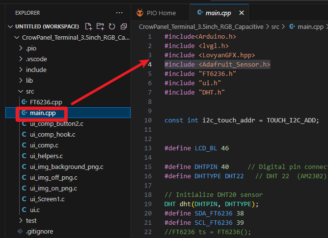

  4. Write the main program in main.cpp.
    PIO-5

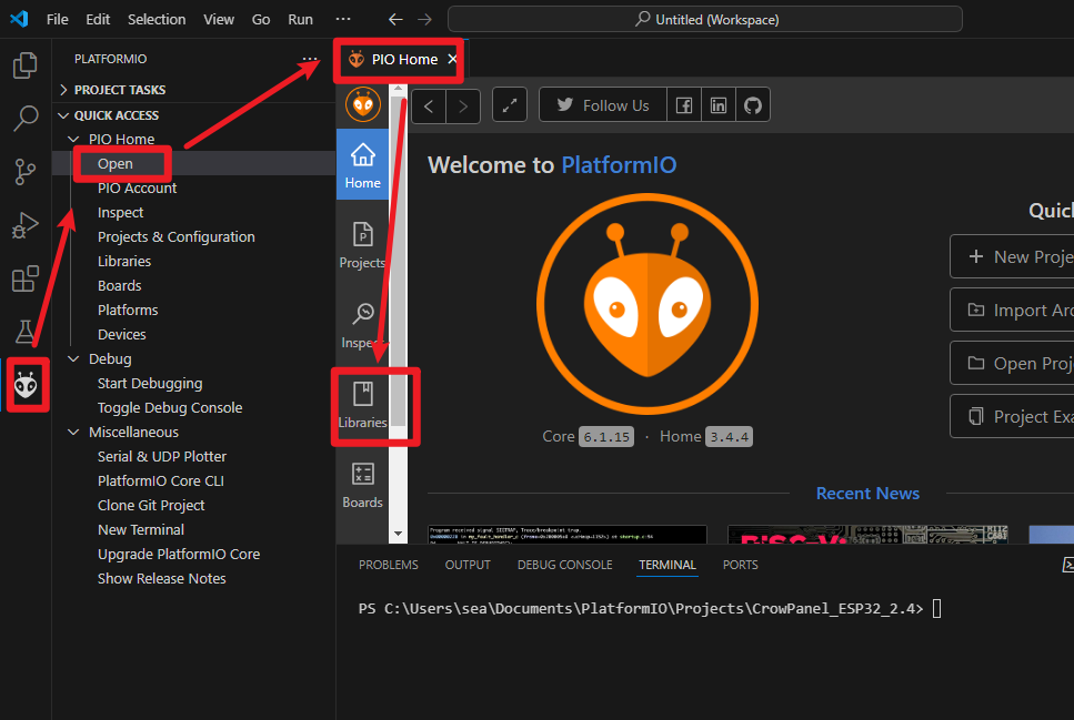

  1. Click the PlatformIO icon, click QUIK ACCESS 'Open', then click 'Libraries'.
    PIO-6

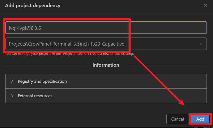

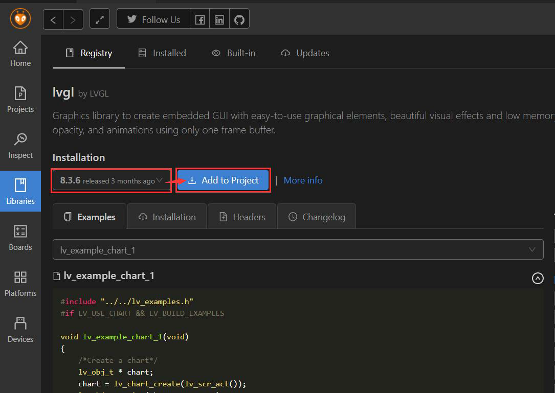

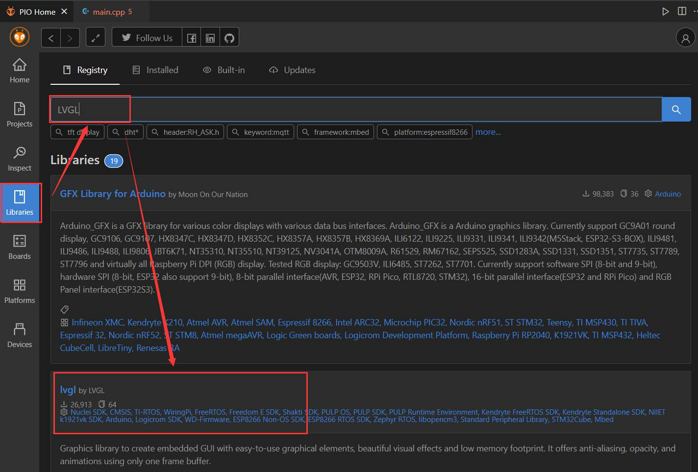

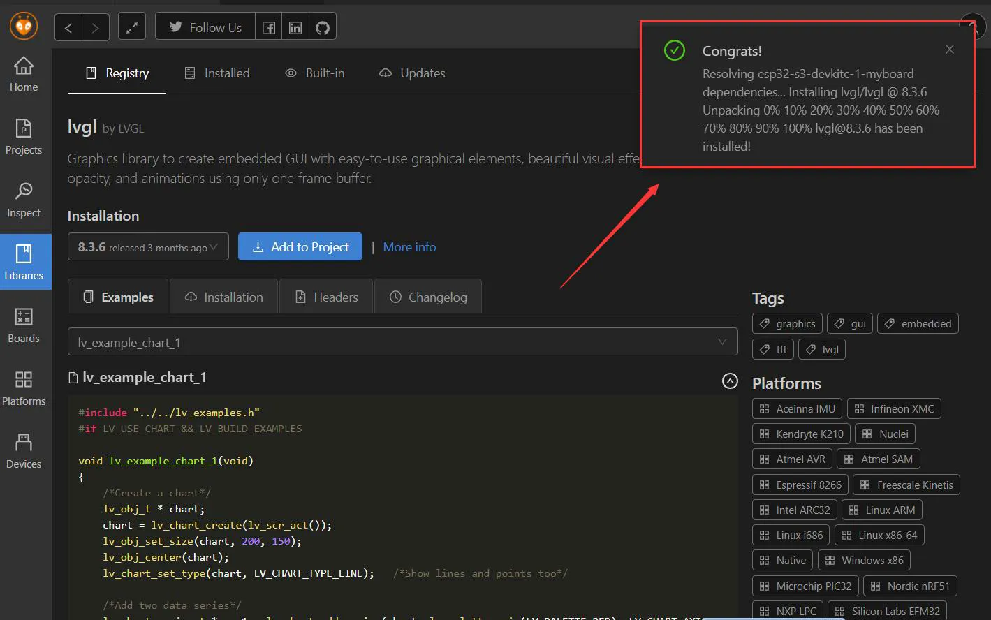

  2. Search for LVGL, and add it to the project.
    PIO-7
    PIO-8
    PIO-9
    PIO-10

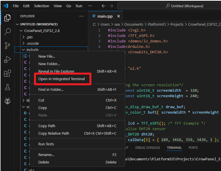

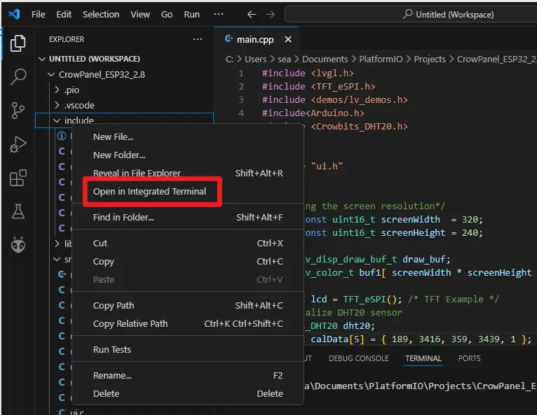

    After adding, right click on lvgl and select "Open in Integrated Terminal"
    PIO-17

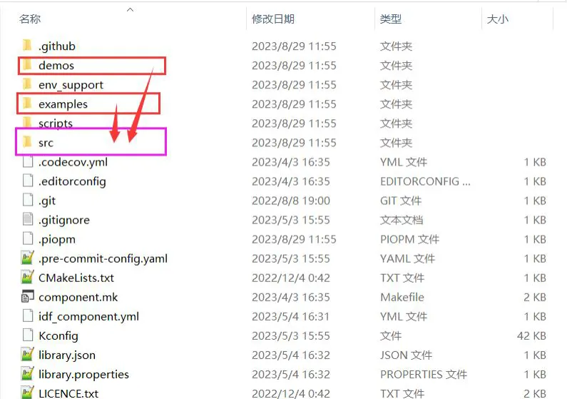

    Copy the "demos" and "examples" folders to "src" folder
    PIO-18

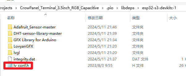

    Place the lv_conf.h we provide to the path: .pio\libdeps\esp32-s3-devkitc-1 in the project folder.
    PIO-19
    Please click download to download the lv_conf.h file.

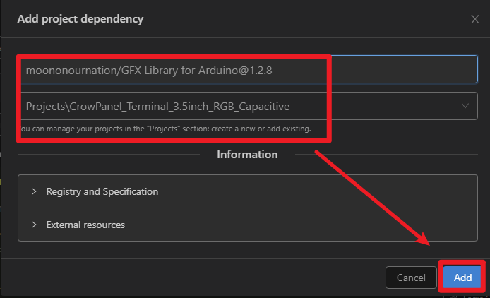

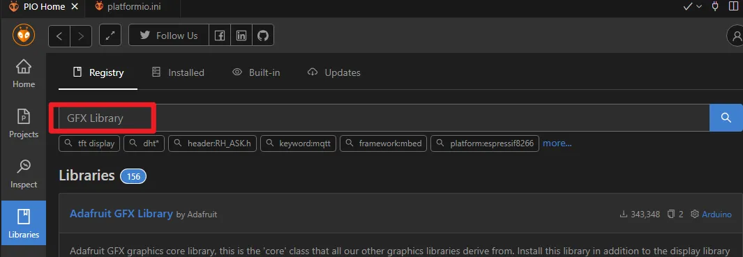

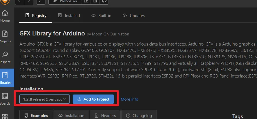

  3. Add GFX_Library library.
    PIO-11
    PIO-12
    PIO-13

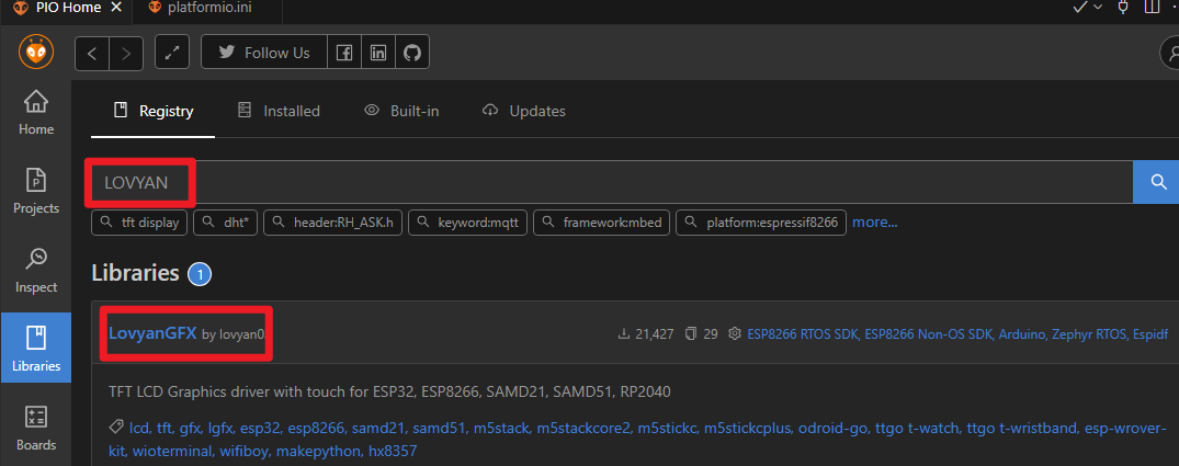

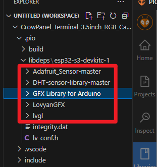

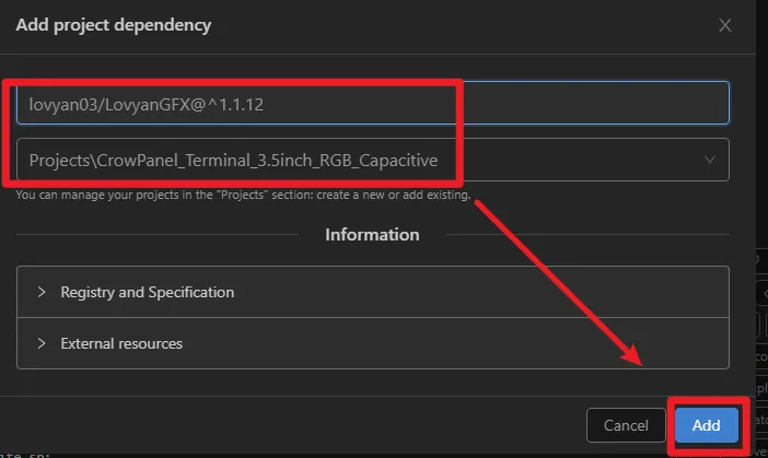

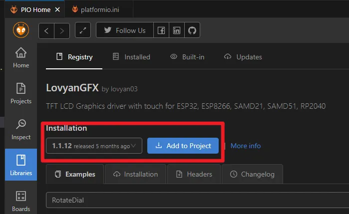

  4. Add LovyanGFX library
    PIO-14
    PIO-15
    PIO-16

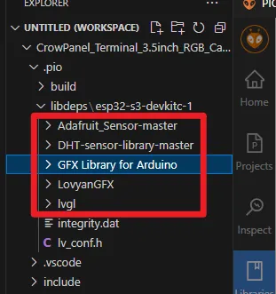

    We can see that the library has been added successfully!

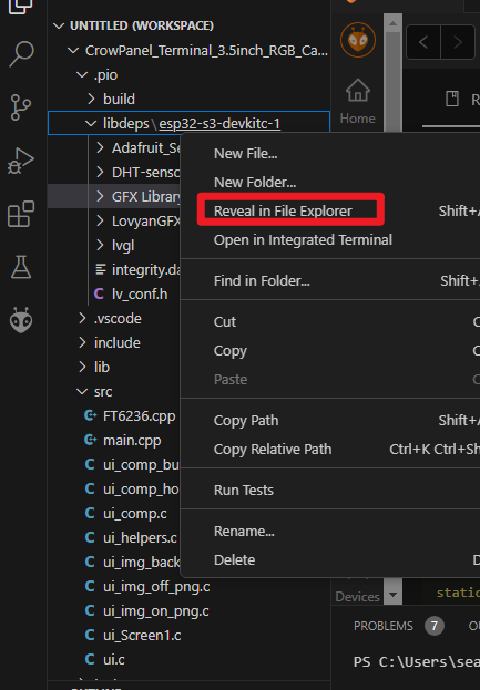

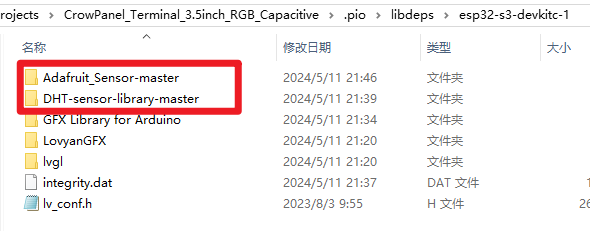

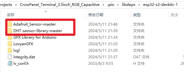

  5. Add libraries for sensor.
    Right-click the "libdeps\esp32-s3-devkitc-1", click "Reveal in File Explorer", and select the sensor libraries we provided.
    sensor-lib
    Please click download to download the sensor libraries.

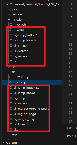

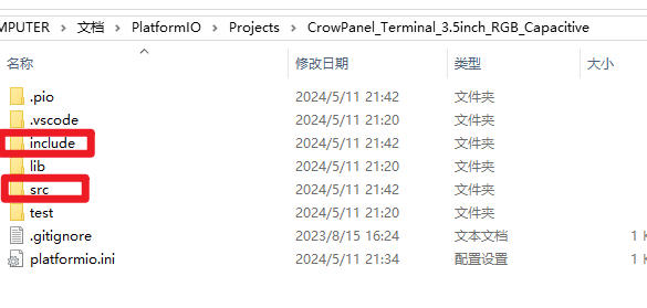

Add the UI file into PlatformIO Project
We need to add the UI file (generated from SquareLine Studio) to the PlatformIO project.
The .c files in the UI file should be placed in the /scr folde**r of the project file, and the **.h files should be placed in the /include folder.
PIO-34
PIO-35

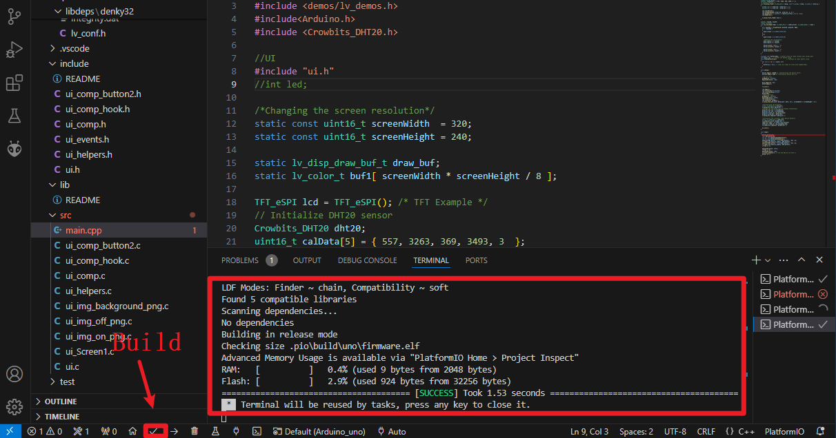

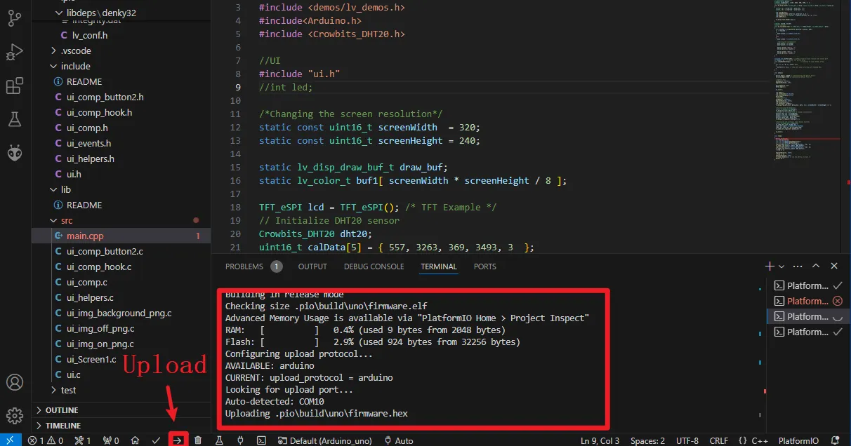

  1. Compile the program.
    Upload-code-1

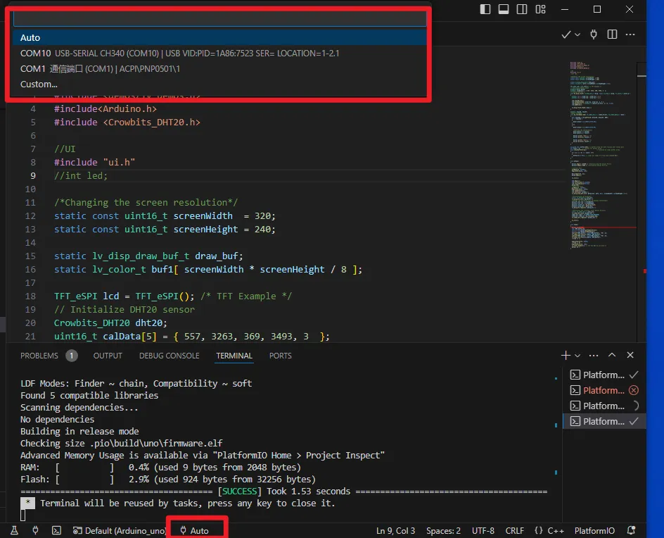

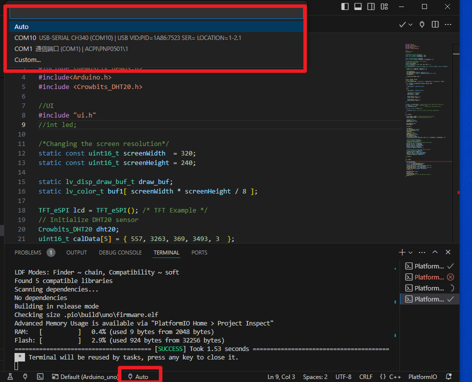

  2. Select the serial port and upload the code.
    Here we select Auto. The software will automatically select the corresponding serial port for program download. If the automatically selected serial port is incorrect, you can manually select the correct serial port.
    Upload-code-2
  3. Click the upload button to up the program to the board.
    Upload-code-3
  4. The program will run on the board!
    RGB_DEMO
